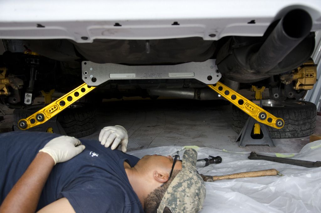

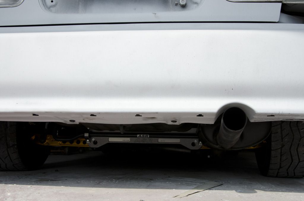

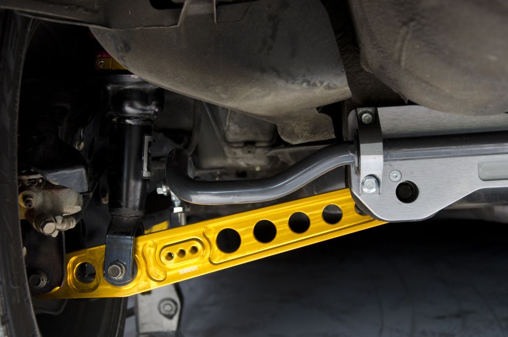

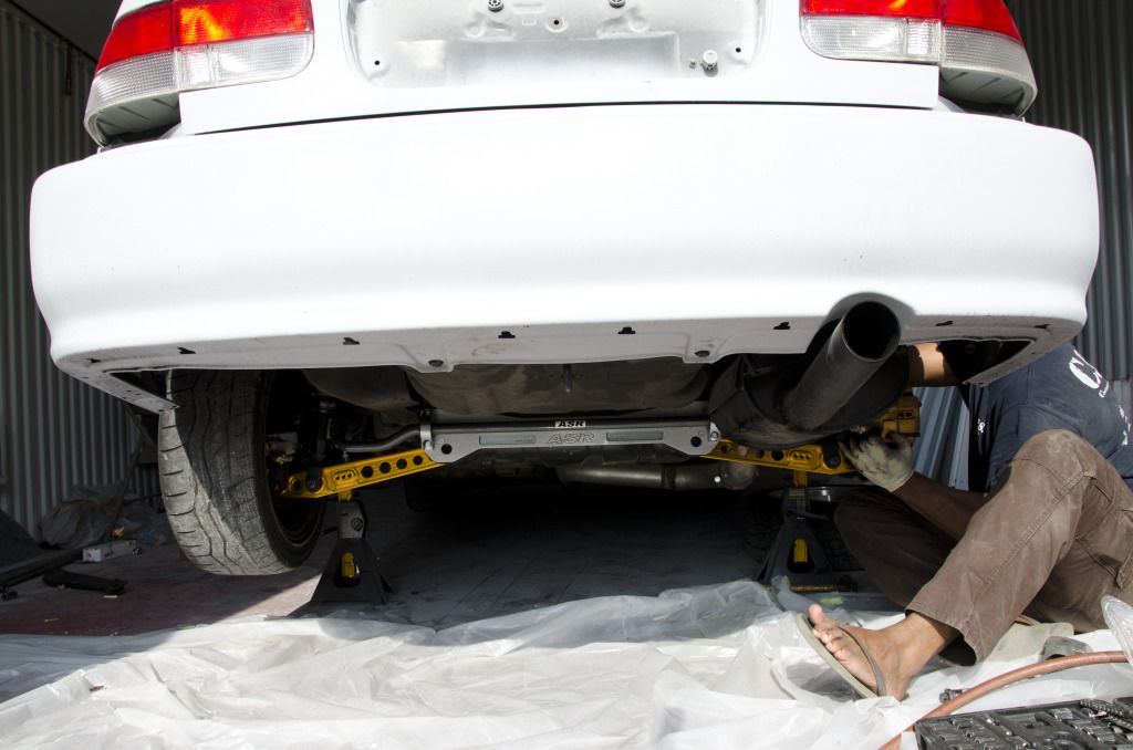

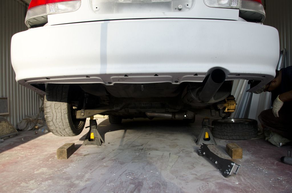

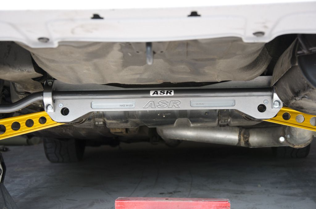

    Ok today have a little update for everyone. Got the ASR sub frame brace, ASR sway bar and rear lower control arms in. Everything was running pretty smoothly until I crawled underneath the front of the car and discovered that my down pipe was cracked almost all the way around it. So the H brace, radiator, radiator fan, fan switch and alignment is going to have to wait until I can get the down pipe fixed. I was however able to get a lot of negative camber out of the back with my lower control arms and the good ole washer trick!! Anyway here is some pics, keep the comments coming.
    The carnage!!!
