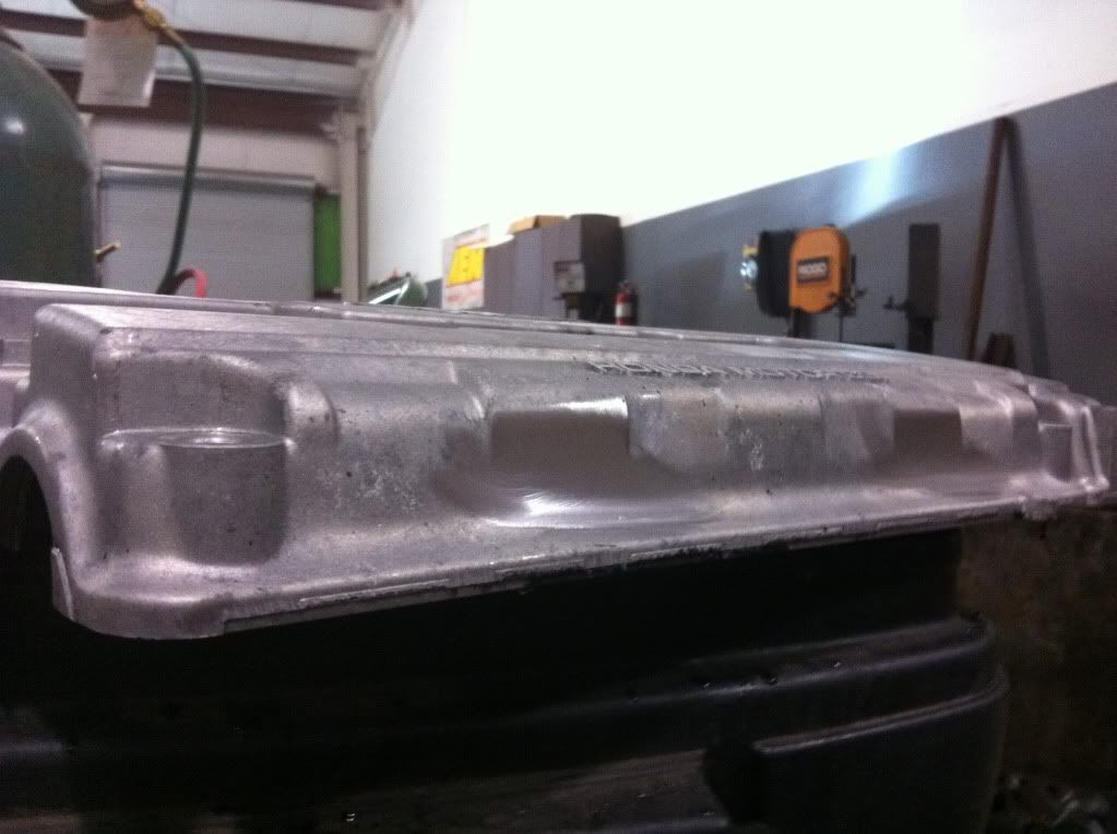

    Valve cover stripped and prepped for some welding:
