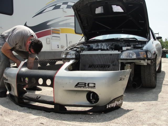

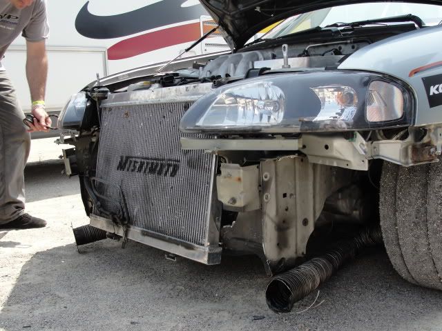

    Here are a couple shots from the event. You can see how far forward we moved the radiator to prevent stalling bw the back of the core and the header.
