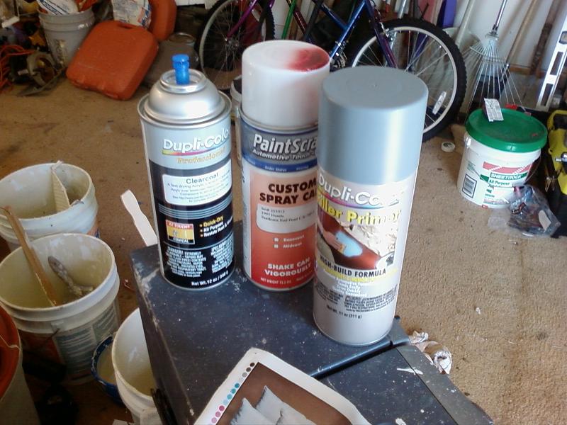

Paint was purchased from paintscratch.com. I got the match to the car, plus the clear and filler primer and a tack rag.

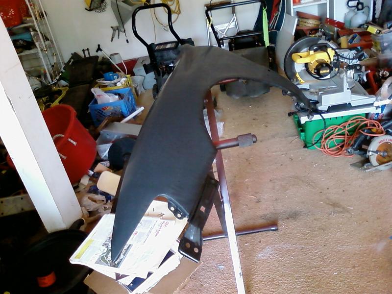

I took the fender off the car
I sanded the fender down w/ 320 grit then hit it with some filler primer
After a few coats of primer, i started w/ the color. Hit it with about 3 coats. This was done right at the begining of the super hawt august so my garage didnt have too much humidity in it. After the color dried, i sanded it w/ 1000 grit and tacked it down. After 4 coats of clear were sprayed I sanded the panel down with 1000, 1500, and 2000 respectivley

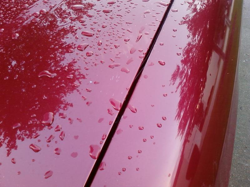

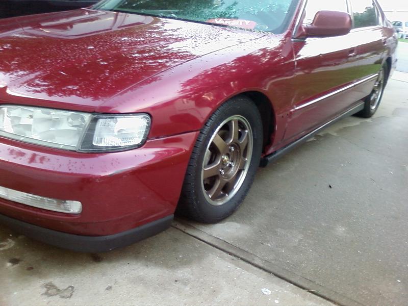

After sanding, I hit it with some fine cut polish, then a high gloss polish. These are the end results. I havent lined it up because im doing the bumper next weekend.
On the left is the hood, still factory paint the small white scratches are infact polish. on the right is the fender, sprayed by me. Not pictured: On the driver door, you can tell it was painted because the fender matches the rest of the car when you stand back from it...
