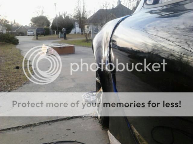

    Rolling the fenders so I could fit my new wheels
    Wheels/specs : WedsSport SA70 17x9+20 18x10+18
    Fitment pictures for the fitment whores.
    Front fitment was just ok.
    I was pretty happy with the rear fitment.

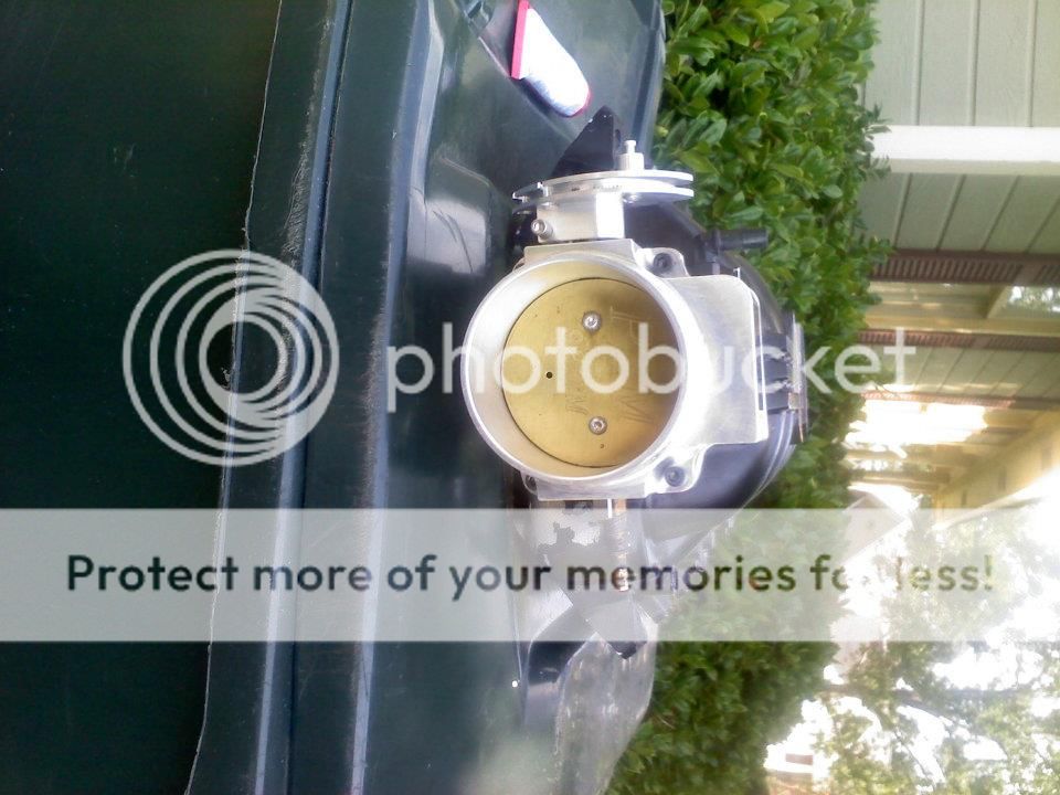

    Throttle Body: PTM 92mm
    I had to get a custom adapter made as well for the throttle body to work. The throttle body was 4 bolt, and the intake was 3. so i took it to a local machine shop, and had a .5" spacer/adapter made.
    And a pic with the throttle body on.

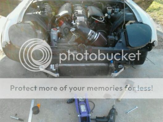

    Engine Bay pic: (messy, its still a work in progress)

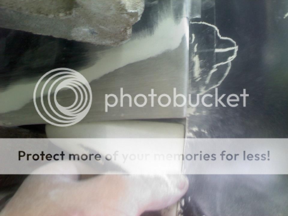

    The first thing I bought was this origin style rear bumper, i figured i'm going to cut it up anyways, so no point in buying the real thing.
    Then I traded a re-amemiya style rear diffuser I had for a set of 50mm origin over fenders. The bumper, and over fenders didnt clear each other, like I suspected, so the cutting began.
    First cut.
    I dont really have pictures of what I did of the bumper, but i cut the piece of the over fender that drops down straight with the line of the bumper, and then molded the piece of the over fender into the bumper. On a side note, I got rid of my Hi power and Cut and welded the tip of an Isis 4" blast pipe on it to help fill the giant hole for the exhaust that was cut by the PO. still Have to go back, and glass part of what he cut.
    near finished product

    Also got bored, so I played with my fitment for the new tires

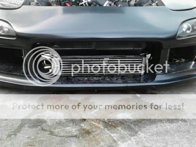

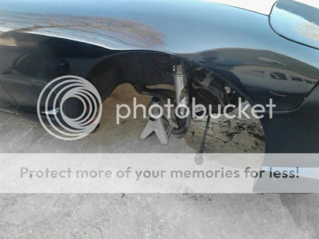

    picked up my new to me oil cooler, still have to figure out where/how i want to mount it.

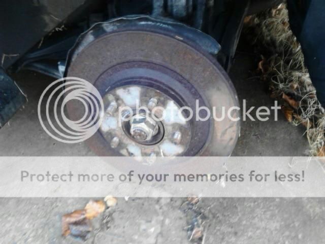

    also put my new knuckles on.
    before:
    knuckles off...
    i'll post an after pic tomorrow. still need to get tie rod ends at least though. still better than stock...
    basically waiting to get my brakes back before i can do much else to it right now, so i havnt really messed with it a ton. i may make a bash bar soon, but for the most part, i'm at a stand still.
    pic of the new knuckles on as promised. still want to get tie rod ends and spacers. but this will do for now.
