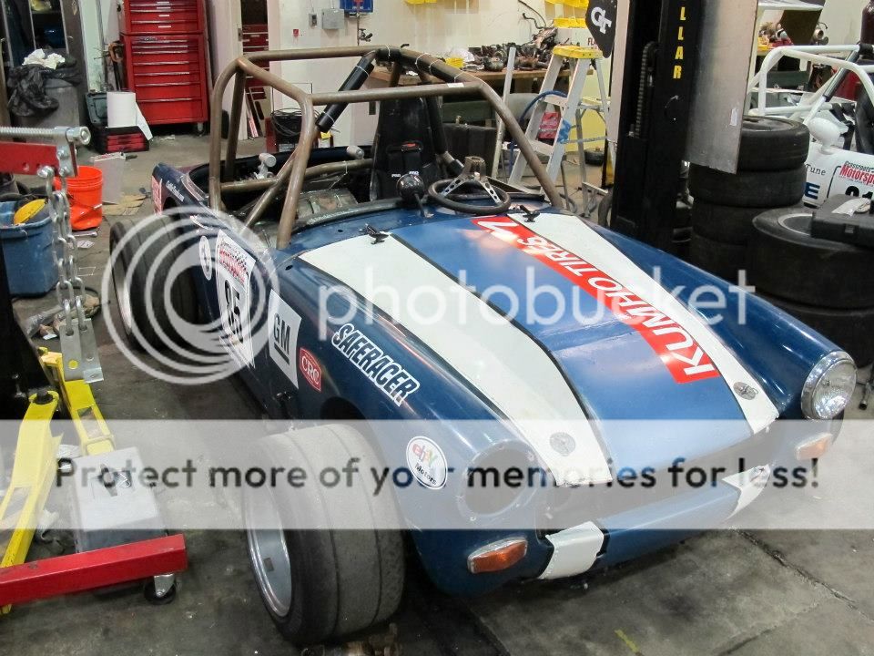

    Sorry to thread-jack, but once you get to GT, you should check out Wreck Racing. We'd love to have you.
    We are a budget racing team run by students ("RandomGuy" and I are both members). Our current comp car is a turbo 2JZ MG Midget:
    Anyway, sounds like you have a cool project on your hands! Good luck
