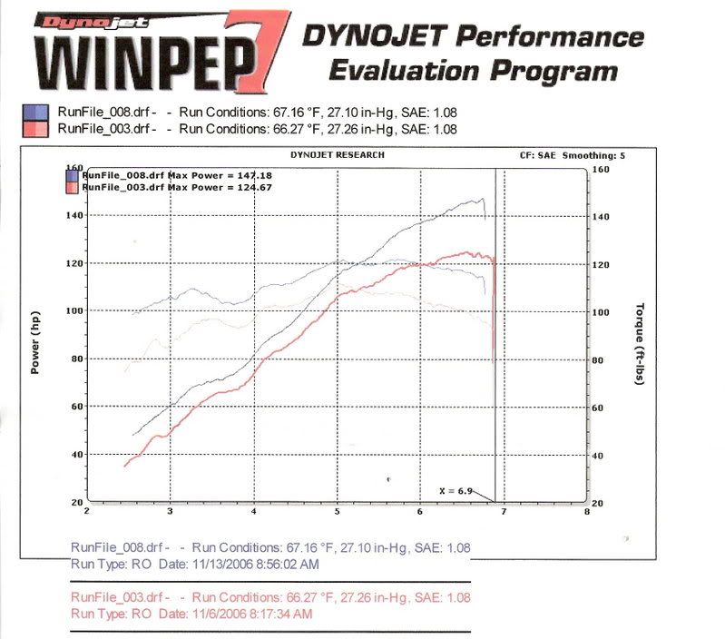

    ok here is my dyno sheet i know the numbers are not to be oooo and ahhhh'ed about but i was happy wit my gains that i have made. Ok first the red was my run wit this set up:
    B18a head
    Skunk 2 cam gears
    3 agle valve job
    crower 404's
    Crower valve springs/retainers
    Rc 310cc injectors
    B&M Fpr
    walbro 255lph Fuel pump
    b18a block
    ITR oil/water pump
    .25 over Ctr pistons
    Acl bearings
    new oem crankshaft
    Ls rods
    B16 j1 tranny
    XTD stage III clutch(very under-rated)
    dyno tuned wit a vafc
    stock exhaust mani, Tb, IM
    And in blue is the same setup jus added my header, muffler, and 2.25 piping and gained 23 more horsepower to the wheels. so i cant wait till i port and polish the head and add my blox IM and my maxbore TB. So im happy so far.

    decent numbers, give the Non vtec crowd some hope

    tryin but i have seen better numbers with this setup but they had there ecu chipped wit chrome which i will be doin in about a week or so then i will post that one up

    That's very low power.. Something must not be right man. I have a bone stock LS motor that made 131whp.. Seems like something is out of time or low compression.
    Do a leak down and a compression test.
    BK ALL DAY
    5,168
    skinny am with u on this one... ej_allmota has a ls that makes 154whp and 118ft lbs with a 403's, pr3 pistons and a cast ctr header no head work at all....

    My LS bone stock w/ps&ac. made a 120whp. Was the dyno calibrated right or was the motor healthy

    if so u had a healthy one... some one is gonna ask for a dyno graph on it, i have a feeling... but that guy motor aint right, if anything he should make more power than ej_allmota.... just cause of the ctr pistons, valve job and fuel pump...

    My setup:
    B18B motor
    Blox Intake Manifold
    Hondata Intake manifold gasket
    stock TB
    Passoword JDM intake
    Stock head (no port work or valve job)
    Crower 403s with dual valve springs and Ti retainers
    B16 pistons
    I put down (peep my sig) put those numbers down in the middle of the summer it was somewhere around 92-98 degrees that day..
    But hey you said your only tuned with VAFC.. Get Crome or Hondata in ya life and see wat it do.. Decent numbers i guess..

    yea something wrongs with it dude
