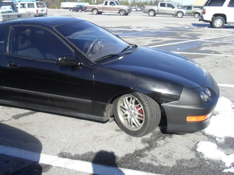

    /\this is just ridiculous /\all though i have been loving the ride hight after being like this \/
