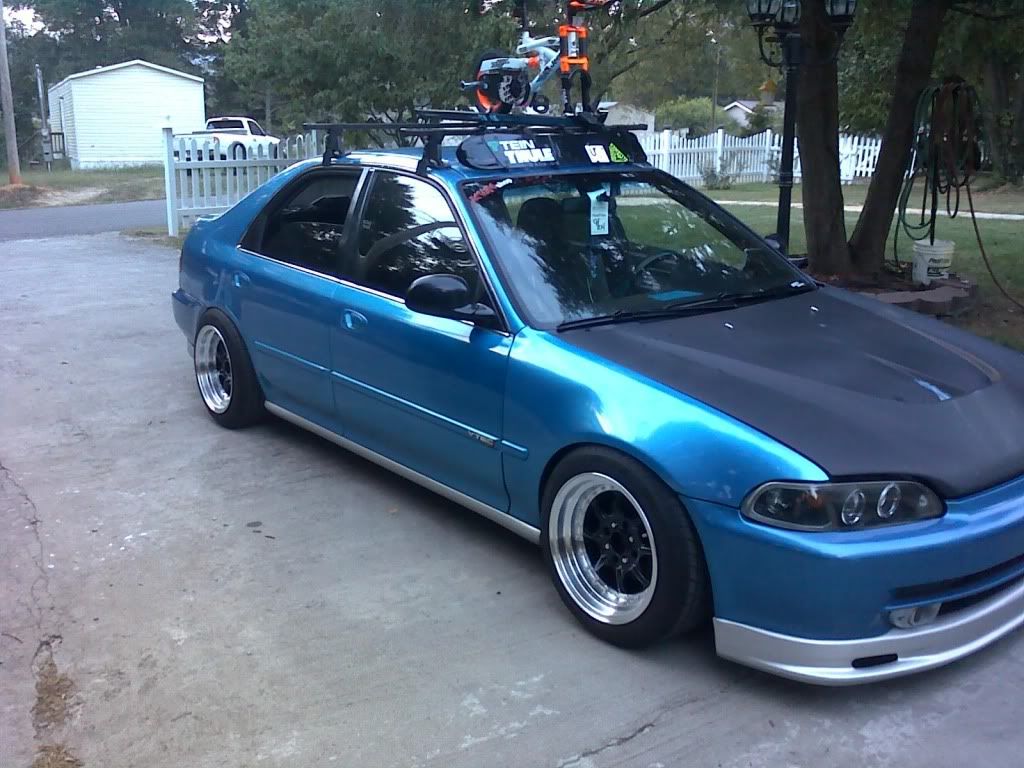

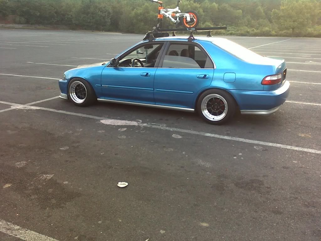

    So here it is- it is sitting a little lower than the pics show, about 2-1/2 coils lower (coilovers sleeves that is) & finished rolling/pulling my front/rear fenders (I'm still going to get a camber kit) but for now it's not rubbing at all on OEM camber.
    16x8, +15 offset, xxr 501's with 205/40 nitto neogens.
    What do y'all think? Like i said I'm a little lower than the pics currently show & my fenders are all rolled/pulled a good bit compared to what the pics show.

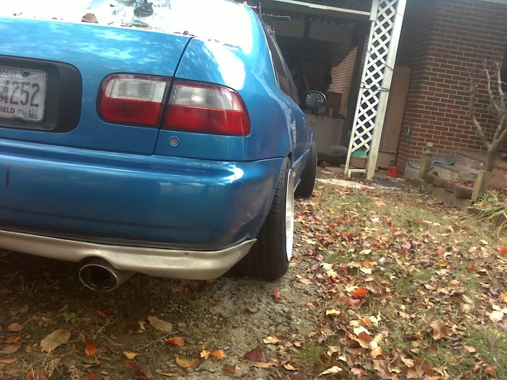

    ill post pics of my eg8 with 0 off set wheels...tire are 205/50/15
    BLUEBERRY
    loa13 loa706's Avatar
    Jan 2010
    ICE CITY/CHATT/DALTON
    405
    and now no camber at all
    BLUEBERRY
    Jan 2010
    405
    id say they tucked but camber kit is a must

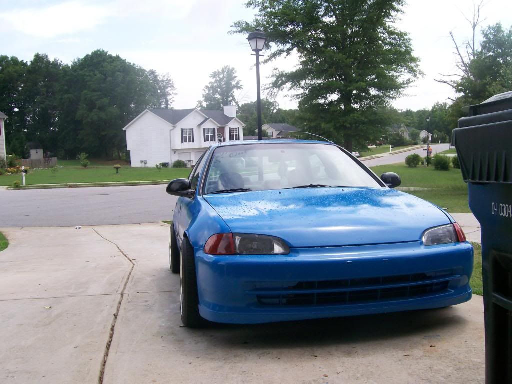

    16x9 +15 need rear camber front is natural 195/45/16 achillies

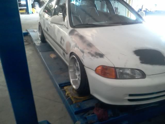

    Got new wheels & aftermarket camber kit on, just need an alignment to make it perfect:
    Wheels are xxr 15x8.25 0 offset
    Tires are 195/45r15 nexen n3000

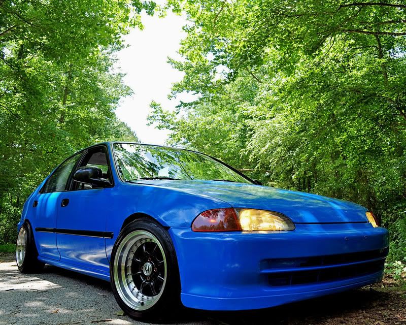

    Running 16x8, +15 offset again, sitting hella'flush now
