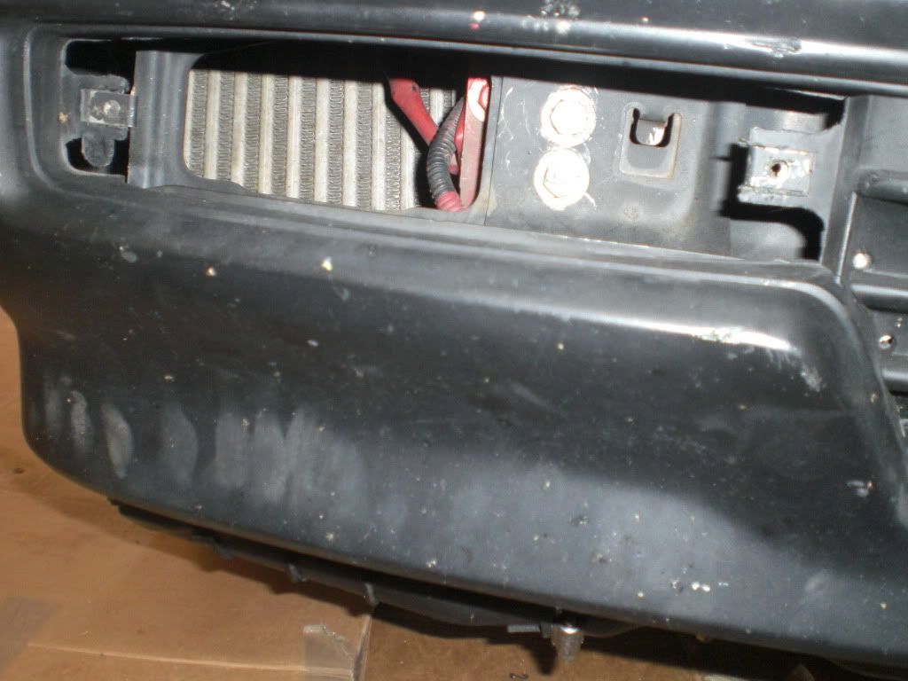

    i got dsm 390 cc injectors, and im going to be running a audi a4 intercooler b/c i dont want to cut up alot of stuff and its just the right size and price! will post pics soon

    locust grove
    229

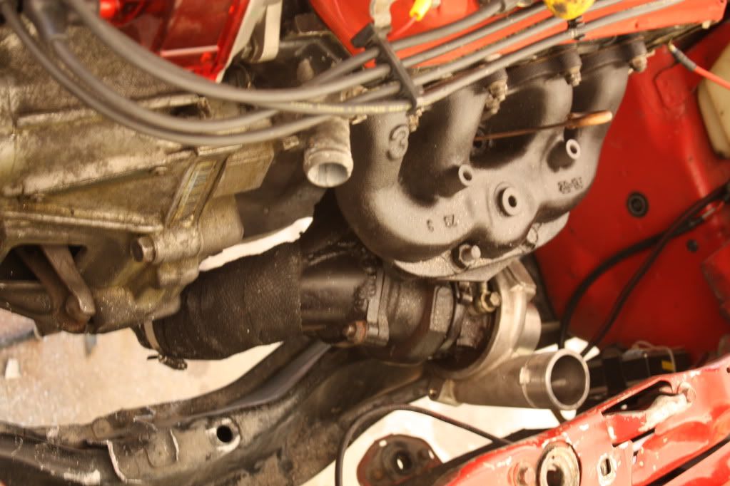

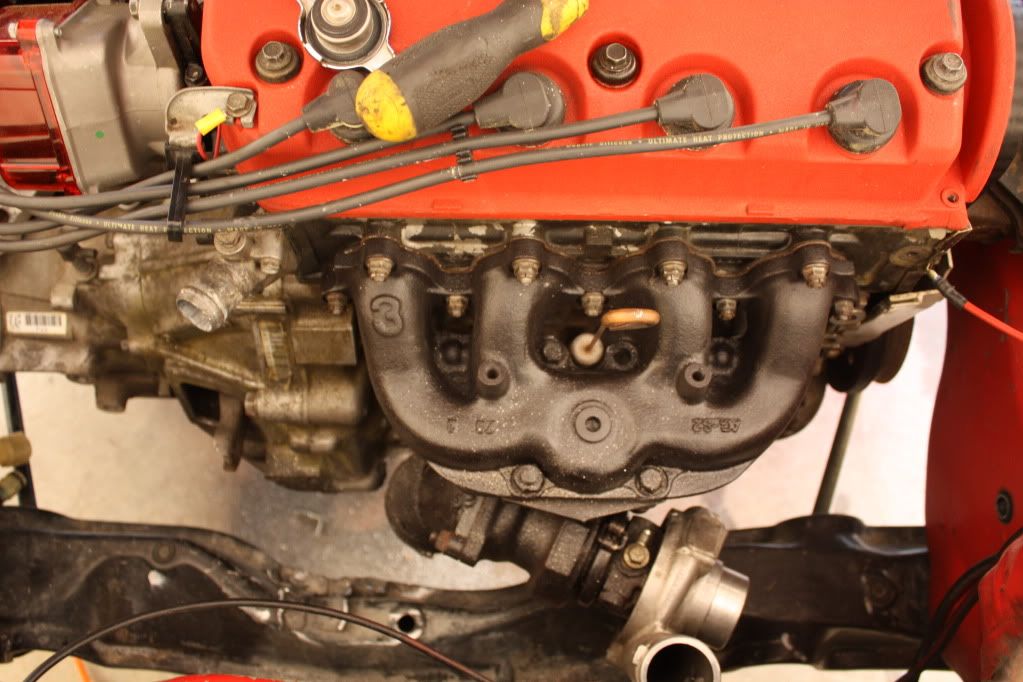

    [IMG][/IMG]
    [IMG][/IMG]
    i need to rotate the cold side so that the outlet points forward. it sits at the weird angle because IHI turbos have the 3 bolt pattern.

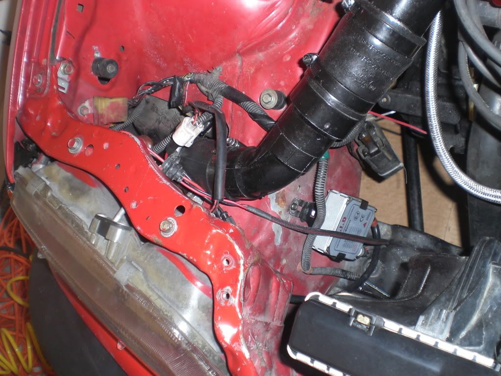

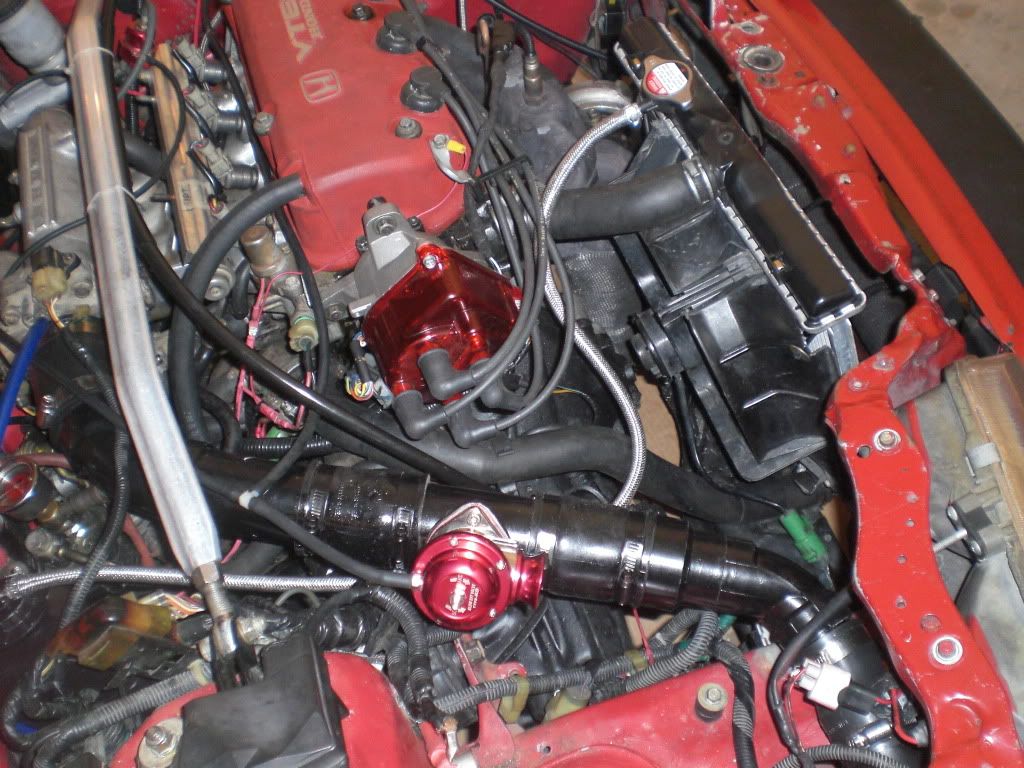

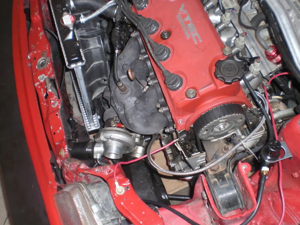

    [IMG][/IMG]
    [IMG][/IMG]
    [IMG][/IMG]
    [IMG][/IMG]
    [IMG][/IMG]
    [IMG][/IMG]
    [IMG][/IMG]
    locust grove
    229
    so i went with the cable si tranny. got it running and on about 6 psi... anyone know the stock fuel pressure off of vacuum?

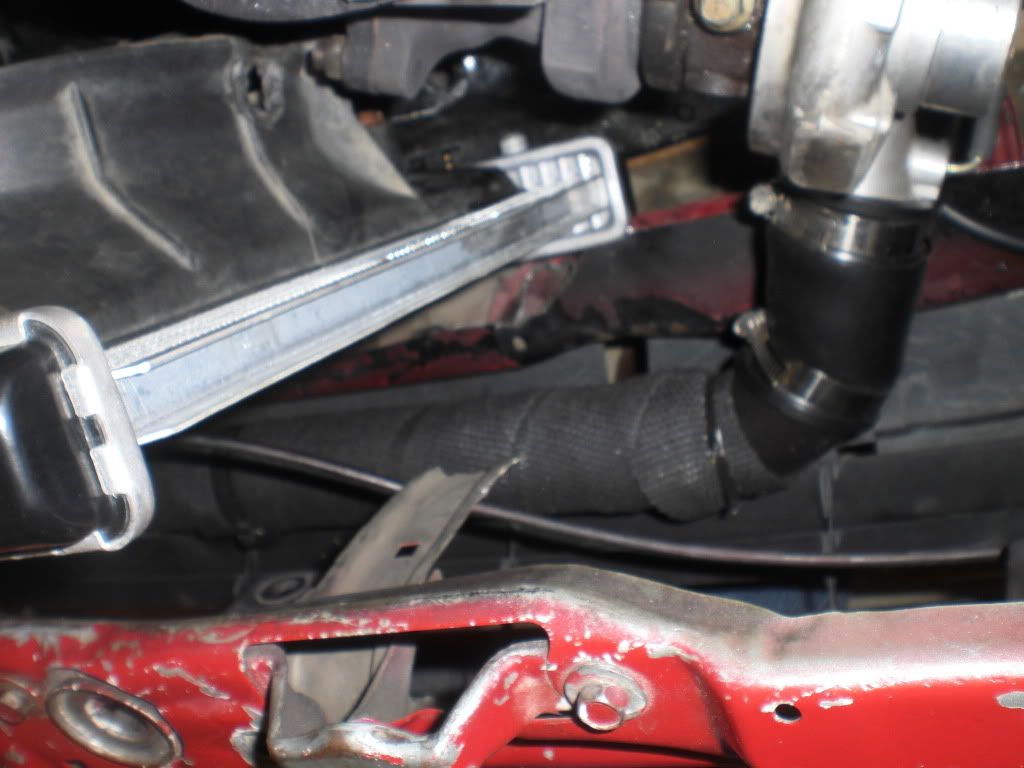

    my total price for this turbo kit
    turbo, manifold, adapter plate, and downpipe..................$200
    dsm 390cc injectors......................................... .............$45
    home depot intercooler piping lol...................................$45
    small audi side mount intercooler...................................$60
    heat wrap, oil lines and fittings and oil filter sandwich......$100
    phereable.net chipped p28 w/basemap and motorola 2.5 map....$230
    so total cost of this homemade turbo kit was ....$680
    not too bad and all my parts minus the intercooler piping and downpipe are all oem parts that will last and not some cheap ebay parts. I reckon thats not to expensive.

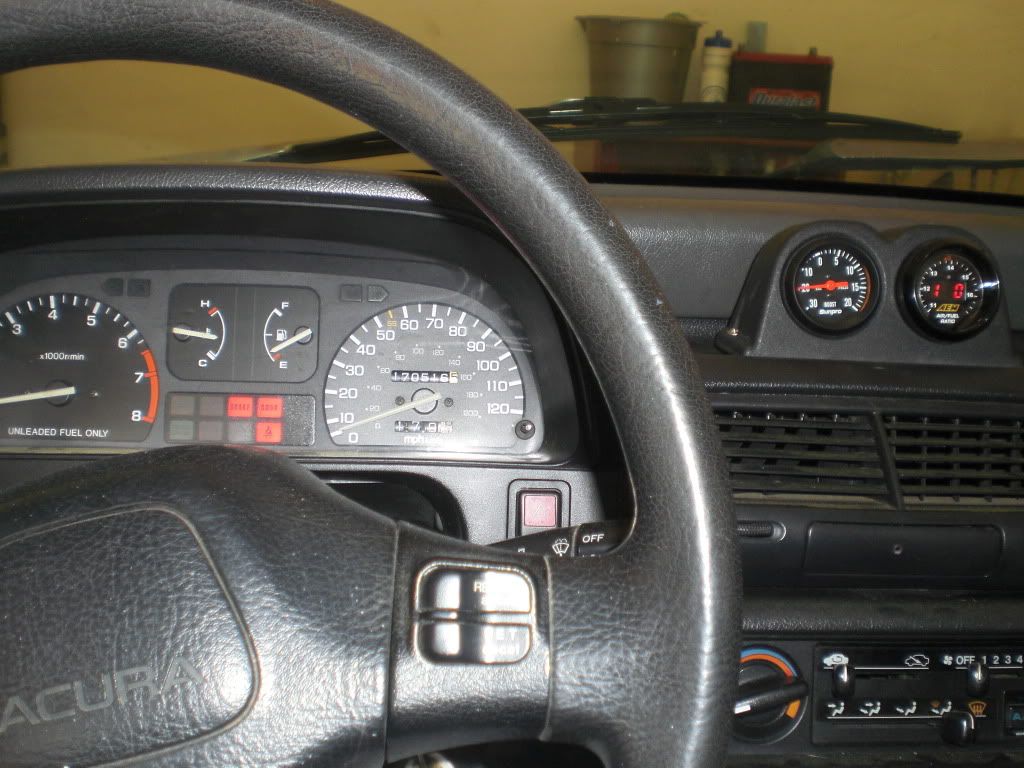

    I do daily this car and it runs fine, just a little rich as i am still waiting for the basemaped ecu. i will fine tune it with my apexi neo which i already had from a previous car. i also had my wideband and boost gauge from a previous car... so i guess if you dont already have that you would need to figure that into the cost.
    so far the stock clutch is holding fine with some abuse but the stock map sensor which i thought was good for 10 psi or so keeps giving me a code anytime in boost, hence the motorolla 2.5 bar map.
    pics of finished product will be up tonight!
