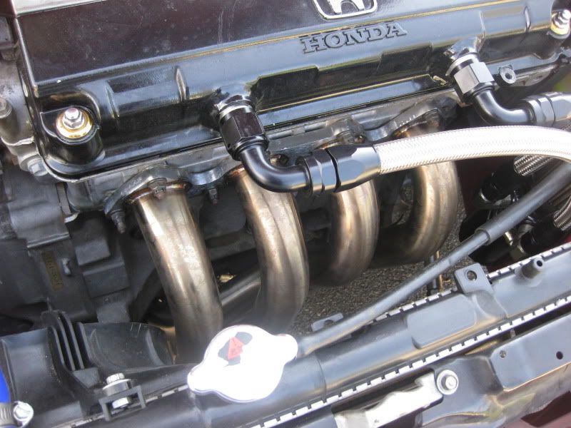

In my question of making more power I decided to swap out my header. During my last tuning session I had a dented tri-y and made pretty decent numbers.
pic of the old header
http://i58.photobucket.com/albums/g2...s/IMG_8768.jpg
http://i58.photobucket.com/albums/g2...s/IMG_8767.jpg
http://i58.photobucket.com/albums/g2...s/IMG_8766.jpg

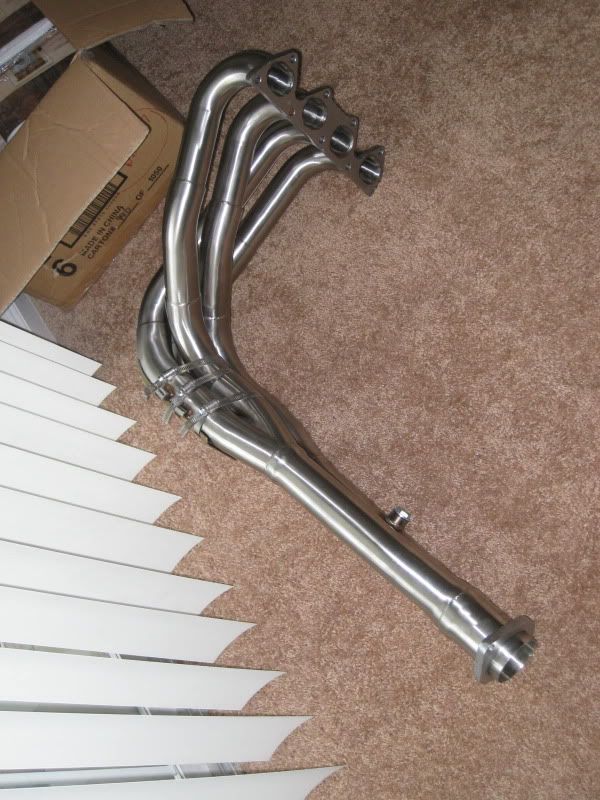

I decided to upgrade to the big tube version since I have 84.5mm b20v (I hear you lose power throughout your powerband with smaller bores)
http://i58.photobucket.com/albums/g2...s/IMG_8738.jpg

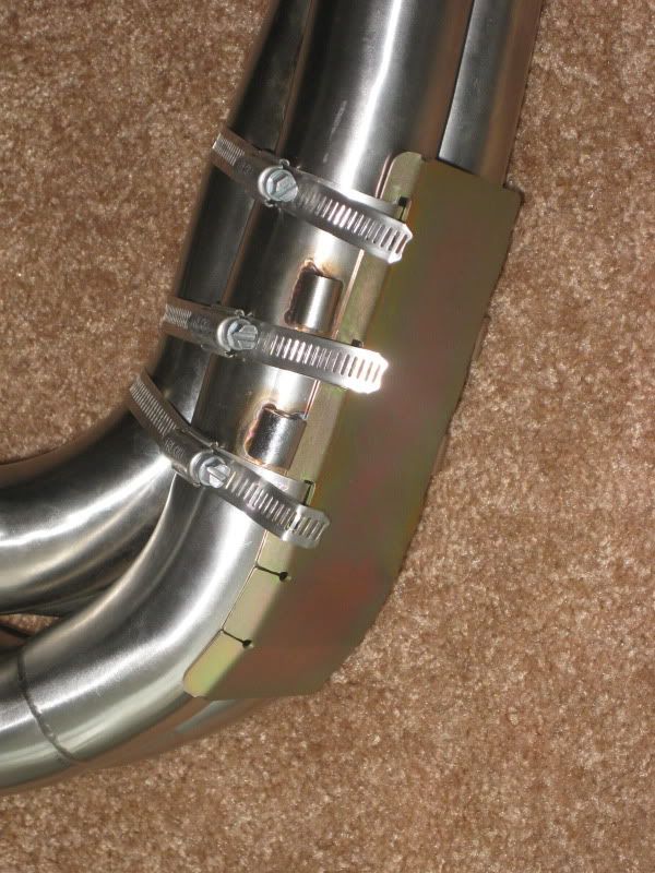

While I was at it, I decided to throw on a skid plate (I'm pissed because it's not worth the $50 they charge for it)
http://i58.photobucket.com/albums/g2...s/IMG_8739.jpg
Installed it
http://i58.photobucket.com/albums/g2...s/IMG_8810.jpg
Luckily I installed the skid plate.
http://i58.photobucket.com/albums/g2...s/IMG_8812.jpg
http://i58.photobucket.com/albums/g2...s/IMG_8811.jpg

Also, I was trying to get a used SMSP replica (High End I believe), but the guy that was selling it was pussy footing around. After trying to contact him for a week, I said fuck it and order this one just to have him PM that evening about the header :smh: Anyways, I don't drive it much since I just got a truck. So I'm not "too worried" about the header. I'm going to eventually raise the car up and put much stiffer suspension on it to help with the clearance issues.

looks like you need to raise your car up a little bit to avoid the problem in general. imo.

Thats the plan JDM94Coupe.
