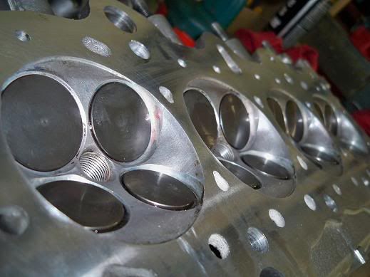

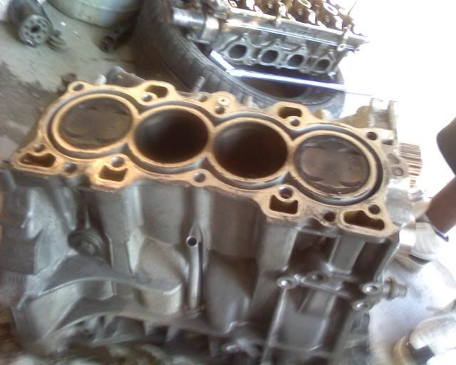

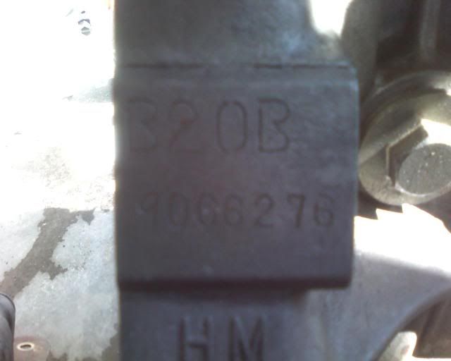

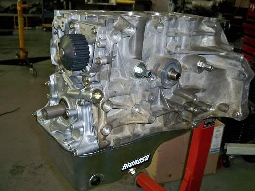

    I considered an h22, but I didn't want to sacrifice oil pan or hood clearance. Then I caught a great deal on a "knocking" b20 on IA for $100 (after taking it apart, it appeared perfected). So that begin my b20vtec "budget" build.
    bye bye ls head
    hello 84x89mm

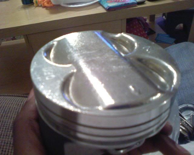

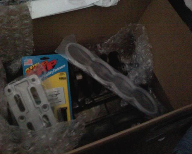

    Since this was a budget build I decided not to go forged everything. I used stock rods (with ARP hardware) and decide to bump the compression slightly with RS machine pistons. The purpose of this build is to make TORQUE since my b16 lacked it. So I slightly overbored the blocked over to 84.5mm
    Since reliable was my goal, I wanted to help support the block more. So I added a properly installed (pressure in then machined) KMS block guard (please take the block guard debate some where else), properly installed KMS girdle (got the mains aligned honed), and ARP main studs for a GSR.
    You can see some of the crap here
    The results were the following:
    (Before I get asked who did my machine work, it was done by Larry Smith Automotive Machine Shop in Rome. Also a member on IA that works for a respectable performance shop in Atlanta assembled it for me. I'll leave his screenname out to prevent from getting his inbox flooded LOL)

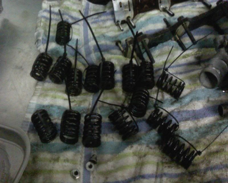

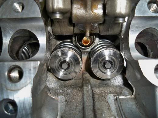

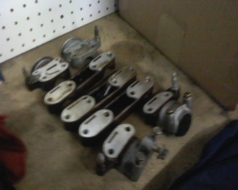

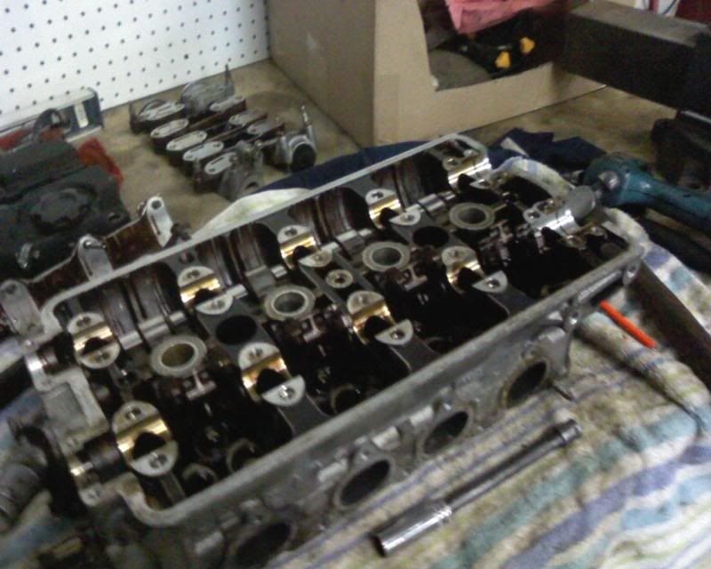

    Since this was a "budget" build, I decided headwork was out of the question (even though I would of loved a RLZ head on it). So after looking on IA for weeks, I found a killer deal on a b16 head (minus cams and dizzy) for $125, so I picked it up . Since I couldn't afford headwork, I decided to help the head out sightly by adding Underground Racing (old school) flat face valves, and KMS dual valve springs and titanium retainers.
    Assembled
    To put the head on the block, I used a Full-Race LS-VTEC kit, and a 84.5mm .30 Cometic LS/VTEC head gasket.
    The results were an old, throwback looking, that's just a raggly obd0 b16 looking, semi build b20vtec

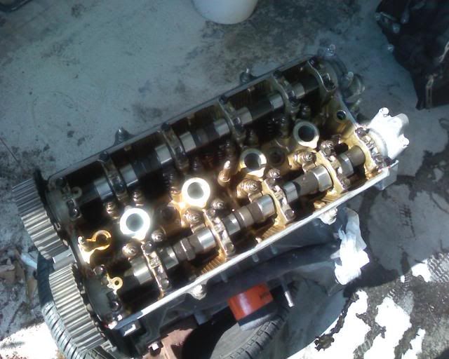

    I didn't say anything about cams yet.

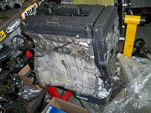

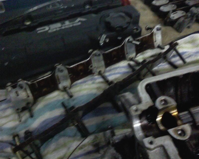

    So being knowledgeable to the game and yet being a noob at the same time. I screwed up big time when it came to cams. I order a set of Underground Racing cams and they ended up having this large ass lift (12.?mm) and long as duration (3??). With cams that large you need to check clearances and can't just "dropped them in". Then with duration that long, and stiff valve springs, you need at least an OEM timing belt (or better). So with that being said, the motor was installing. The car cranked up with no problem, but idle bad as hell (sounded like a v8). I decided to take it home, and then take it to Scotty in the morning. To bad the car didn't make it there. Actually 8miles later, the timing belt did a banana peel (thank you timing belt from a gasket kit ) and I was left broke down on 400. The results were BENDING EVERY DAMN VALVE IN THE HEAD (atleast during those 8 miles, the car ran like a champ whiled I babied it ).
    So luckily, I didn't use many parts off of my old b16. So my homie, took the head off of the b16, swapped my valve train over (minus the cams), and installed my ctr cams. BAM I was back in the game with slightly lower compression, and a least aggressive set of cams. After a visit with Scotty, the results where the following:
    206hp/156tq maxing out stock injectors and bumping the fuel pressure up
