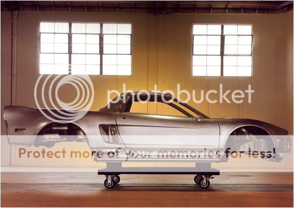

    Typical NSX Monoblock Aluminum Chassis
    Remove practically everything from the firewall back, all the body work and most of the chassis. (Preferably one that's been wrecked in the rear)

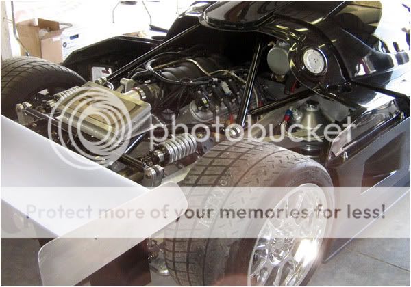

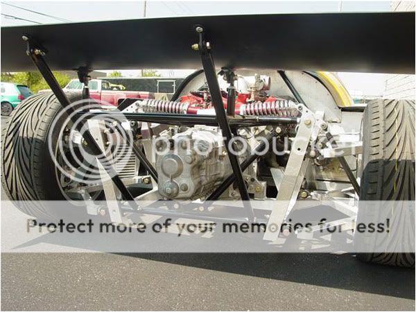

    Superlite Coupe Rear frame [firewall back]

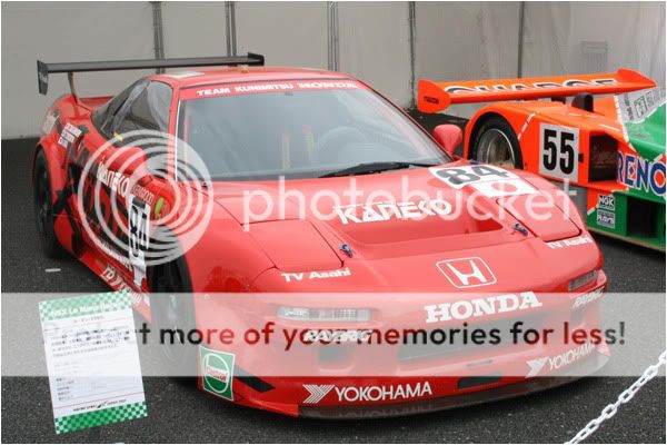

    Finished with solid colored NSX Le Mans composite bodywork.

    The rear suspension is 100% different than the NSX, tube frame with in-board suspension vs. a conventional unibody with double-wishbone suspension.
    The original track of the NSX is 60.6 inches and the width is 71.3 inches. The width of the Superlite Coupe is 74" and I'm still trying to determine the track width of the rear tires. I just know it comes fitted with a 13" wheel in the rear lol! The 91-2001 NSX came with a 215 rear tire mounted on a 8" wheel (91-93) and a 8.5" (94-01). Most likely will be going from a 215 to a 315 rear tire. :boobies:

    The last photo in the original post shows the bodywork fabricated for the '95 Le Mans edition NSX. The front wheel track would be widened to fit flush with the much wider body work then the new rear frame and rear track should match the wider body. Unless it's a Porsche 930-935 I wouldn't want the rear track staggered differently than the front...I prefer a neutral rotation.
    So yes I would want to keep the NSX's look, preferably identical to the '95 Le Mans since I don't like the look of the "stick on" wide body that people use on the street NSX's today. It's the only one I've seen that flows as well.
