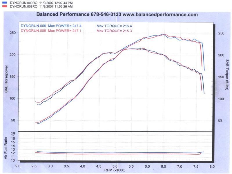

    As a lot IA knows i used to have a h22 hatch with a 65 shot ...putting down 265 at the wheels {236tq} on the spray. Well i felt as if i had gone as far as the h22 was going to go without a 5k build at least... So i sold it ..hehe... I now have a built LS with a nice turbo setup.. Did a little work to it and off to the dyno it went... With VERY little tuning and 11 psi it made nice power. Keep in mind the was a STARTING point . I was still running stock honda map sensor { why i was stuck a 11 psi} and only had rc550's .. There will be another dyno soon.....Please keep the flames to your self...

    Im sure your numbers will be alot higher when you're running right, as of now. It must suck being slower.

    Well thats the thing its not really much slower... I have raced both cars...The hatch has the jump but from there its all over.....

    Not bad numbers if its a straight LS motor. Thats about right power wise.
    Your compression is too low, thats why the numbers are lower that normal, youll have to run more boost to get the same numbers as everyone else running 9.5:1
    throw a thinner headgasket on it!

    Yea i wouldnt have made it so low but it is what it is.... Over all im happy with it and it WILL be running more boost soon... And yea theres no porting , cams or anything...... Anything you can think of thatll help it a lot.. I would like to drop the revhard a/c compatable mani.... Anyone know a way to get a filter on the turbo with this mani???
    8.5:1 is low for a turboed car? Are you serious?
    I have 8:1 compression and the highest I would ever go would be 8.5:1. Detonation and knock suck!

    Well I'm running 10.5:1 pistons with Ferrea flat face valves so my compression is between 10.5-11 and I'm running tons of nitrous on 93 octane with no problems. It's not boost but it's still FI.
    Quote Originally Posted by KevinT707
    Well i have to step in here... Nitrous is fine with hi compression... All hi compression car with a good nitrous setup will own on a drag strip!! Boost is fine with hi compression but the further up in compression goes the more likely it will det... You can keep it in check with good tuning .. Now nitrous will yeild 50 hp on 10:5:1 or 8:5:1 on the same shot , it isnt effected{sp?}like boost is by compression..... Its also not FI kevin... there is no forced air...hehe

    Nitrous is kinda FI, but not really. You are forcing more air (actually nitrous oxide which is still a gas), but you don't really gain horsepower from the increase in cylinder pressure like you do with a turbo/SC, you gain the power because of the higher combustion ratio of N20.
    So technically you are forcing more of something into the combustion chamber, it's just not air.
    But you are totally right on the CR/nitrous thing. Since you arent really increasing the cylinder pressure by that much, running nitrous doesn't really cause detonation in high compression motors. You just gain more power by getting better combustion.
    Where did all this talk of high compression ratio is better for boost start. I've never heard that before in my life. It just doesn't make sense to me whatsoever. More boost>higher compression ratio 100% of the time. If that's not true than there's a lot of evo, supra, dsm, sti and various other t/c vechicle owners that have been doing things totally wrong for a long time by lowering CR to run more boost.
