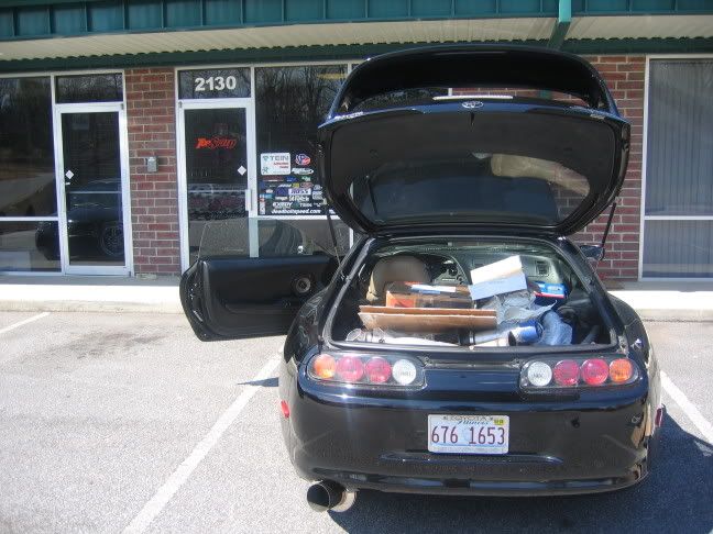

    Month 1--- as you seen in this picture, which was taken 03-30-2006
    My Supra and all parts was dropped off at Topspeed ready for a simple turbo install, no block work with the exception of a headgasket and head studs, and a simple task of pulling the transmission and re-enstalling it once it arrived back from being built.
