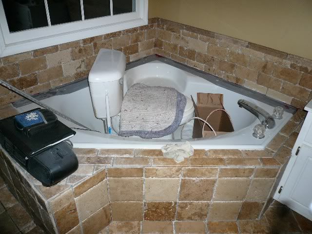

    so, last week (perfect time right before christmas) we found out that our master bath toilet has been leaking around the wax ring. no, crap was not getting everywhere, just liquid. I have no idea how long this has been happening, for all i know 3-4 years since i bought the house.
    the tile was startign to lift up sightly so i fugured i would take a look and pull a few up. Well, nedless to say, its been leaking for a while, the subfloor was starting to rot out, there was no concrete hardyboard under the tile, and thats why the grout was cracking.
    So i made a choice, RENOVATE THE WHOOOOOOLLLLE ROOM!
    i will be updating periodocly. heres the frst pix
    Attached Thumbnails Attached Thumbnails -125-003-jpg   -125-002-jpg   -003-jpg   -004-jpg   -005-jpg
