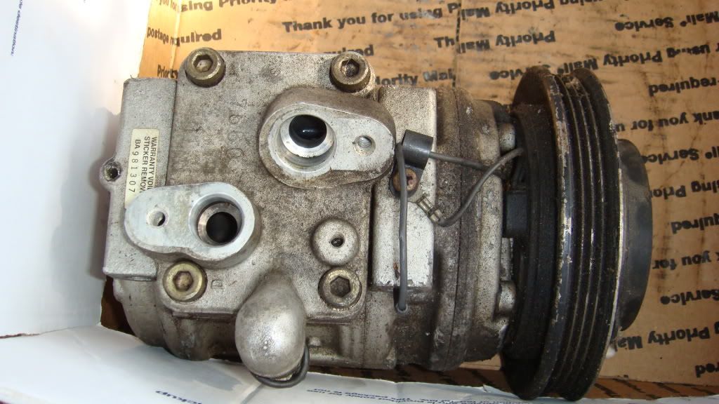

    wanted ias input is this a b16 ac commpressor...99 00 civic si...? if not then what is it

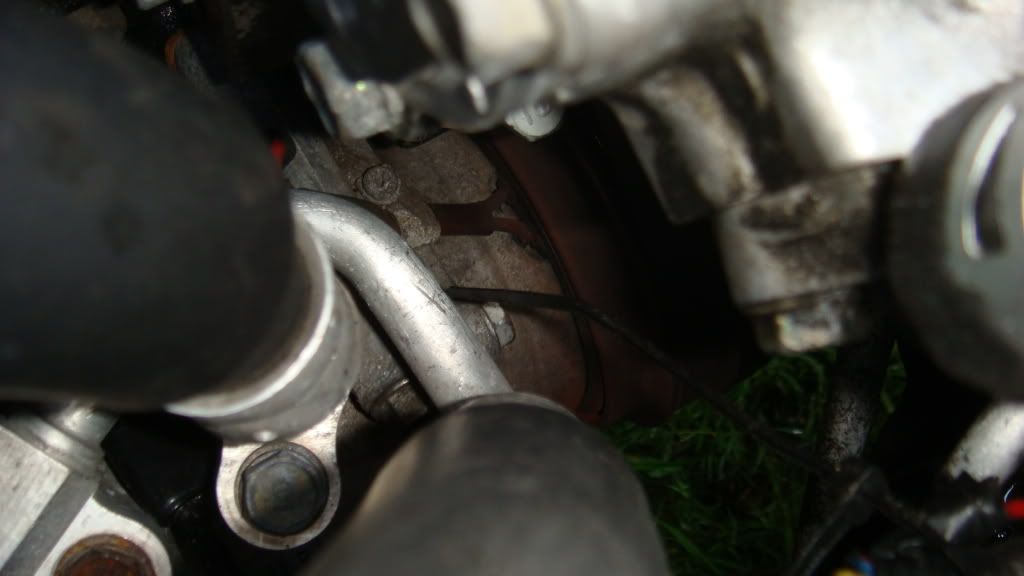

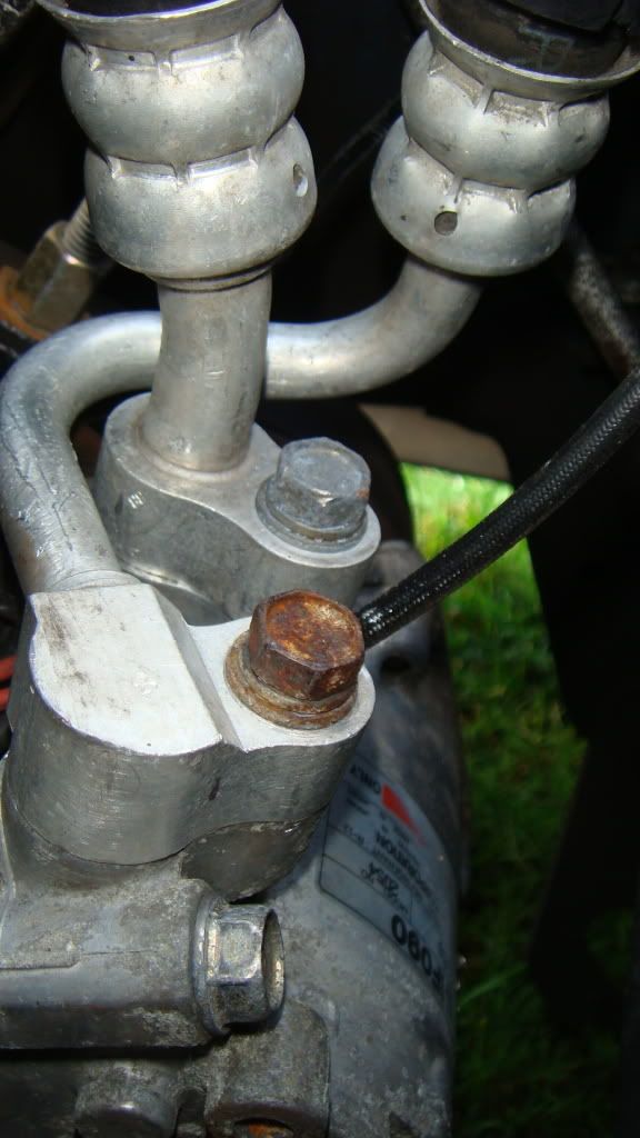

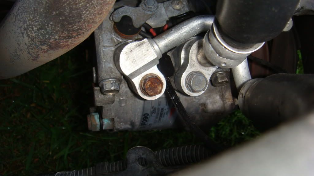

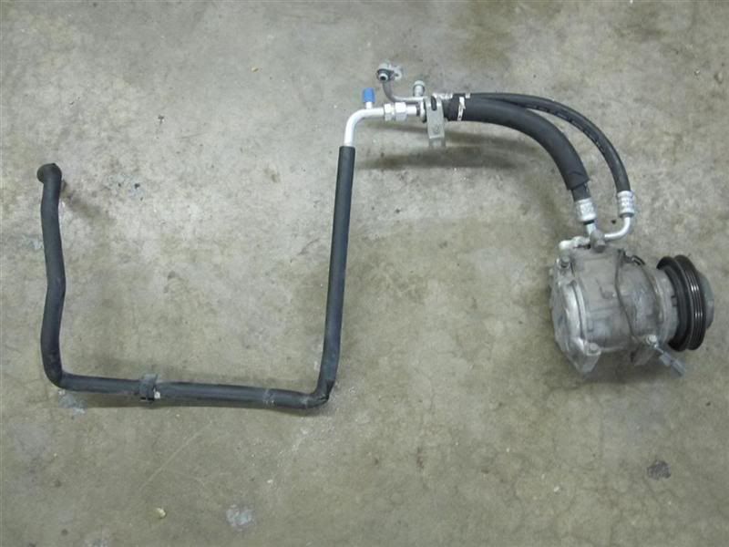

    this is what i have currently in the car it is not the same

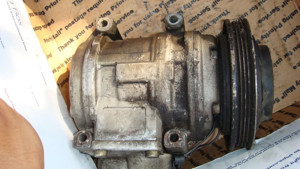

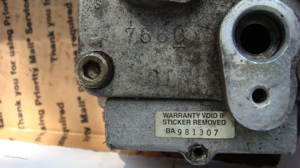

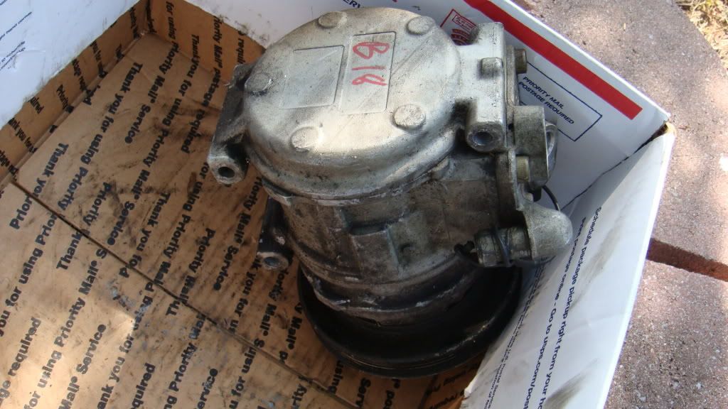

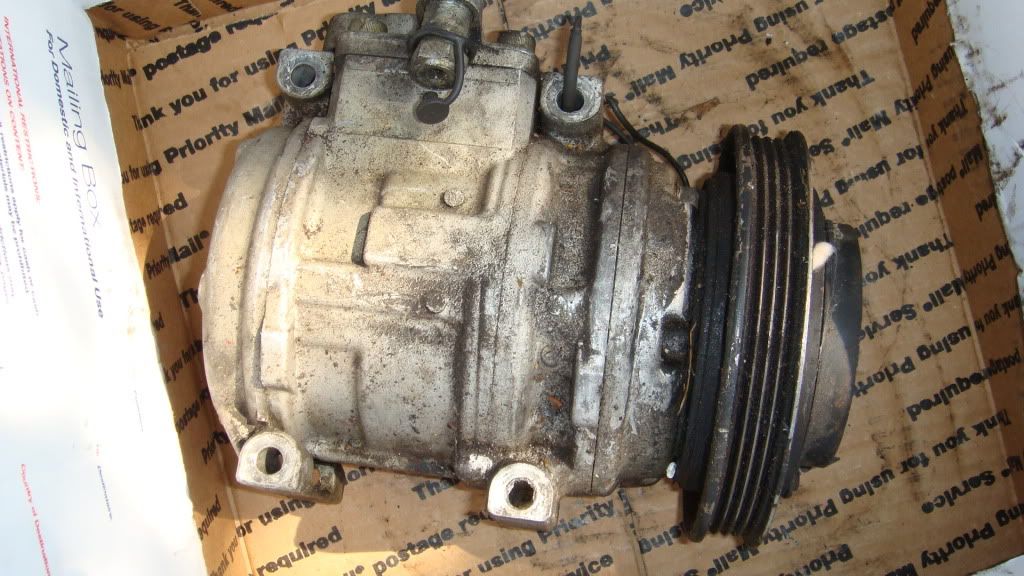

    Since you keep saying I sold you the wrong compressor you asked me for a b16 compressor which Is what I gave you! after going above and beond driveing 200 miles round trip and spending 35$ in gas! And 3 and half hours driving And accuseing me of selling you something else other than a b16 compressor!
    here is the exact 99 si i parted out and that I got the a/c compressor from!
    Here Is the same compressor with 99-00 civic si lines you can see its the same compresssor

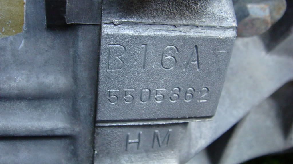

    noot trying to argue or ruin ur reputation..just wonderind why its not da same if mine is a b16
    That Is a d series compressor not a b series

    how i remember the difference between b and d series is that d-series, the right hose curves over the left one, just like in your picture.
    this is a 92-2000 civic non si correct?
    you have a crv/del-so si bracket, enabling you to use a d-series compressor.
    either way, your going to need a d-series compressor because of the a/c hosing on your chass. you can not use a b-series. it wont line up
    your old compressor is a d-series, this is not silversol's fault, you thought you needed a b-series compressor.
