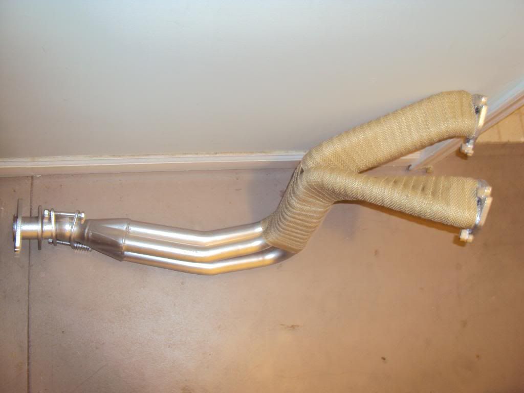

    Looking for a place to coat my old header. Thanks.

    I have a rare header and I want to coat it to prolong it life. It's hi temp painted and wrapped but I want cermakrome it.

    re: wrapping your header, esp if you're going to have it coated also -I recommend that you reconsider wrapping it, as it'll eventually cause the header to rust out from the inside. Besides, a ceramic-type coating will retain the heat inside the header, and you'd be wasting your money using a wrap, in addition to the cost of the coating. (and, the header will be coated on the inside & the outside of the tubes in most applications)
