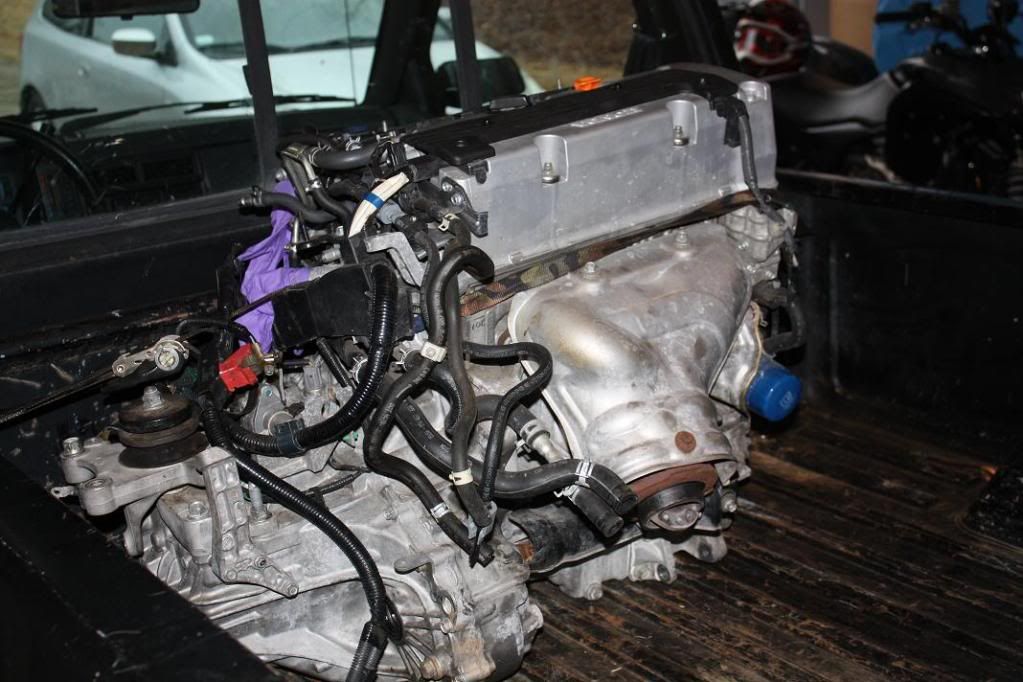

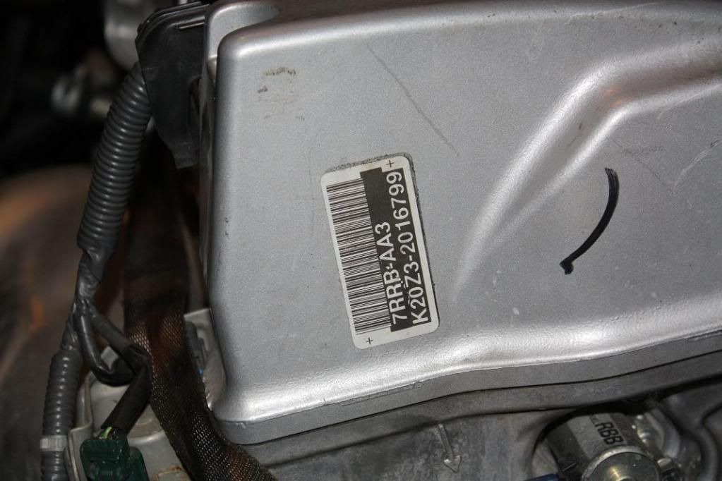

    ok so i thought i would update with some pictures of what i have collected so far, the only thing i am waiting for now is an open bay in the shop lol. i already have the kpro, its installed already so no pictures there.
    the first picture is of the throttle body adapter, needed because the throttle body on the k20ze is dbw, and i need to put my cable throttle body on. also the speed converter, that is needed because of the vss on the z3 reads differently, it is a magnetic pickup instead of traditional electronic gear types honda had used for quite a while. oh and amsoil FTW
