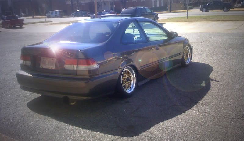

    Ok, so after getting many PM's inquiring on how I rode so slammed and claimed to do so without any rubbing... I've decided to do a write-up on what I did to modify my front fenderwells in order to achieve lock-to-lock turns with no rubbing at absolute dumped status . Anyway, here's a rough step by step guide on how to rid your ride from the dreaded rub. I know for sure these tips work on Civics and Integras from 1992-2000. Much older or much newer vehicles may have slight variations, but I would guess not by much.
    Also, if a mod could please make this a sticky, I'd greatly appreciate it.
    I'll try to make this as understandable as possible. lol. And maybe sometime I'll get around to taking some pictures to help further explain these steps.

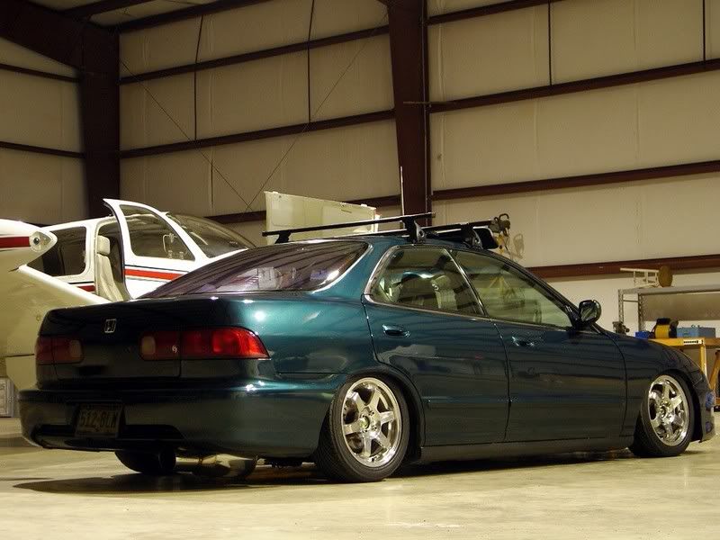

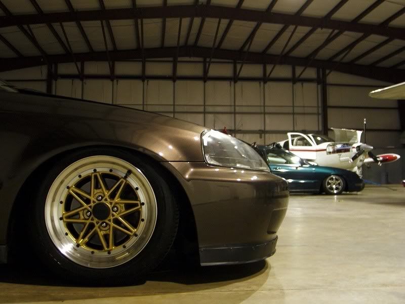

    A couple tips from se7en: (since andrew asked for input as well)

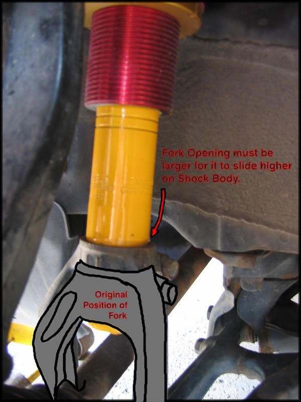

    *Trick #1
    the infamous "fork trick" that can be used; a picture says a thousand words:
    in essence, you are pushing the damper further down into the fork, you want to be careful when doing this as to not place it too FAR down as it may come into contact with your axle - no bueno.
    *Trick #2
    EF front forks (and dampers) on a 92-95 civic - they're shorter... by about an inch - and will bolt right up. This will decrease the overall length of your LCA - Strut Tower length and will instantly lower your car about 1".
    *Trick #3
    skinny tires, smaller rims - get the 40 size sidewall instead of the 45 or 50, get the 15" wheel instead of the 16" if it's that important to you.
    *Trick #4
    trim a hole in the strut tower - I'm not recommending doing this, as it can definitely take away from the structural integrity of the car. But at least your A-arm wouldn't smash anymore.... right?
    *Trick #5
    get some stiff springs... and I mean stiff. What? Your Omnis have 10k front and 8k rear? try again - those rates come out to 560lb front and 448lb rear, which means that your suspension will move too much for typical daily stuff if you're wanting to ride low. My current setup uses 18k front and 12k rear - 1012lb front 674lb rear... yes, the car rides somewhat stiff, but to those who have ridden in it since i installed the new stuff, all sing the rides praise. I never bottom out, and the car handles well. And dang there were a lot of commas in that last run-on sentence.
    *Trick #6
    negative camber can be your friend - to those of you who want to ride slammed and be able to turn... prepare your wallet for lots of new tires.

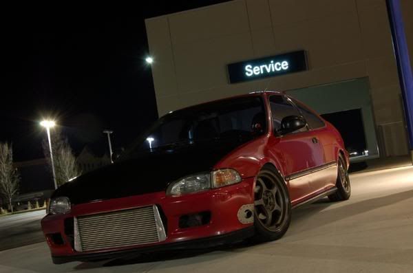

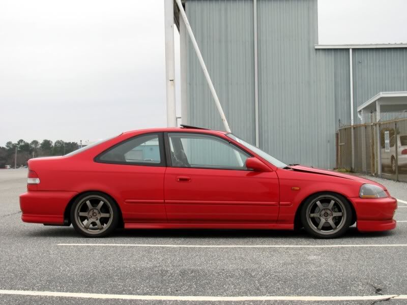

    a couple of pictures for my "resume of accomplishments'" for cars i have owned and considered to be "slammed." Sorry if they're a tad to large, I'm not feeling like resizing these.
    the current configuration - with now different wheels/tires:
    and there you go

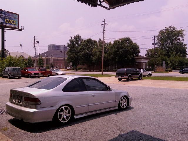

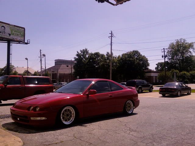

    vs.
    I though you meant height, not distance from wheel to fender.
    But I too hate the "sunken ship" look. I just had the silver coupe and red integra each for like 2 months each so all I did was dump them on whatever wheel it was on. High offsets on OEM wheels ftl.

    Quote Originally Posted by Nang
    pics of this, my rears are not going down anymore
    and the answer for you is here
    ^ You want to cut that piece in pink. BUT i would leave about half inch to a inch lip, cause you dont want the coil sleeve to slide off the edge if it was cut even.
    and another trick (think) for all the da, and 92-95 guys, you can use 88-91 crx rear shocks, they have a shorter body and give that little bit more slammage. Ek guys can use them to, but i think you have to use spacers.
    Senior Member Nang's Avatar
    1,378
    so what is shorter in the front between ef an eg/dc? the shocks or the fork? or both
