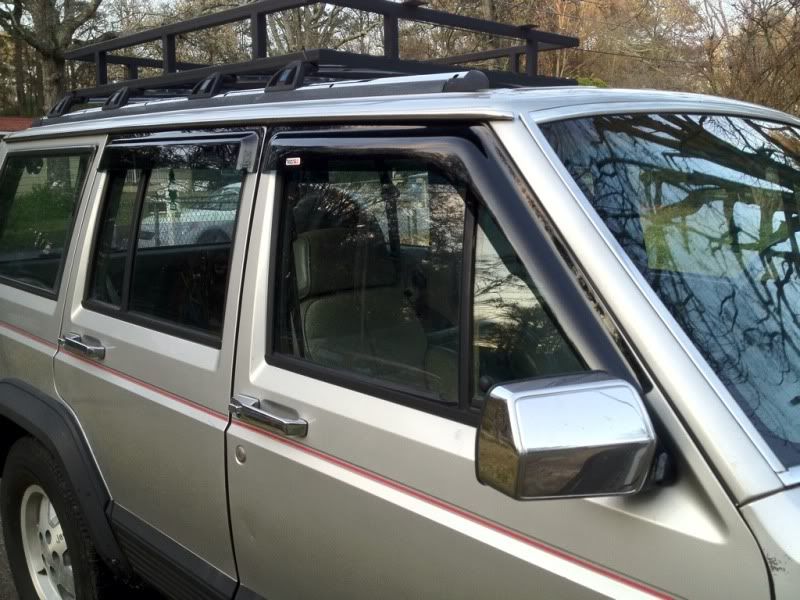

    I picked this up today, as some may know I work with a Jeep company. So it's almost natural I ended up with one.
    Rundown:
    1992 Laredo
    -4.0L/auto
    4x4
    HP Dana30/Dana 35
    Tow Package
    Has 235k on the body today but has 80k on the '95 engine.
    Needs:
    Driver tail light.
    Passenger door hinge tack welded.
    Radio.
    Misc. hardware for the dash/interior.
    Brakes.
    The tires that were on it were practically slicks and were puny 205/60/15s and I got some 255/70/15s mounted and balanced for $130. The wheels weren't balanced originally and after I got that taken care of it drove straight as an arrow.
    On to pictures!
    I hope to have some updates soon!

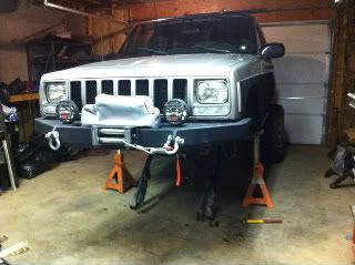

    Hrm...not quite sure on the specifics, but bumpers/lift/wheels/tires. Just the basics and then I'll add my personal touches here and there. I'm thinking of doing a 30 spline hub conversion on the HP Dana 30 with chromoly shafts/upgraded ujoints and a selectable locker with similar upgrades for the rear. But if I can find a deal on a Dana 44 F/R setup that'd be ideal.

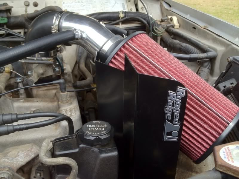

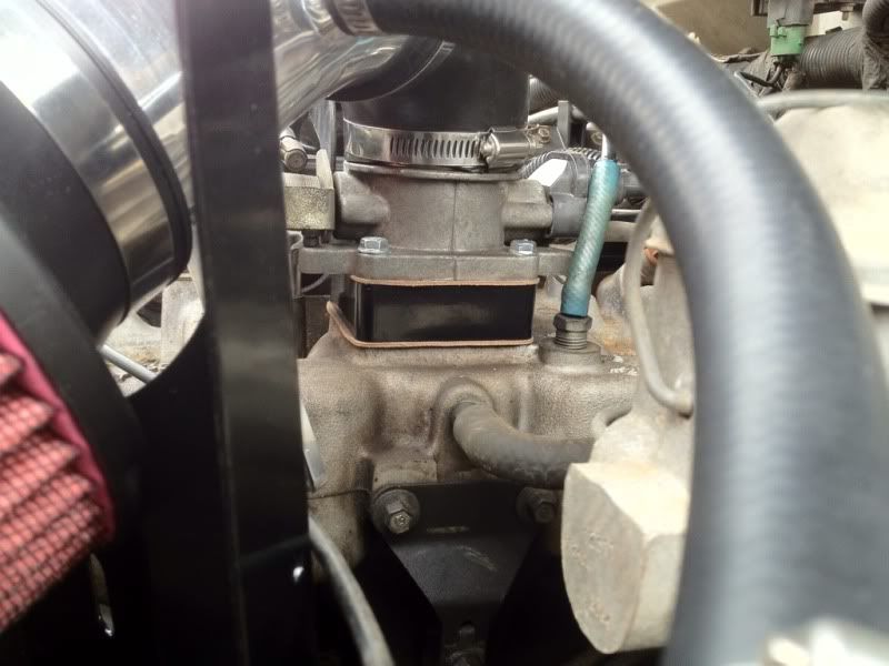

    Installed a Rugged Ridge intake and throttle body spacer, they aren't really made to work together in the sense the isolator won't meet the head shield. But I finagled it to work. Sounds good and the throttle response is noticeably better!
    Bozzio for president.
    Looks good!
    May 2003
    somewhere, GA
    5,091
    Nice! The 4.0 responds really well to this stuff. Throw on a edlebrock shorty header and a 2.5" exhaust to a flowmaster and this really helps it breathe.

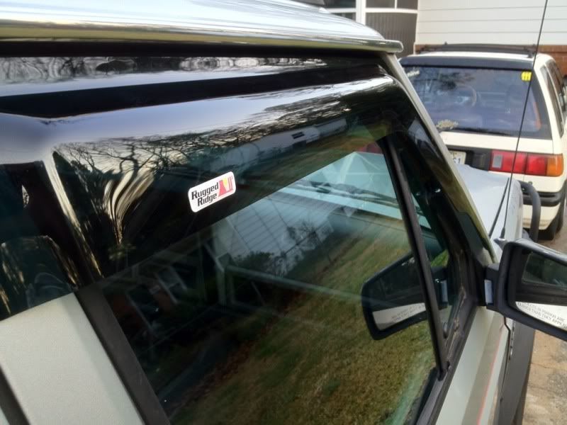

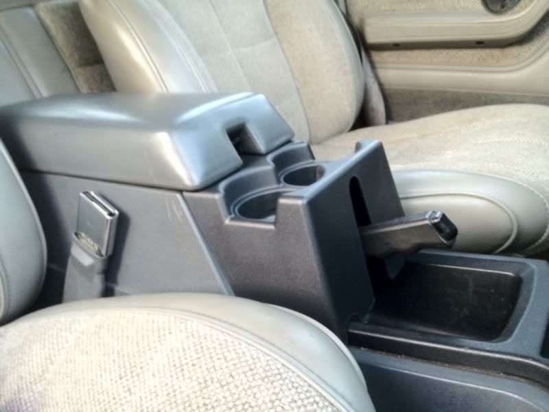

    I installed some Rugged Ridge vent shades. Also put in two new hatch struts (only had one worn one) and a double cup holder. Must haves! A great deal on the front half of a lift fell in my lap, so it looks like I'll be looking into some leafs for the rear soon. I'm also getting a set of 5 of d-window wheels with worn 31s for the low.

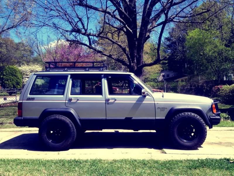

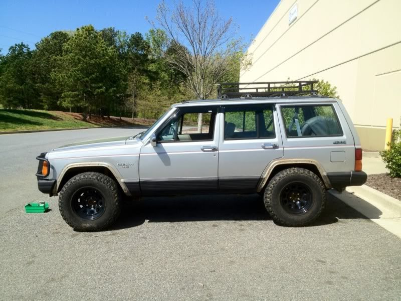

    5 15x8s with 31s and a hi lift.
    I also replaced the alternator, battery, terminals, cap, rotor, plugs, plug wires, and fixed a few odds and ends.

    31s with no lift.

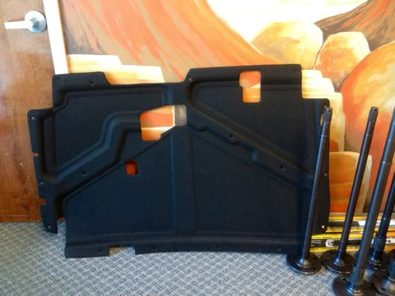

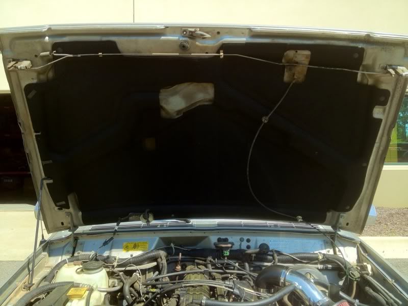

    I got our new XJ replacement hood padding to test fit/replace on my XJ today.
    EE OG Revmaynard's Avatar
    11,401
    New good pad installed:
    Removed the fender flares for some pocket flares/more clearance.
