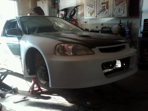

    CAr going from this
    To This
    Closed ftront now

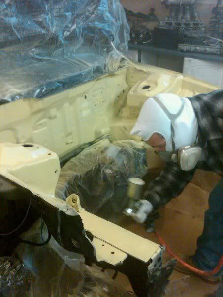

    Repainted engine bay ( well my dad did)

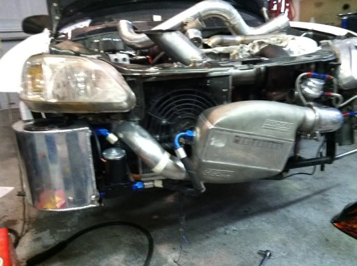

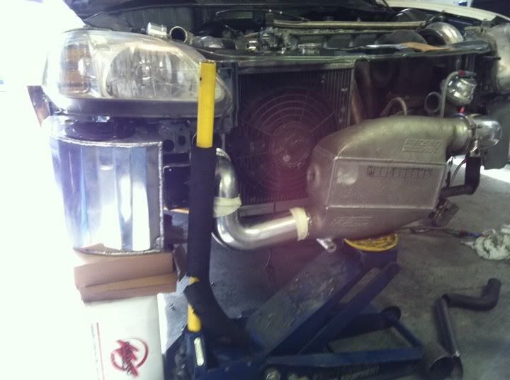

    New water pump and intercooler pump and water tank

    looking good man....what size lines are those running to the intercooler
    JJSPEC.COM
    Privateer Racing!!
    Duluth,Ga
    5,730
    Quote Originally Posted by d16_turbo View Post
    16AN... OR SHOULD I SAY
    I Found a place that sells them super cheap, with fitting and all i only paid 20 a line....
    warner robins
    1,535
    Quote Originally Posted by B18c1Turboed View Post
    nice...yeah im about to put bigger lines in mine I have -12 now but im going to -20
    JJSPEC.COM
    Privateer Racing!!
    Duluth,Ga
    5,730
    I wouldnt go 20 an thats too big man. Intercoolers have 1" inch lines, that equals 16an . I wouldnt go bigger then 16an.
    warner robins
    1,535
    Yeah im welding -20 an bungs on my intercooler....we run -20an on my firends mustang and they work well...plus I drive my car on the street alot, so it will help with street driving .....not saying the -16 wouldnt work

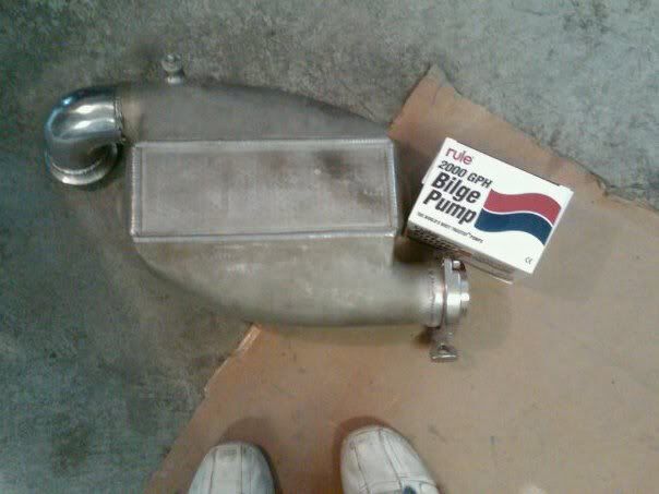

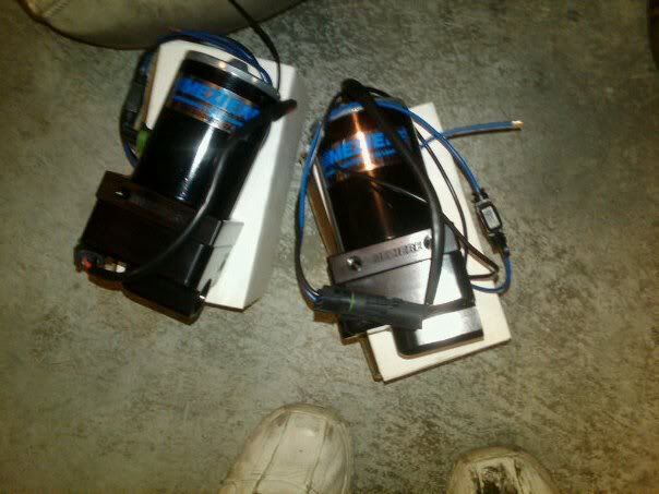

    I'm still stuck on the 2000 GPH race pump next to the intercooler.
    Bitches love bacon.
    Privateer Racing!!
    Duluth,Ga
    5,730

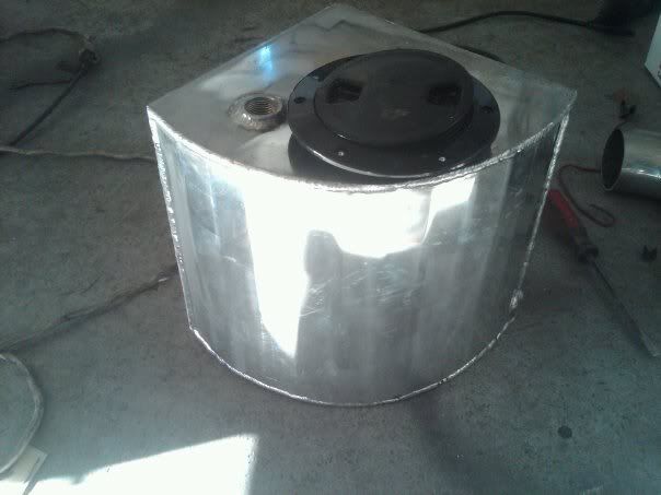

    Pumps water thru the air/water intercooler. The tank that its attached to is for water and ice....
    McDonough
    10,593
    Damn. I was thinking fuel pump at first.

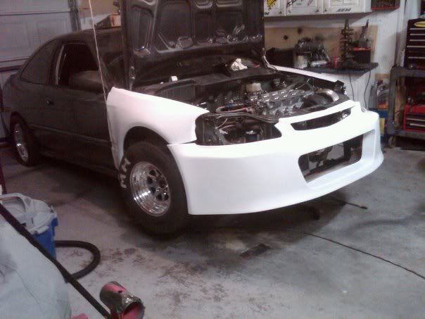

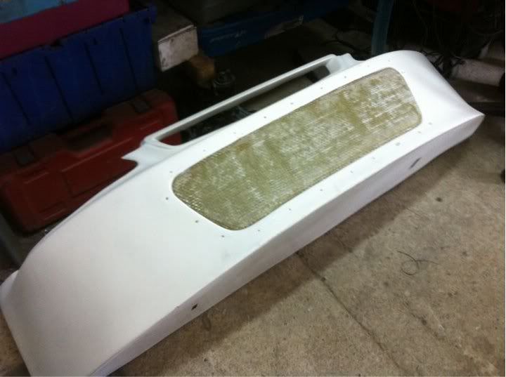

    why did you block the front off?
    Privateer Racing!!
    Duluth,Ga
    5,730
    Quote Originally Posted by Slid3OrDi3 View Post
    WHy not? im running air to water intercooler.
    warner robins
    1,535
    exactly lol

    im a newbie as well with your logic so could you elaborate...sick build

    Aerodynamics also. Wind will go around the car instead of thru it. Well thru engine bay.
    warner robins
    1,535
    Yup.... my water temp doesnt get above 195 on the street with the front all closed up, and thats with a stock rad

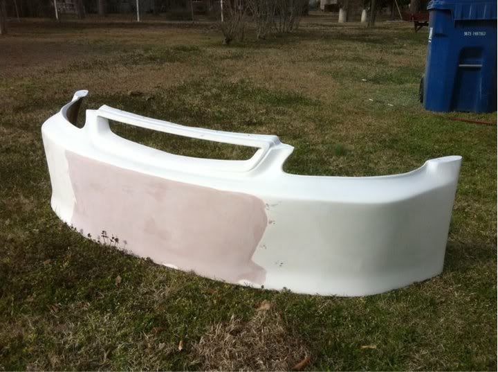

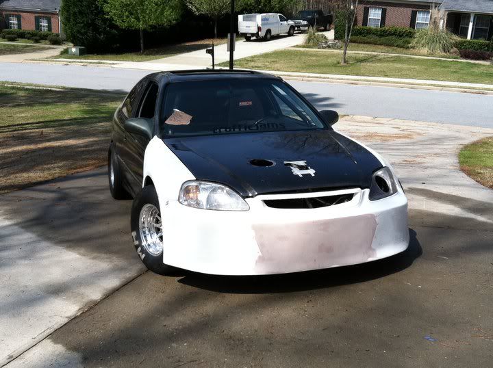

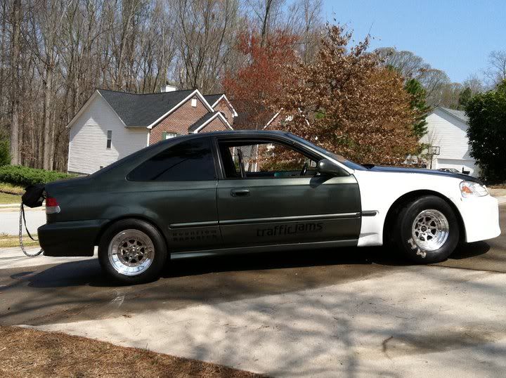

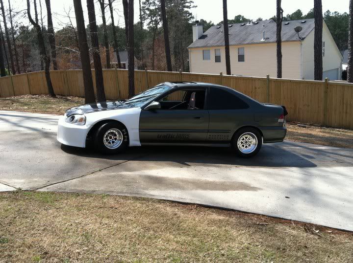

    I was bored yesterday, so i pushed the car outside to wash it.Here some pictures, the car will be repainted in the next few weeks. I hope!
