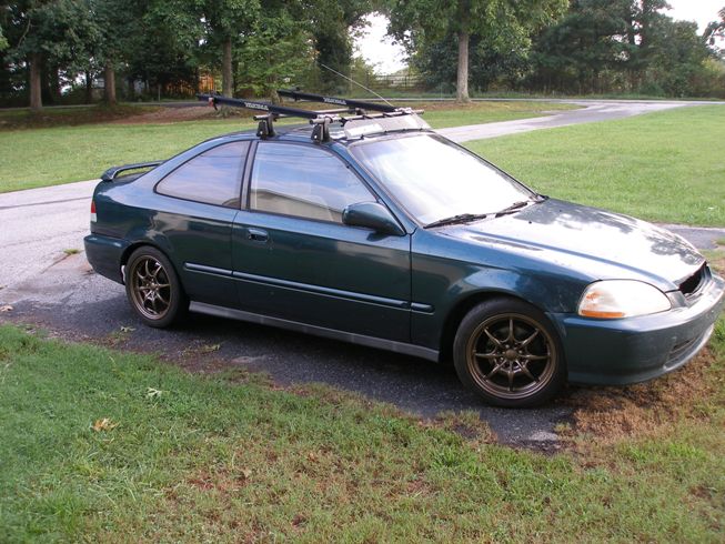

    bronze autozone paint!

    looks good, did you clear them?

    very nice, nice car too man..

    thanks guys..and thanks for the bike rack compliment....here's what i did:
    sand all rims thoroughly w/ 400 grit paper
    tack off all the rims w/ tack cloth
    spray 1/2 can of general purpose primer on spots i sanded thru on
    spray 5 coats of bronze autozone rim paint on each rim
    spray 1 coat of autozone rim clear on each rim
    all in all, i'd do 2-3 coats clear if i did it again, just for more protection...they turned out good tho...i got a pinhead sized chip on the front left one havin the tires balanced/rotated...not much noticable tho...
