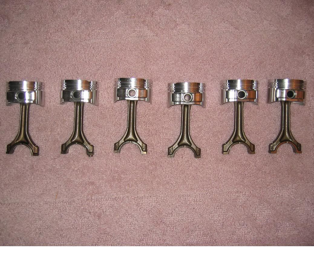

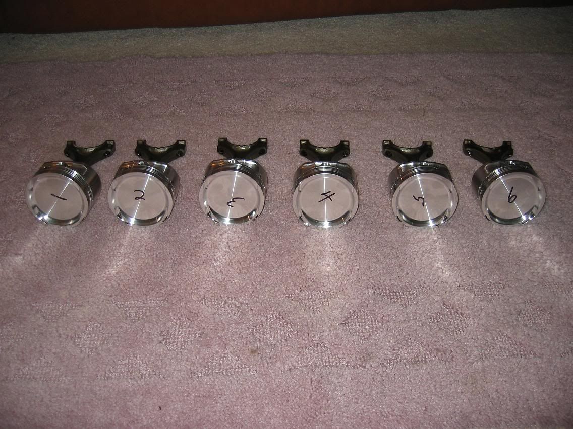

    CP Pistons, Rings, Wrist Pins and Clips. 8:5:1 compression .40 over, motor will be 87mm now increasing from 3.0 liters to 3.1
    Vac MLS Cometic 5 layer 0.70 Head Gasket
    ARP Head Studs and Main Studs

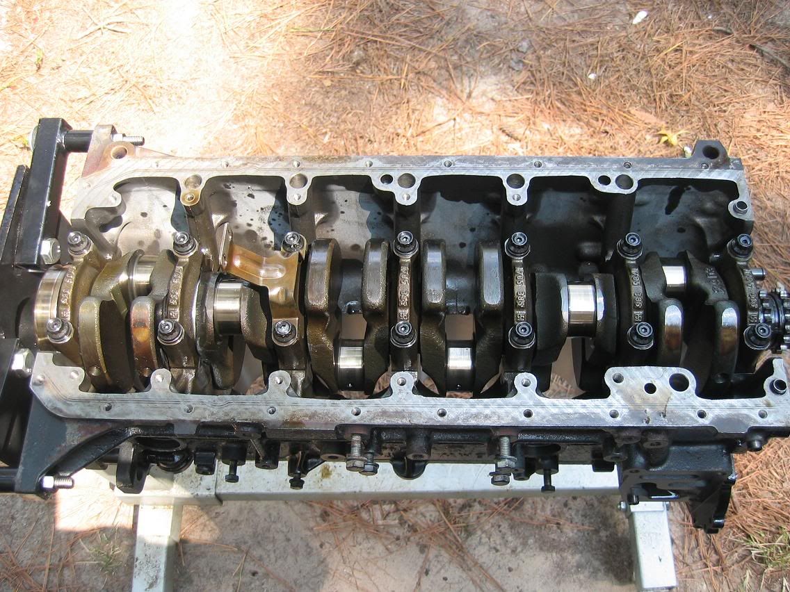

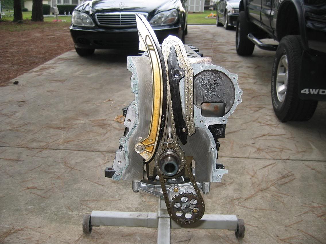

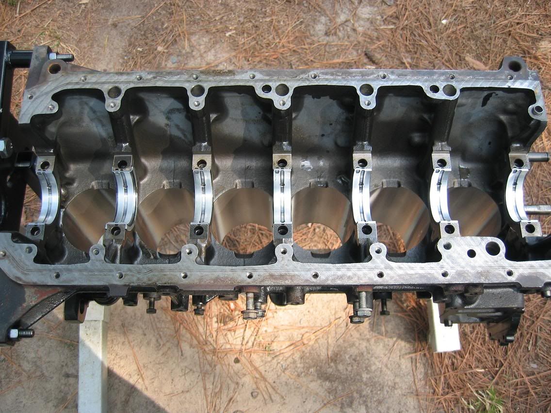

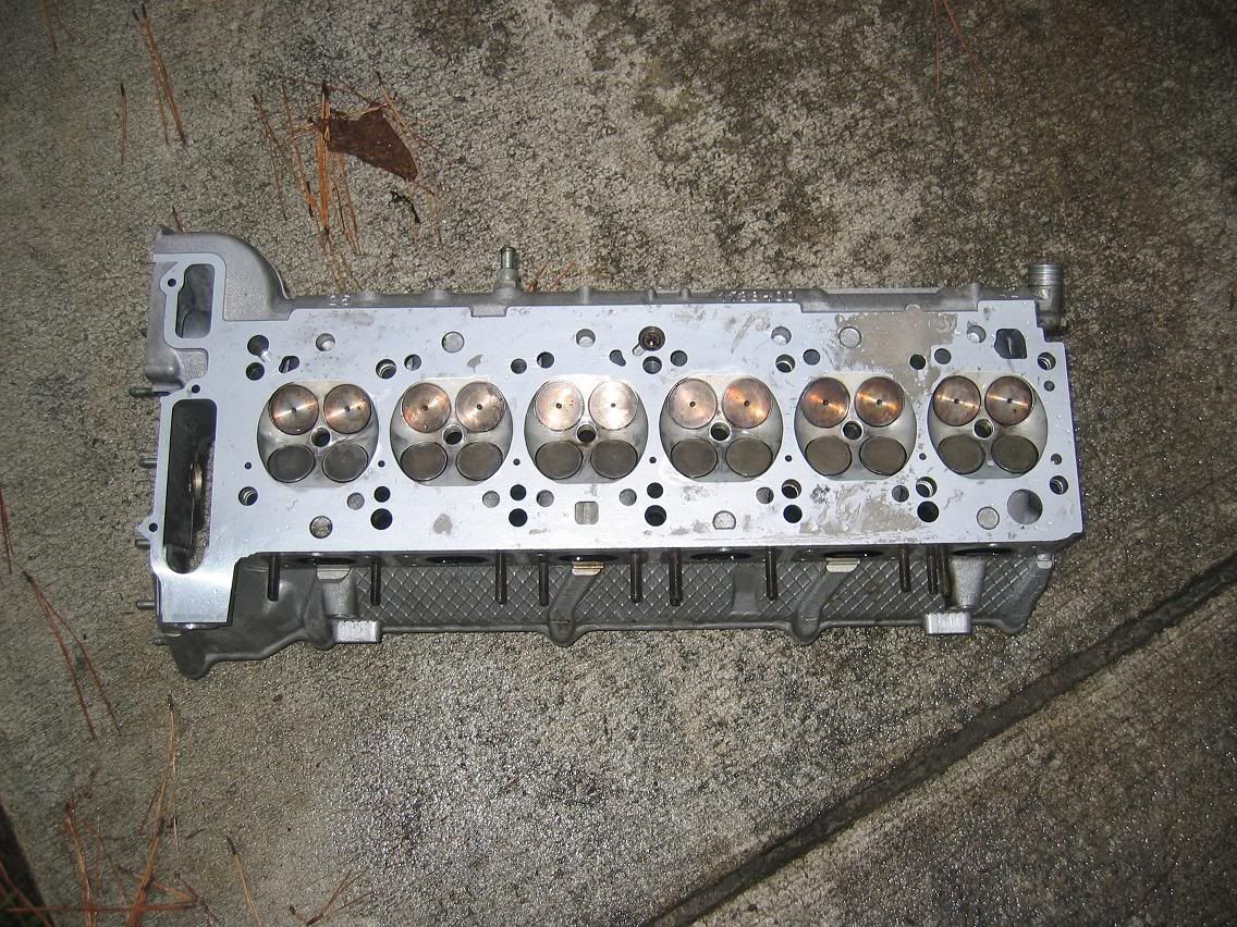

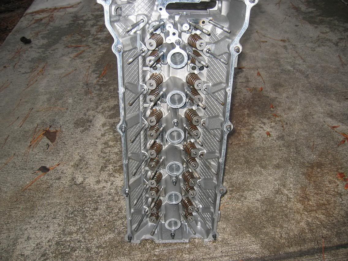

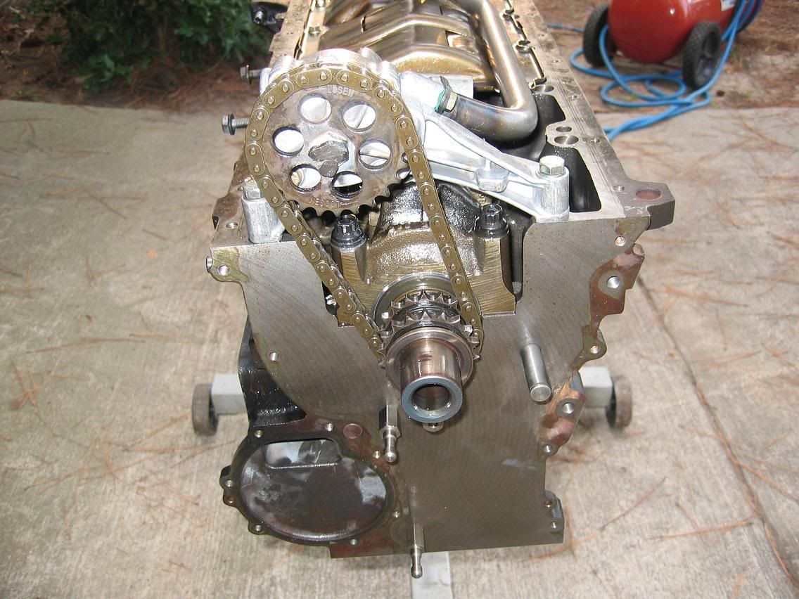

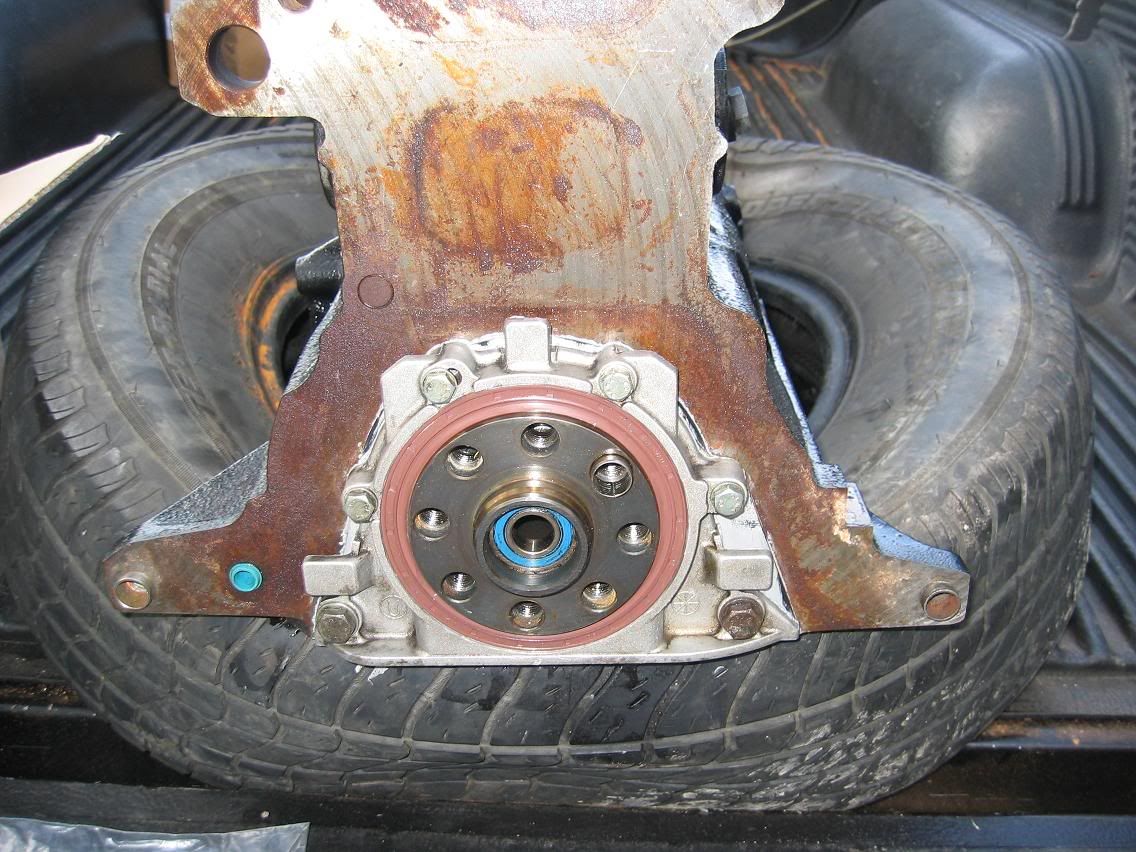

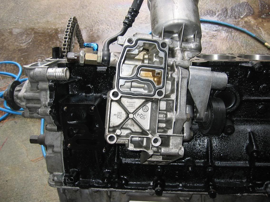

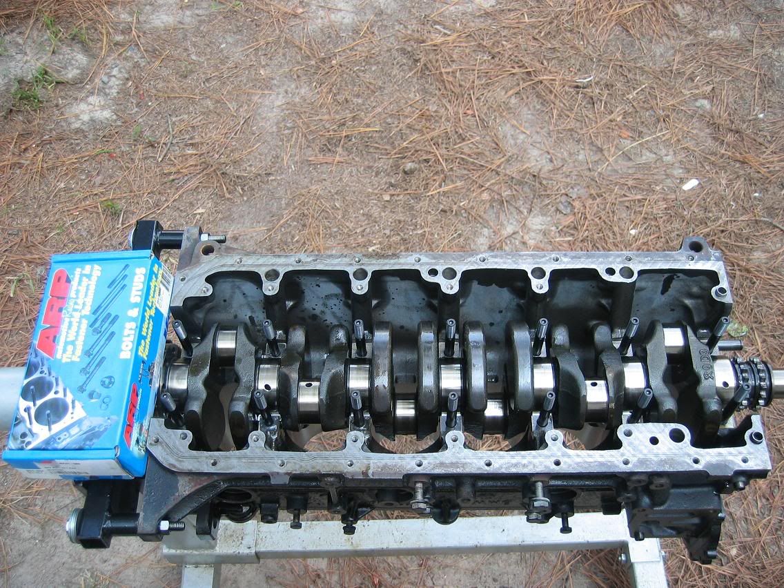

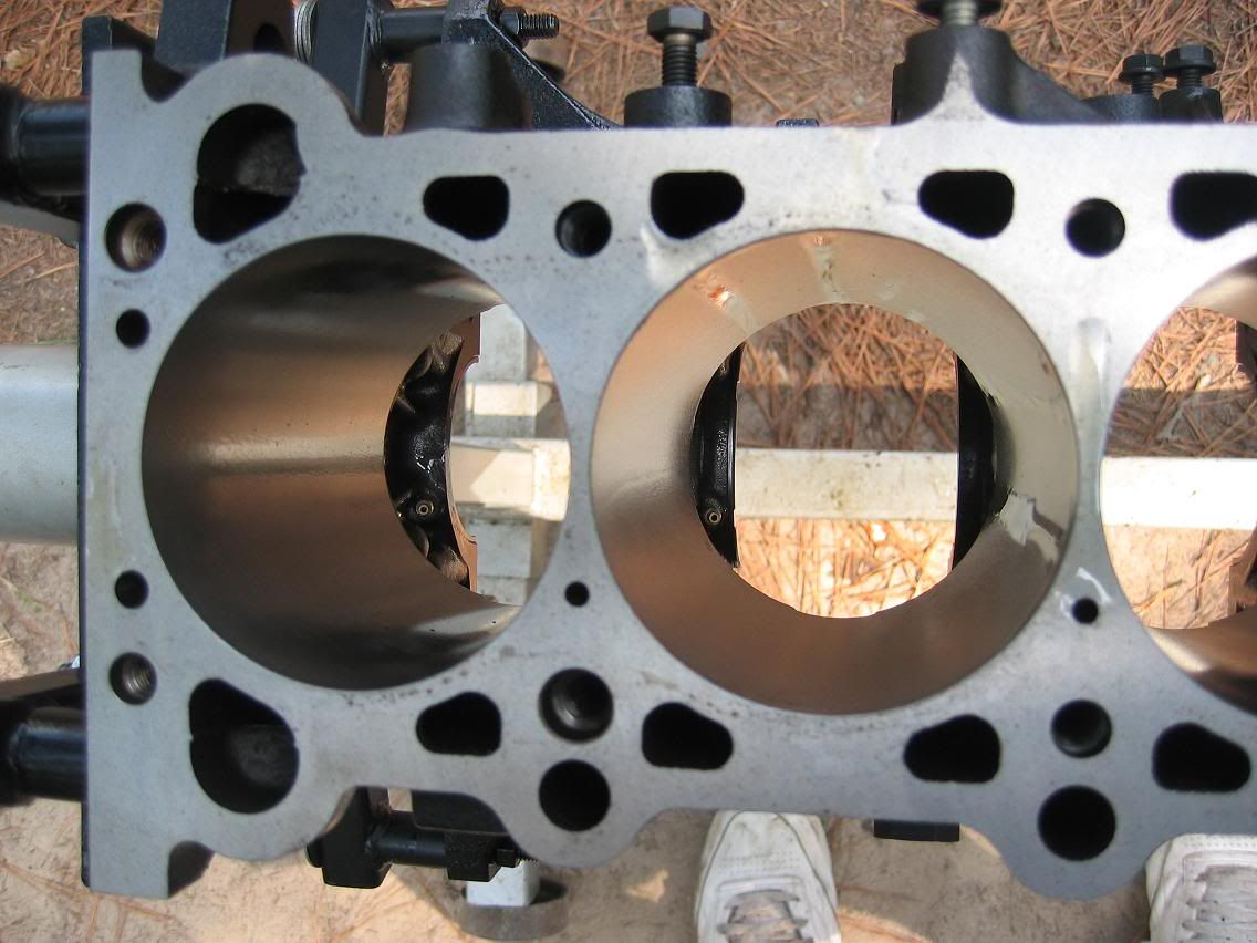

    UPDATE
    got the motor pulled last night and head separated. everything off to machine shop this week..
    Thanx Charles!!!!! who is on his way back to NC. this man is hard core!! comes down after pulling a all nighter of work and gets my motor pulled and separated and heads out back home to NC this morining
    pix here.
    Nikon D300s|SB900|Nikkor 70-200 f2.8 VR I| Tamron 17-50 f2.8
    stock
    Norcross
    479
    Attached Thumbnails Attached Thumbnails -bmw-install-pics-007-jpg

    Attached Thumbnails Attached Thumbnails -bmw-install-pics-004-jpg
    stock
    Norcross
    479
    Attached Thumbnails Attached Thumbnails -bmw-install-pics-003-jpg

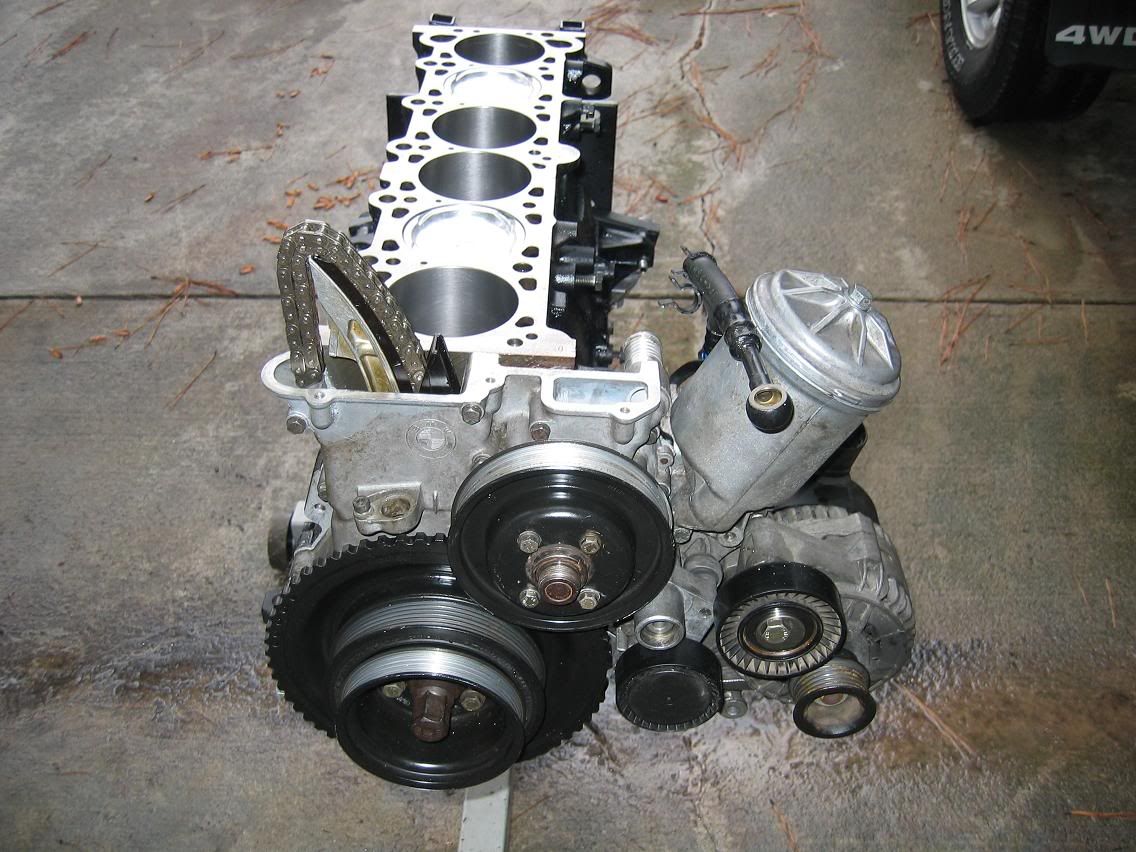

    WRX on Roids
    424
    Man how much whp are you looking at for this set-up? My guess is about 320whp depending on how much boost you are going to be running.
    stock
    Norcross
    479
    Quote Originally Posted by Footefan52

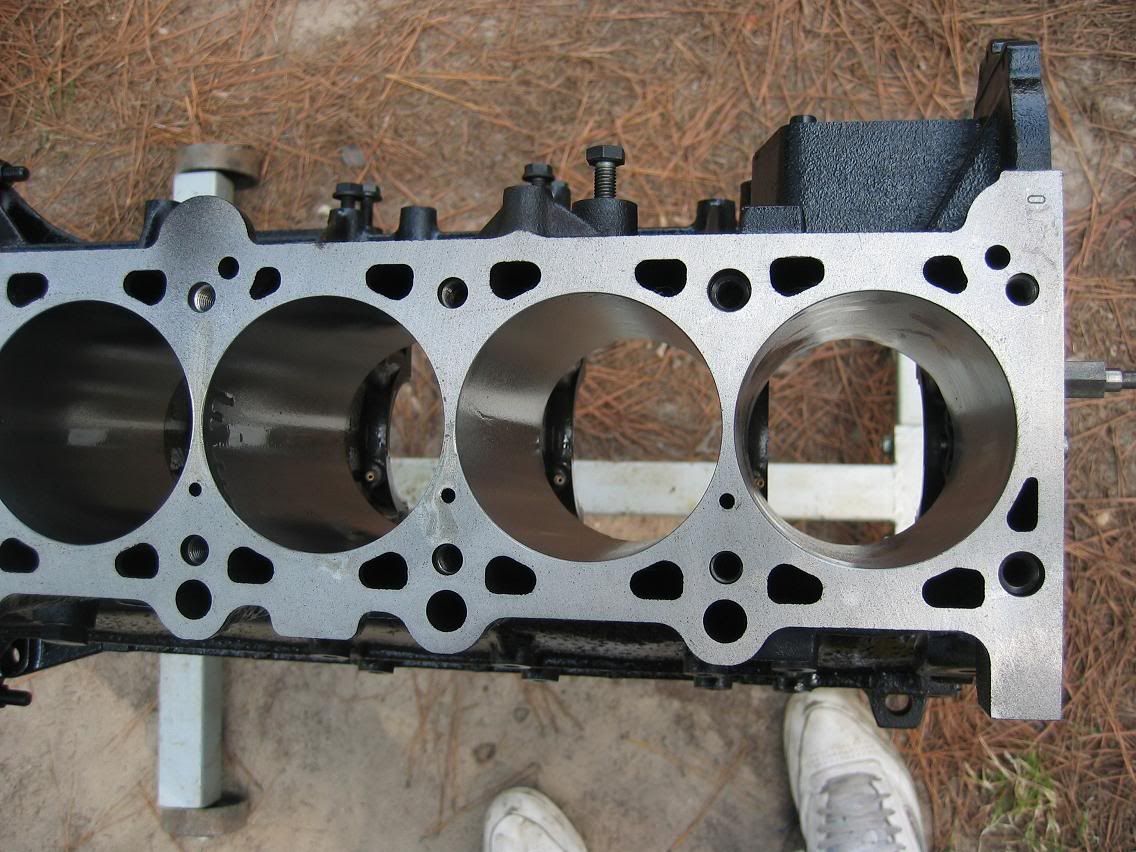

    haha no man. probably closer to 500-600 rwhp. but id be happy witih 400 anyways.
    stock motors are taking a beating up to 620 rwhp on bimmerforums.
    more pix of the block below.

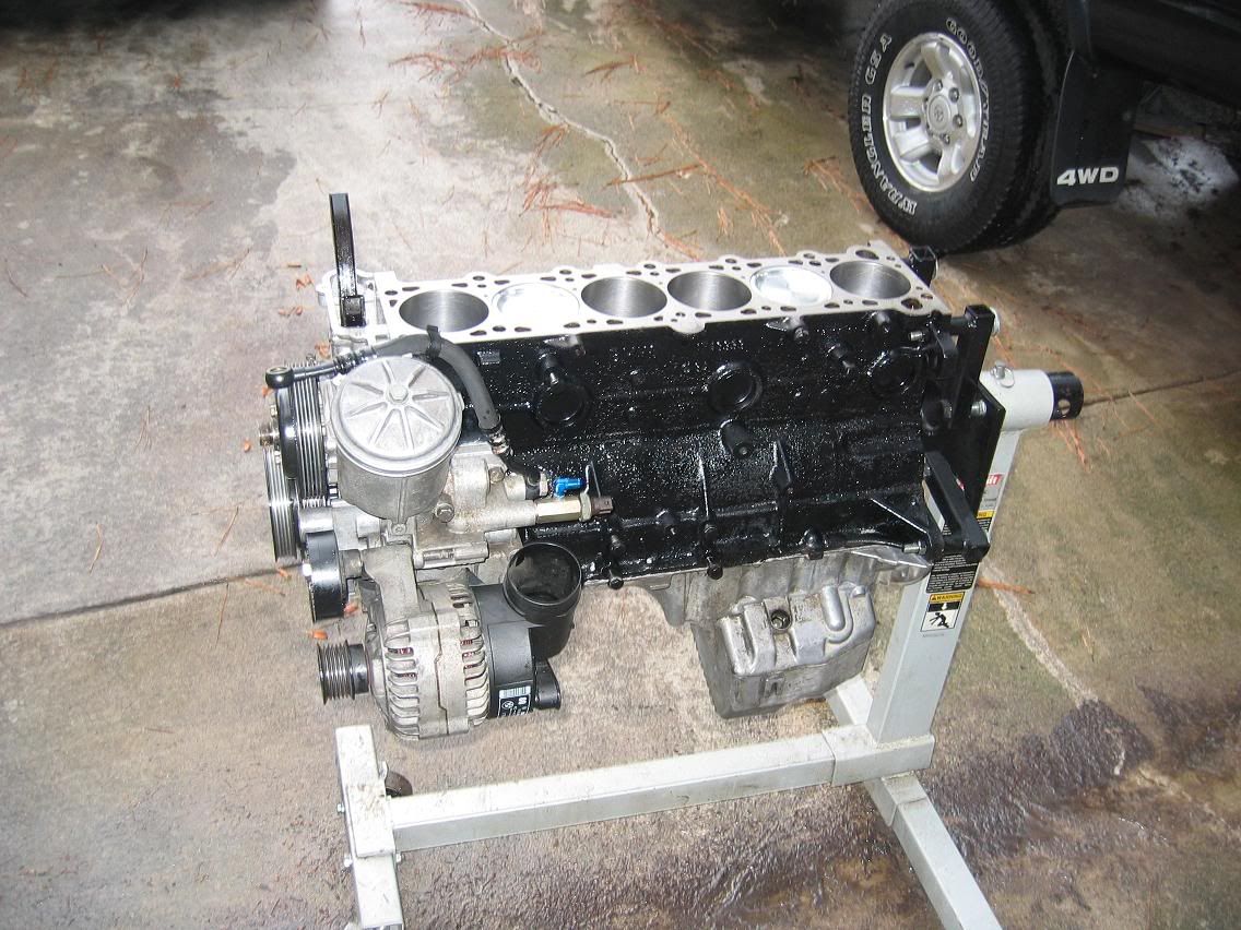

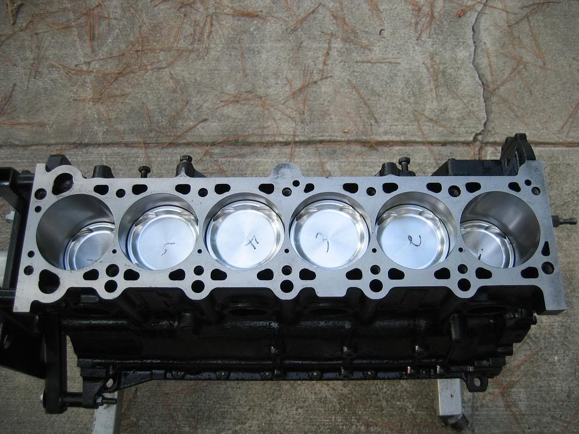

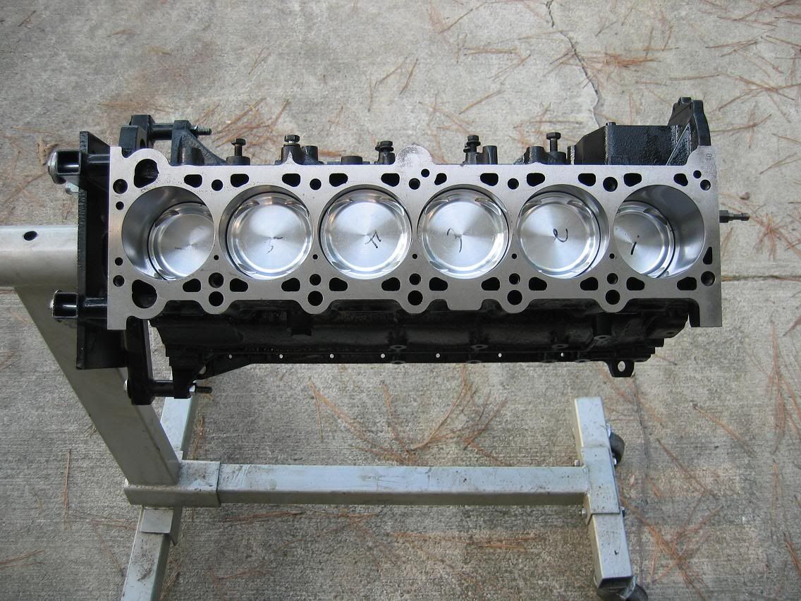

    Pistons are in
    block coming together really nice.

    wow.. very nice!
    Why did you deck it? I imagine for the purpose of leveling the surface? Aposed to increasing the static CR like the NA guys do? Fill me in

    Quote Originally Posted by Danny
    wow.. very nice!
    This is what i want to do next summer.
    Are you still keeping your tec3 setup with custom tune? I know u told me, but who tunes your motors?
    yes Decked for leveling of surface.
    keeping tec 3. will be going to ED at balanced to get tuned.

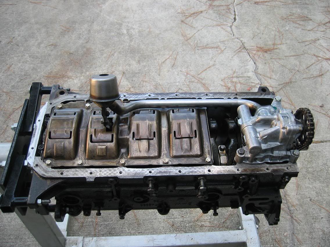

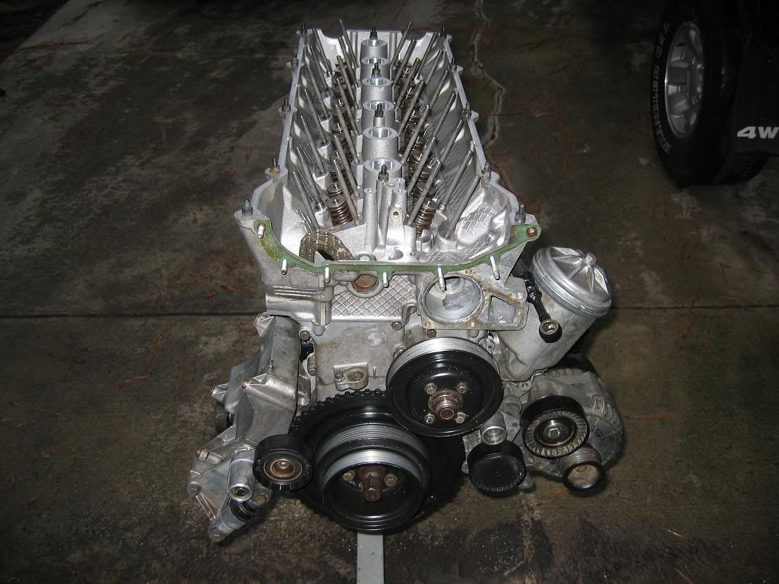

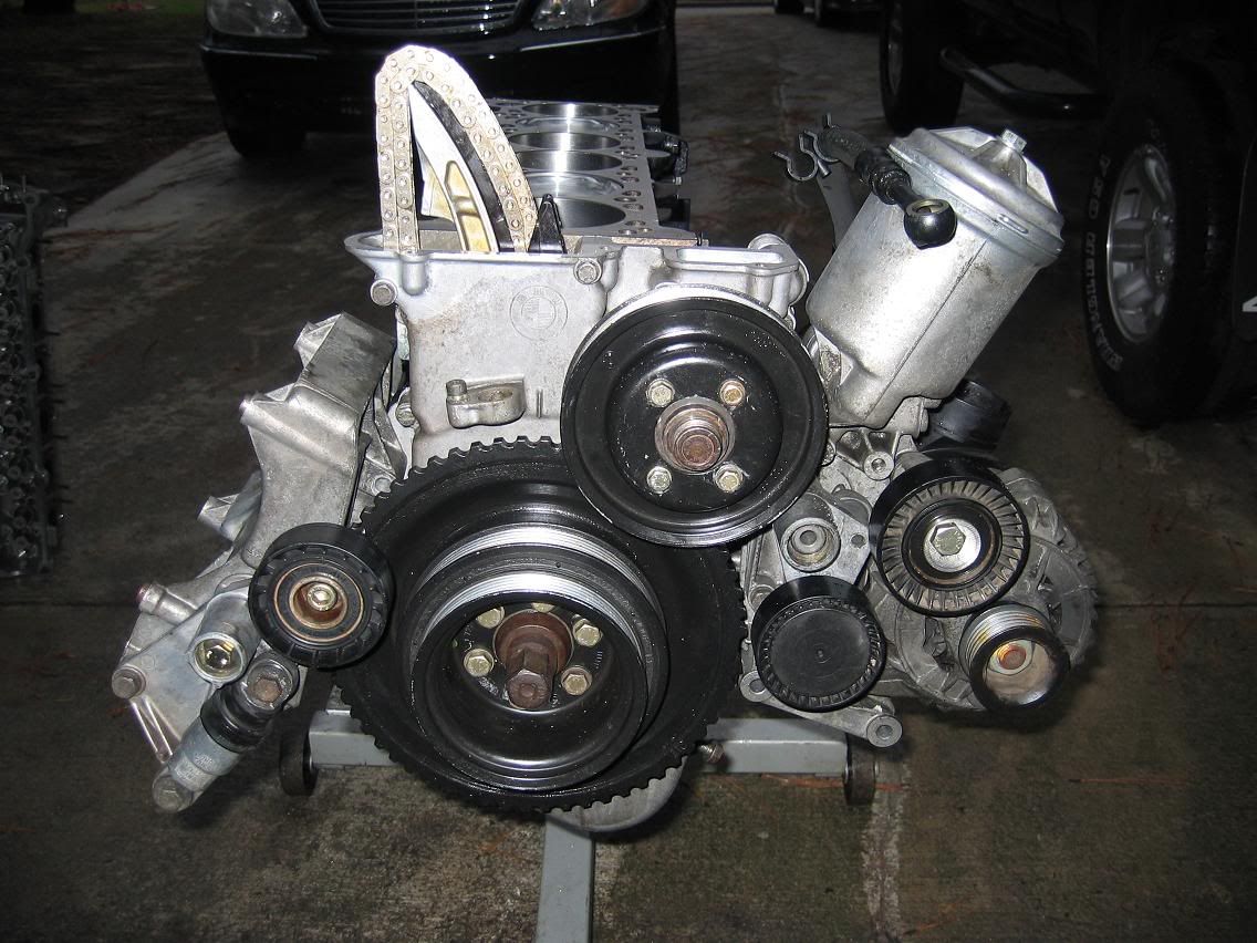

    block and head are done. ready to drop back in now.
    mm mmmmm cant wait. till next wednsday
