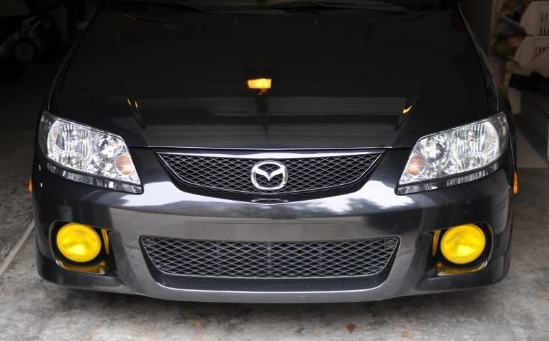

    Hey Guys.
    What about Fog lights?
    I am not talking about crazy colors. I am talking about yellow.
    I know some cars comes/came with factory yellow fog lights (IS300, GS300/400...)
    Their's are rather small though compare to mines.
    Do you think I am risking anything by using them? I've installed the films last week but I have not used the fogs yet.
    I don't really plan on using them anyway. It's more for 'looks' than anything else.
    Thanks.

    Looks......like shit being that big on that car.
    Opinion aside, the same thing should apply to foglights as well as headlights.

    yellow fog light bulbs are legal in the US, however yellow films are not. Most (and I use this term very loosely) fog lamps are SAE complaint. Any modification to an SAE complaint lamp makes it non-compliant. But, you wont get hassled for this. They are nonoffensive and most LEO are not aware of this law.

    um...i got pulled for this, yellow fog lights. its BS, got a warning, but said if i get caught again $200 fine...personally, i'm not changing it. the car sits most of the wk anyway, its no use for me to do it

    if you had a DOT complaint yellow bulb in a DOT compliant fog light, its not illegal. If you get a ticket, the officer is wrong.
