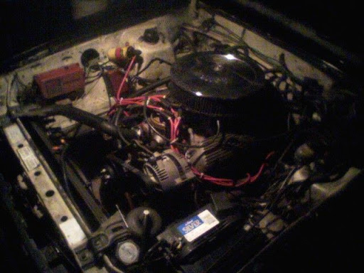

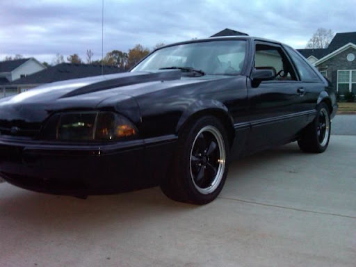

    I need some help here. I'm going to look at the car tomorrow and I know nothing of Fords.
    Some more pics.
    My concerns:
    Cheap Paint job and rust/ bondo
    Is it really a Ford Racing 302? And How can I tell?
    How streetable is this?
    And do you guys think I can get more out of it than my Lude. I may just sell it after I get it if I can make some $$$ off it and get what I want.
    And if I like it, I'll keep it and get something else to Daily. I've never been a Mustang guy (or Ford guy for that matter) but I'm pretty open.
    Give it to me straight. I'm a Honda kid and I lost track of American Cars a looong time ago.
    REPS for good advice. I needs it.
    Projects
    8,743

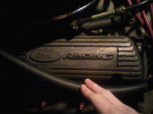

    That would be a LX 5.0 stang the valve covers are aftermarket just says ford racing and yeah it looks pretty well built and put together.
    It being bored over and with the 650 carb in a 89 then id think is was originally a 4cyl body
    Certified Gearhead iamdallas's Avatar
    Aug 2010
    845
    So not what he says it be, basically? That's my problem... I'm completely ignorant of Ford stuff.

    To answer a few things mentioned in this thread.
    Was it a 4 cylinder swap? Doesnt matter, outside of the 8.8 rear end, theres not much benefit to actually having a GT. The 4 cylinder cars ride much better, they have a longer spring, most GTs swap to 4 cylinder springs.
    Ford racing crate motor? You have to take every mustang at face value, any mustang owner whos ever changed a head gasket claims to have some type of "crate" built motor. "gt40" heads... another name people throw around loosely, means very little. gt40p heads are factory explorer heads. Im not sure why claiming this became popular... i guess people saw gt40x turbo swirl heads in a summit magazine and got mistaken.
    rust and bondo? not a problem fox bodies in the south have. unless you see anything on the rear quarter or roof, not something to worry about.
    How streetable is it? depends on the carb mainly, a .5XX lift cam is pretty streetable in a 5 speed car, thats right at the thresh hold of what mild mannered people think is streetable. A good carb can make or break an old mustang, with a shitty carb its going to be annoying to start in the morning. It's surely not something thats gonna be too "race car-ish" on the streets as i would guess its a sub 300hp car looking at it.

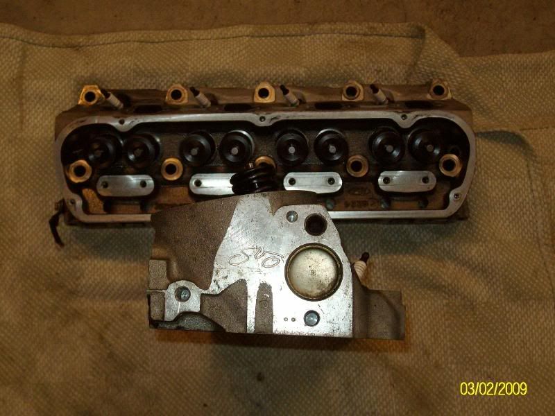

    So far all I have to verify are the head and the rear end swap. From what I've learned online the explorer heads are cast with gtp and real gt40s are cast with gt with some other small markings. I'm assuming the aluminum x's are, well, made of aluminum and cast with a gt40x. I hope it doesn't still have the 2.3 radiator.
    Any more concerns/ things I should I should have about the swap? Suspension etc.
    Columbus GA
    11,435
    If the heads are GT40x, they will be aluminum. It's pretty easy to look at the head and see if its aluminum or not, will also have a label on the front of it like the picture below. Theres nothing really to worry about with the 4 cylinder to 8 cylinder swap, the only significant part swapping is the rear end from a 7.5 to an 8.8. Even if the car does have a 7.5, thats something you wouldnt even notice until you got into drag racing. You would never tell the difference on street tires. I can see from the picture that it has a 2 row radiator from a v8 car.
    If the heads are GT40x aluminum, that definitely puts the value of this car above your car seeing as how aluminum heads are one of the more distinguishing mods you can do to a 5.0. That would almost put it in the "too good to be true" range on him wanting to trade for you car though in my opinion.
    The only real thing to decide is how easy to car is to drive in your opinion. does it start up easy? is the throttle smooth and responsive? things like that. if it does have aluminum heads, id say trade 100% because its easily worth more than your car. It's probably worth more than your car even if it doesnt. Unless you can find something thats clearly wrong with the car or if it runs like shit, it should be easy to resell for at least your prelude asking price.

    Anyone know how to id a ford racing block?
    Columbus GA
    11,435
    Quote Originally Posted by iamdallas View Post
    again, most every mustang owner thinks anything is "Ford racing" most of the engines you buy from any type of performance distributor are just remanufactured OEM stuff. So in that regard, identifying the block has little significance. As far as iron blocks go, you cant really tell unless you run the serial numbers. There's some variance in the quality of the block based on the nickle value of the metal used. blocks made in different time periods had different nickle values as well as ones made in other countries. The mexican 302 was better than the states one and the 70s blocks were better. Not something someone with a street car will ever care about. What block is in it just doesnt matter. That car is not pushing the boundaries of any 302 block, even the cheapest worst one known to man. generally the only question asked about a 302 block is if its a roller cam or not. Doesnt matter too much either way, they just have different valvetrain components.
    a REAL "ford racing block" the R302 is aluminum also, easy to identify. Picture below. They just dont exsist in street cars. Anyone who cared enough about blocks to purchase this block would have a much nicer car than that one and it would probably be in the 10,000+ price range.
