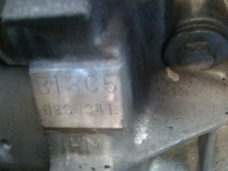

    alright guys, i would like to share with yall my current build- sry for horrible pics- iphone ftl
    1996 civic hatch
    -B18c5 type R swap with LSD
    rmf rep header
    p30 pistons
    2ply hg
    acl race bearings,arp bolts,studs
    untuned Hondata s100 (chipped p28)

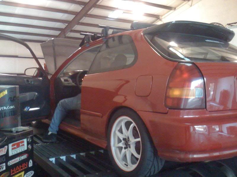

    car baseline at 165whp on dynojet at mainstream performance...pretty low i know..

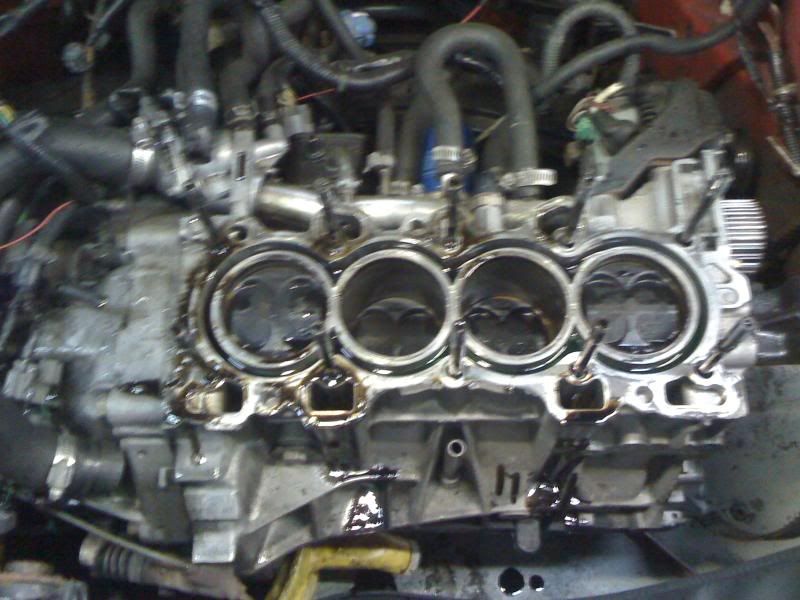

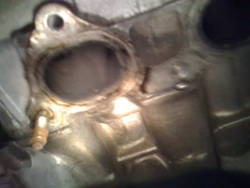

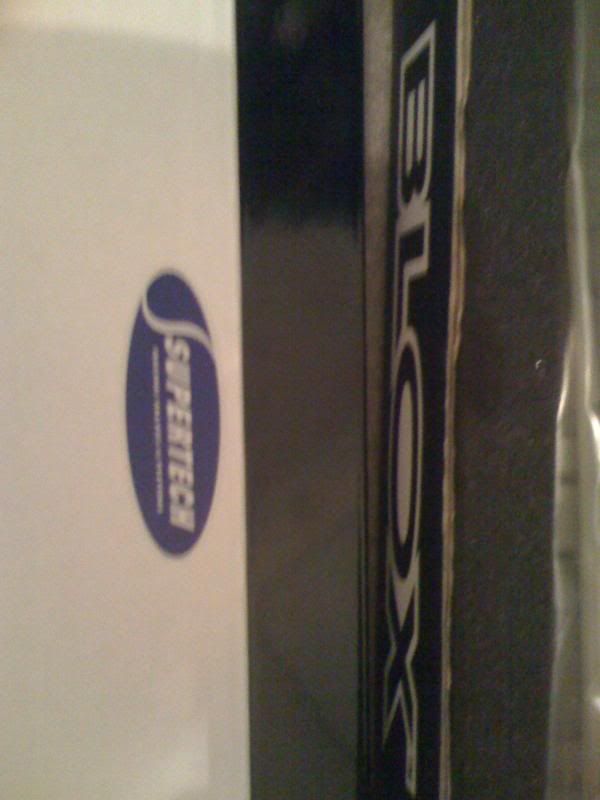

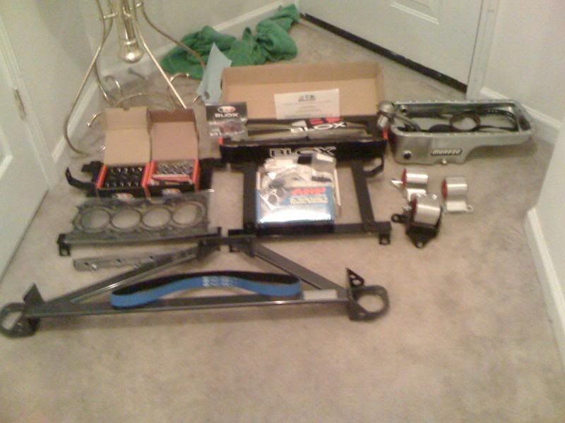

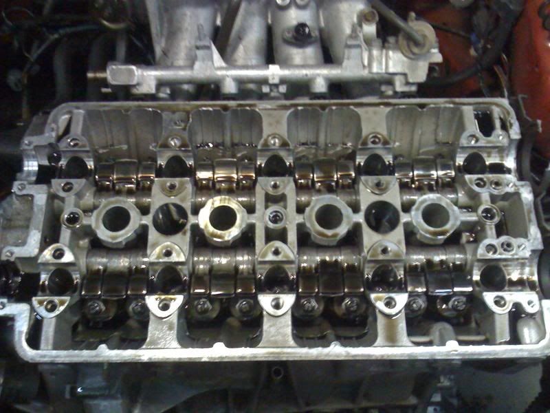

    TIME FOR REBUILD- TOP END FOR NOW

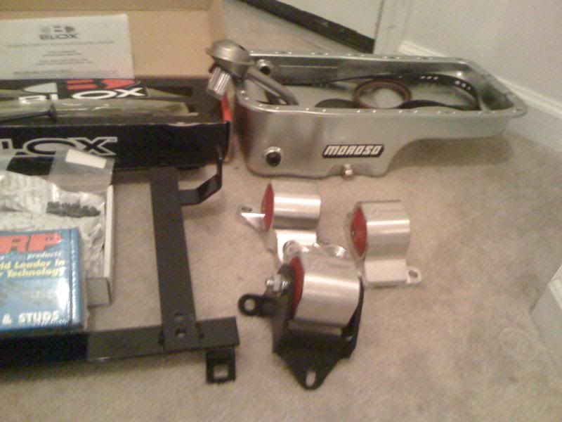

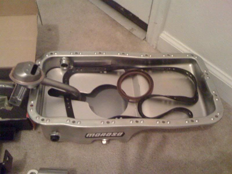

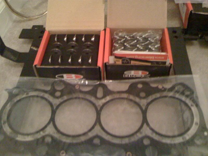

    new arp headstuds,blox cams+valvetrain,supertech high comp valves+valve seals,ferrea valve keepers,moroso oil pan,b18c5 pickup tube,innovative billet race mounts, 2ply high comp headgasket- professional products fuel rail,fuel press reg kit, blackworks 6 bolt cam gears, cam seals, etc etc

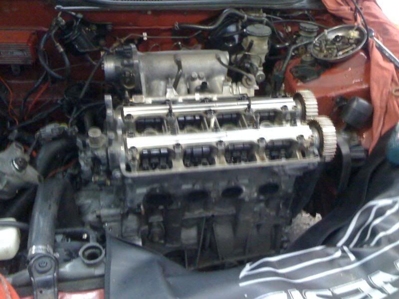

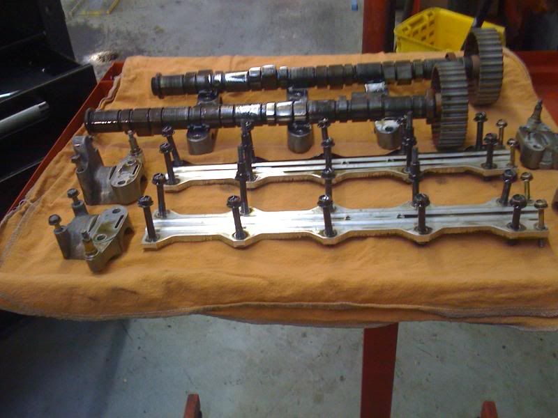

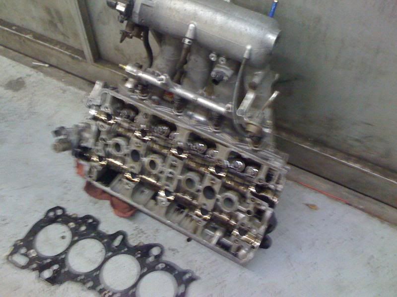

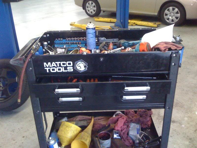

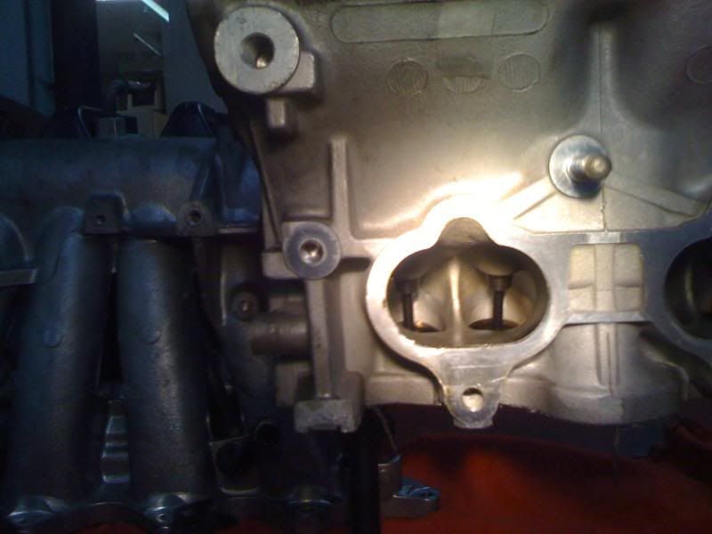

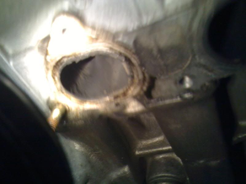

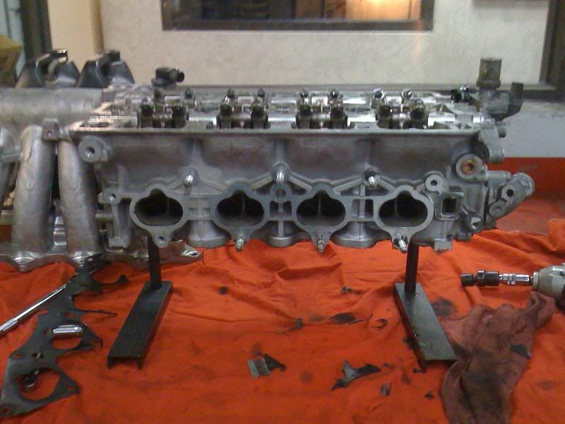

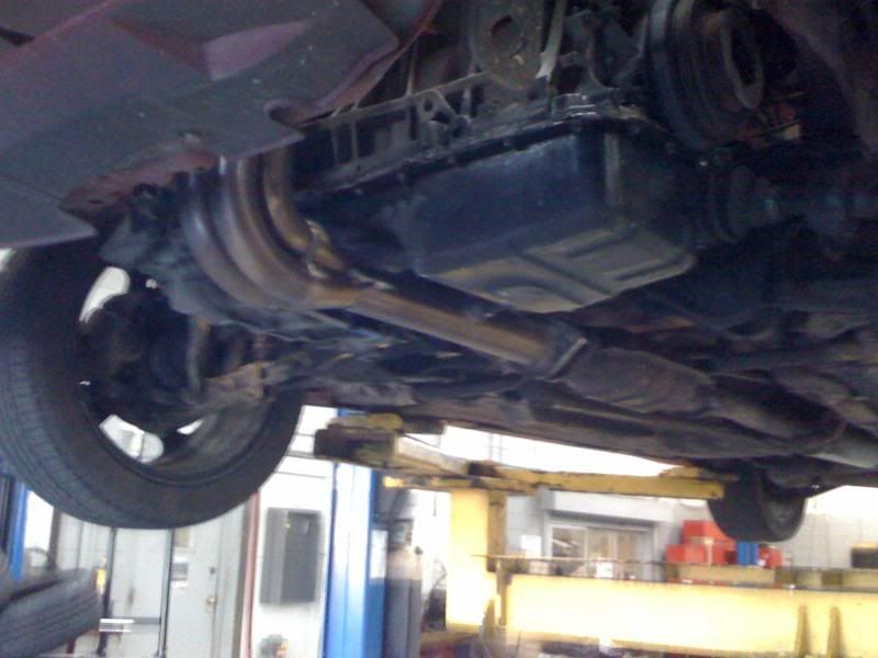

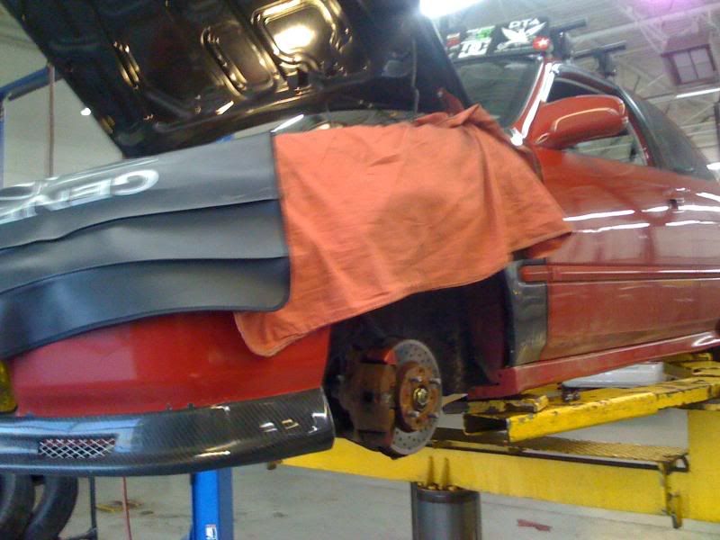

    heres the progresss tonight so far.... stayed late at work and removed head.. will send to machine shop for cleaning,resurface and pressure testing.. also took some pictures of my tool box- enjoy guys. thanks

    looks good. only thing i would change is the cam gears

    Don't really need the fuel rail but it looks good. Nice to some1 get a baseline before their changes too - not many people do that.

    Need to degree the cams in to make the most powuh.

    nice parts, what machine shop do you use?

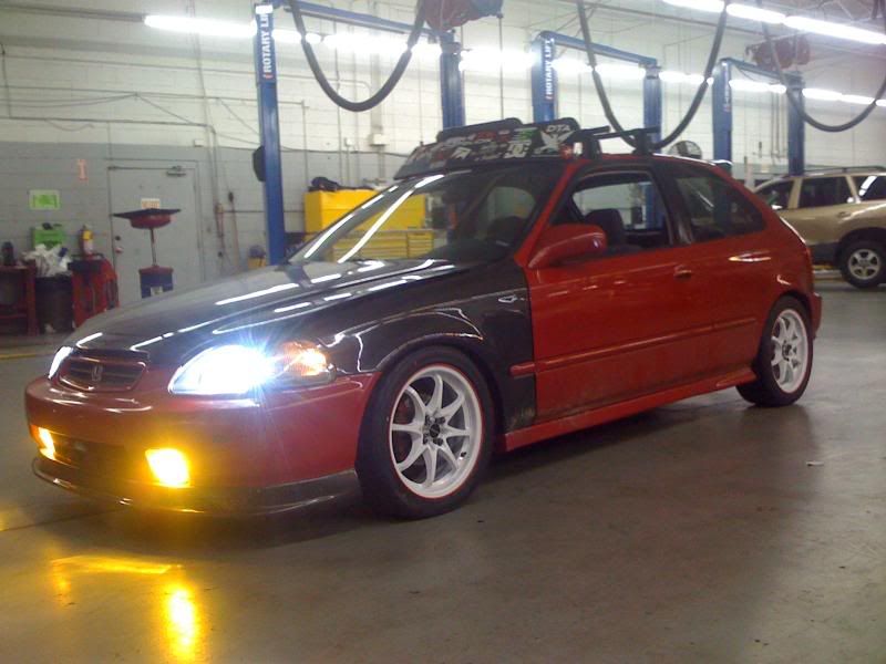

    Got some nice parts there. I would have cleaned and painted the engine block.

    Magnetic tray FTW!

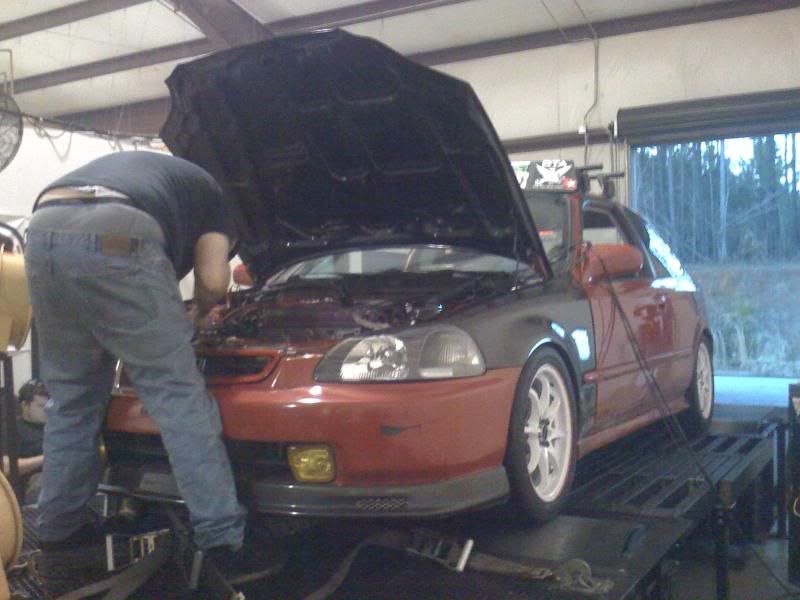

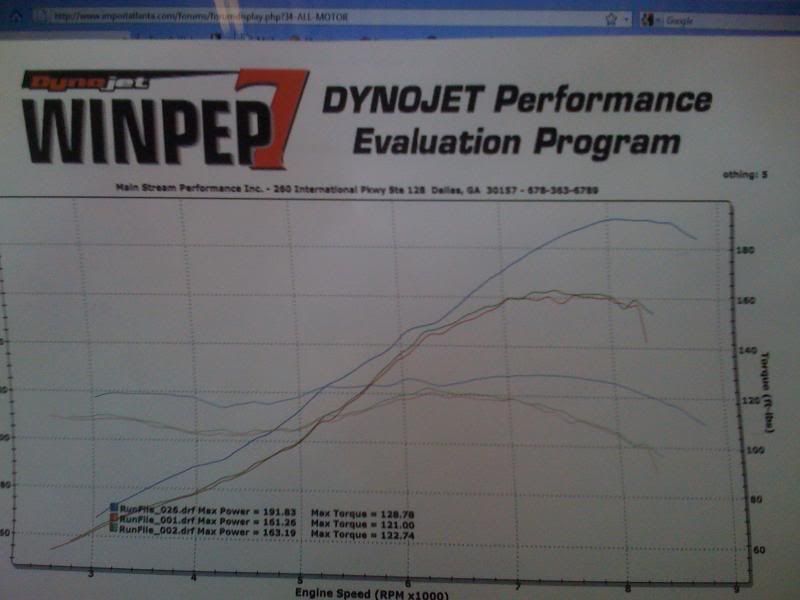

    ok after a few weeks she is now running- need to take to scotty asap for tune- awaiting his call....final comp ratio is 13.0 ish according to calculator...
    KiLLa K
    acworth
    106

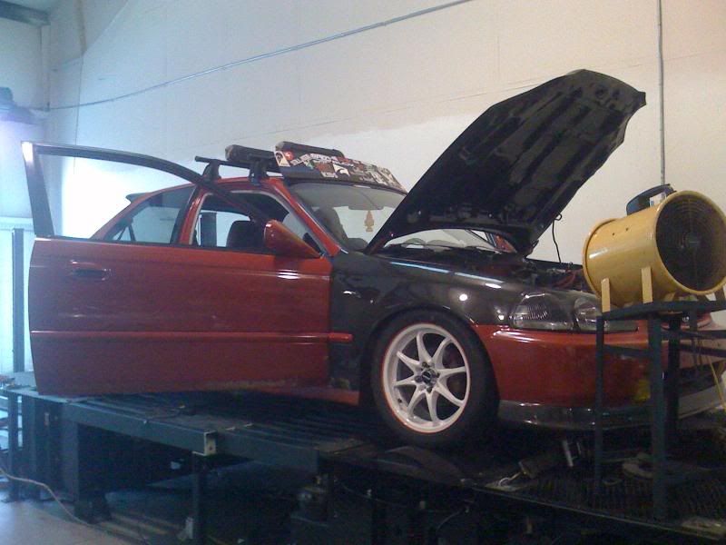

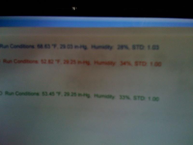

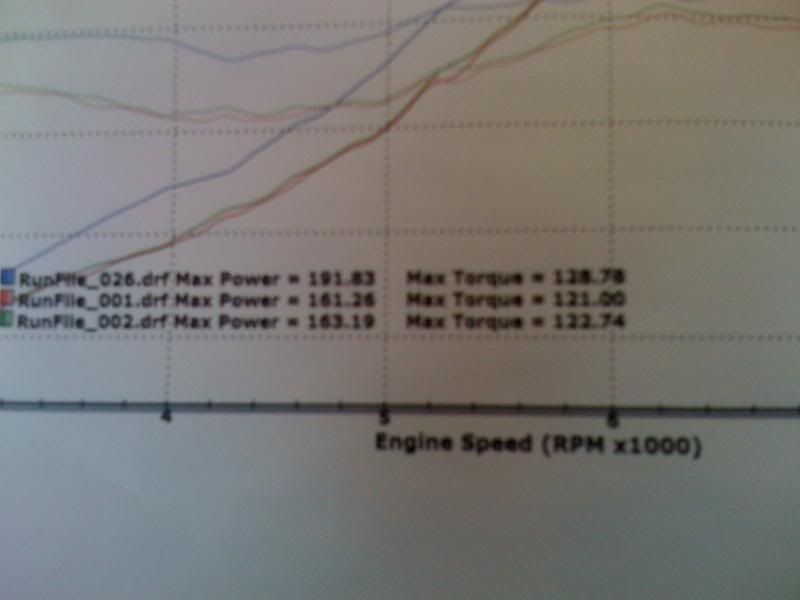

    final tune- 192whp 128trq- new IM,exhaust,tb come summertime- retune-- thanks scotty and mainstream-

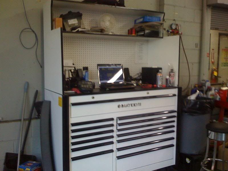

    nice thread. what kind gas are u running>? you said it went 13.0 comp right?
    btw nice shop whos is that>?

    93 PUMP GAS- MY WORK IN SMYRNA

    Thats all you made????? Damn..

    if you look at the top end @ 8k you can see it flatten off hard. major restrictions. we've discussed and he's going to make the changes to make even more. the biggest thing is the difference it made from baseline.

    7,047
    Not bad, sucks to spending a whole lot of money for close to 30 whp though huh? Not hating at all cause I've been there but yeah that's the name of the game.
    KiLLa K
    acworth
    106
    Quote Originally Posted by KevinT707 View Post
    LOL... KEVIN ... HONESTLY I SPENT CLOSE TO 1500 INCLUDING TUNE....FOR NA..MOTOR- I DONT THINK IT WAS THAT BAD...
    7,047
    Right, and that sounds about correct. I'm not saying you spent $5K but for real power like boost you could spend more and make 2-3x more power. I'm tired of the N/A thing, if I ever get a chance it's bOOst time!

    *Edit: Roof rack is super ghey.
