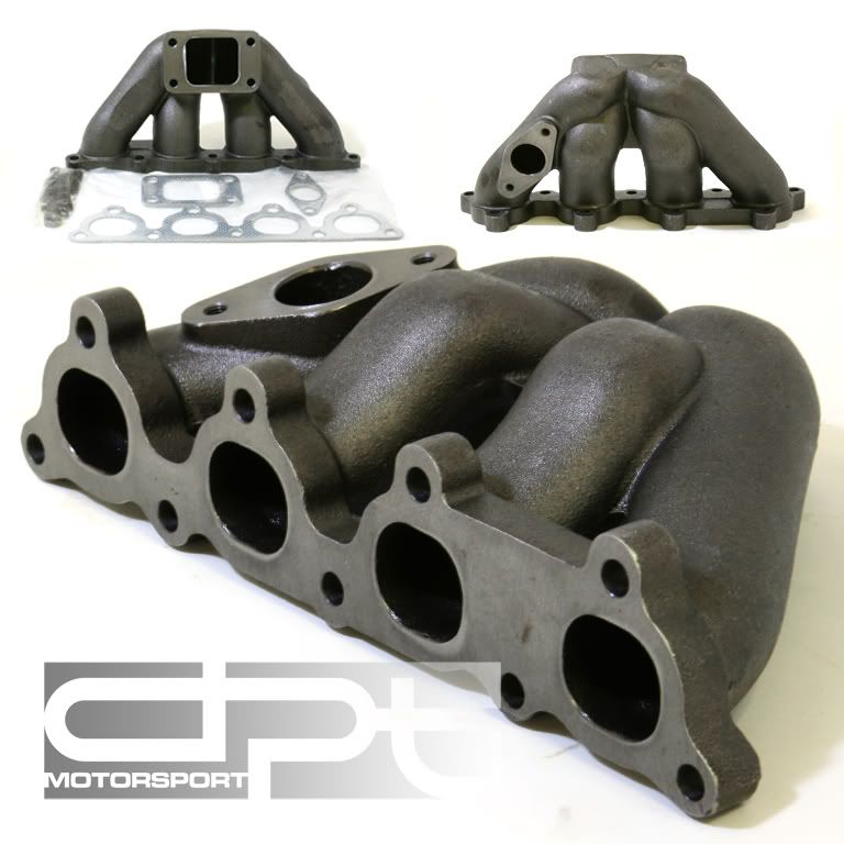

    can i run A/C with this manifold and a slim fan ?
    known as Charles
    Douglasville
    848
    Full Race doesn't make a A/C comp for the dseries just the bseries and even then you still have to move some stuff around (have one here now). The cast one you have picked will work but will be a little tight on the condensor and rad because of how far away from the head the turbo mounts. Also, the wastegate dump tube will be a little difficult. Your best bet would be a log style cast manifold.
