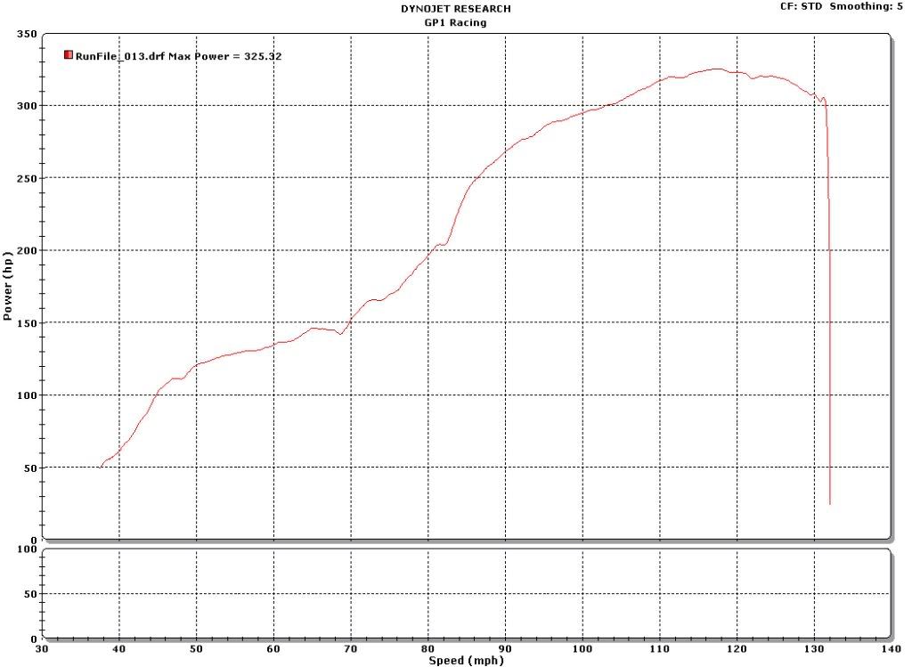

    this is one we did at mainstream. k24 w/ k20a2 head, 11:1 comp, rbc intake, custom tri-y header, s2s3 cams, s2 tb.
    here are some other examples:
    1. skunk2 did the same build inhouse at 11:1 and made 254whp/191wtq.
    2. six sigma did the same build w/ full k20a2/itb's and made 253whp/171wtq.
    3. eriksracing did a k24/k20a2 at 13.8:1 comp, rbc, ported head s2s3 cams ssr header and made 330fwhp/237fwtq...should be in the ballpark of 280whp/195wtq.
    4. church automotive did the same build as ours w/ 12.5:1 comp and made 307fwhp/224fwtq...should be in the ballpark of 265whp/195wtq.
    5. stage3 did the same build as ours w/ 13.7:1 comp and made 292whp/220wtq.
    based on these examples i wouldn't say itb are all that and certainly not the best option if you plan on still daily driving...it can be done, but these examples can give you ideas how you want to proceed.
    Attached Thumbnails Attached Thumbnails -jaysrunsgraphs_1-jpg

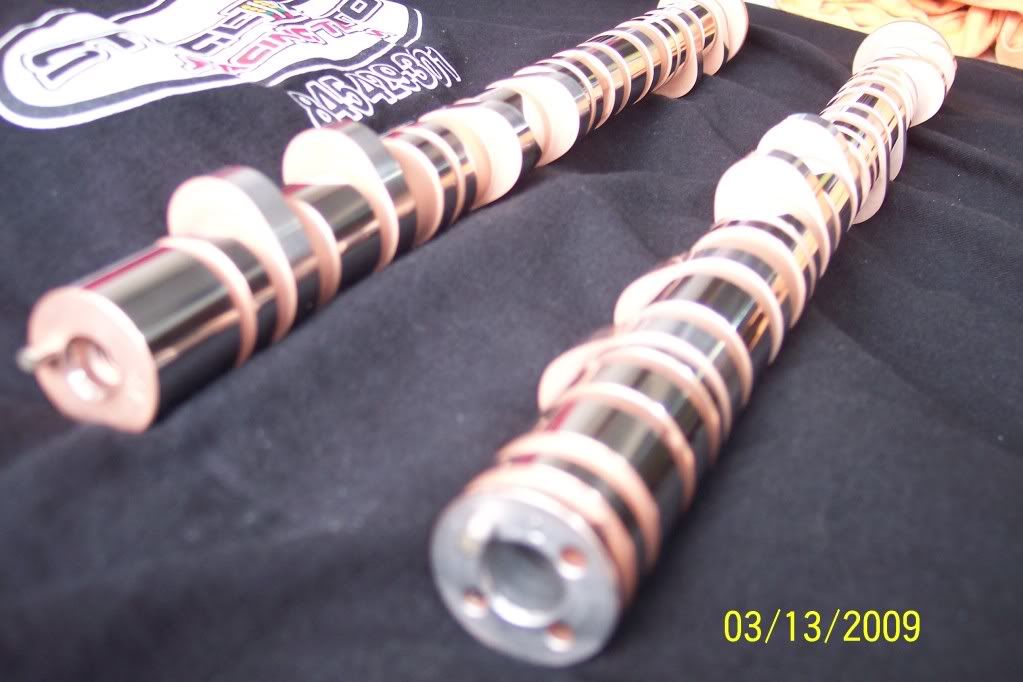

    hytech k-swap header and IPS k10 or IPS KXV cams
    and eagle rods and s2s3's.
    but what about the ips k2's?
    416
    ips k2 are for a stock motor if your building a motor i would step up go with IPS k10 or KXV.... but with the KXV make sure you have a deep enough valve relief to run 50 vtc.
    cams to choose from if you want 300whp
    IPS k10
    IPS KXV
    Drag Cartel Spec IV
    Jeremy Allen Custom Grind

    416
    Those connecting rods are about $700 EACH...
    Why would you think the IPS manifold is not swap friendly? Look at all the free room
    http://www.youtube.com/watch?v=maG96y70QMI
