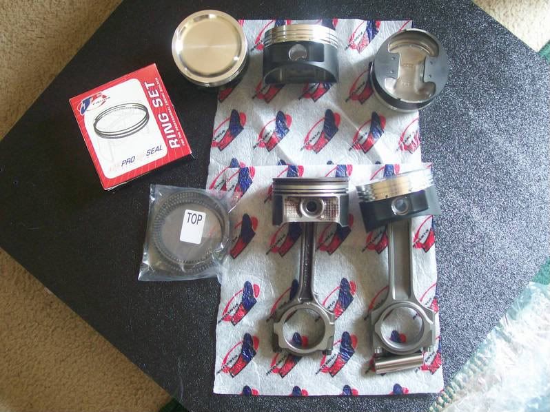

    Anyway, without further rambling, here are some parts pics and a list of components we will be using during the build to achieve our power and extended redline goals.
    Bottom end:
    Crank: 07 8 counterweight
    Crankscraper: Teflon from crankscapers.com

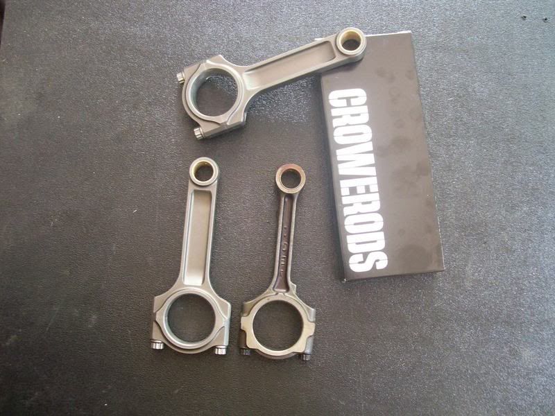

    Connecting Rods: Crower
    Pistons: JE 9:1

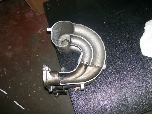

    Intake manifold stuff:

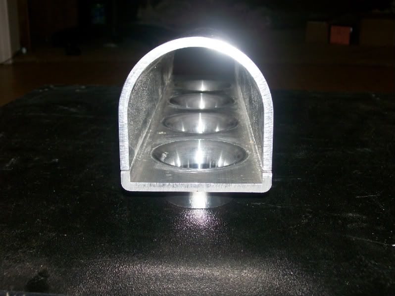

    So much for my break between quarters at school. Stay tuned for updates. The GT30 is going to keep us under the 500hp mark, but 2.5L will have no problems spooling it up.
    Well, off to class.

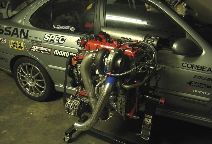

    JDM swaped shortbus Big J's Avatar
    1,110
    look what the UPS man dropped off
    3,894
    damn i cant wait to see this finished
    1,110
    me too, I've been knee deep in this thing for months now, we've got a lot of big companies on board providing parts and support.

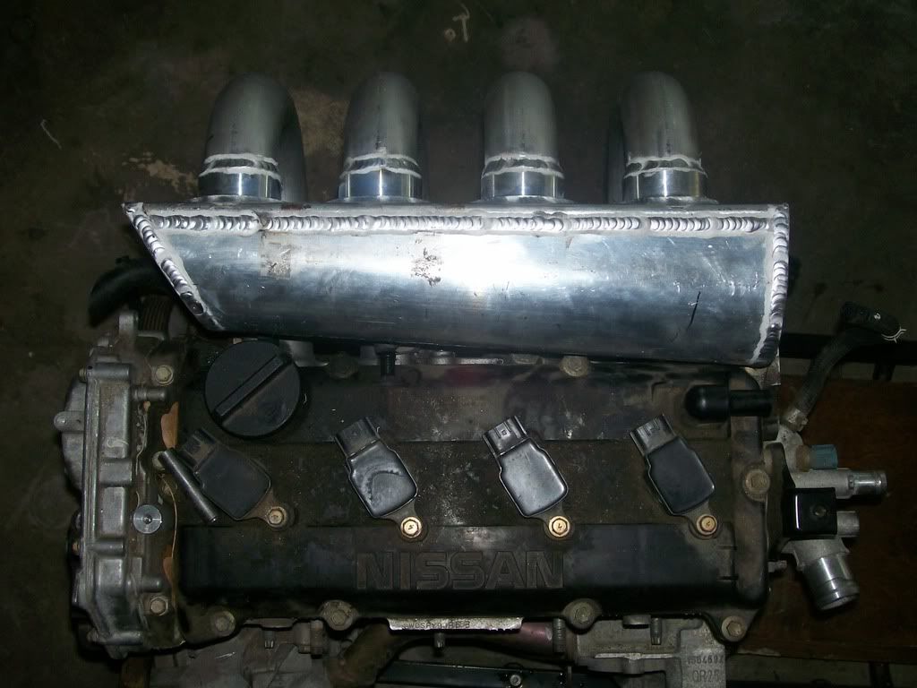

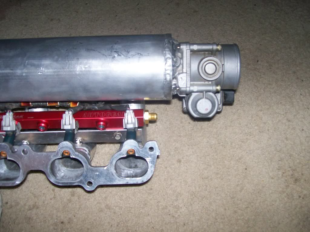

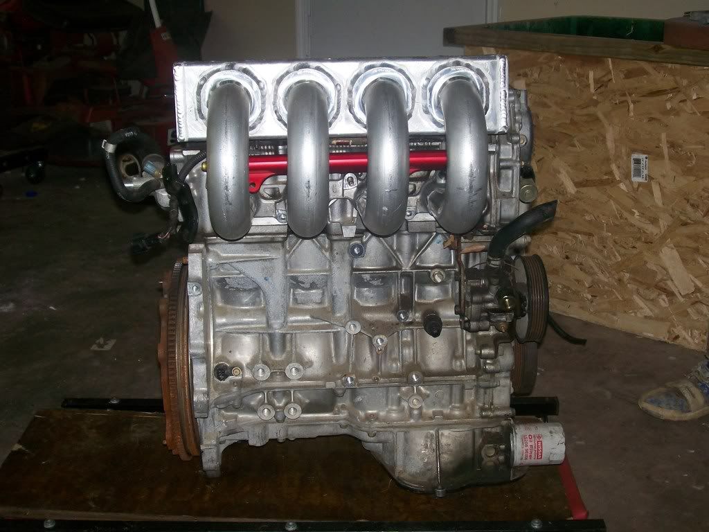

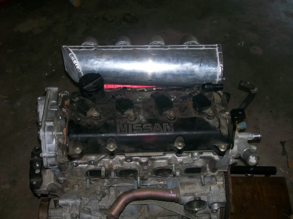

    Did what I could today, should be welded up Monday or Tuesday after I square up the cut edges.

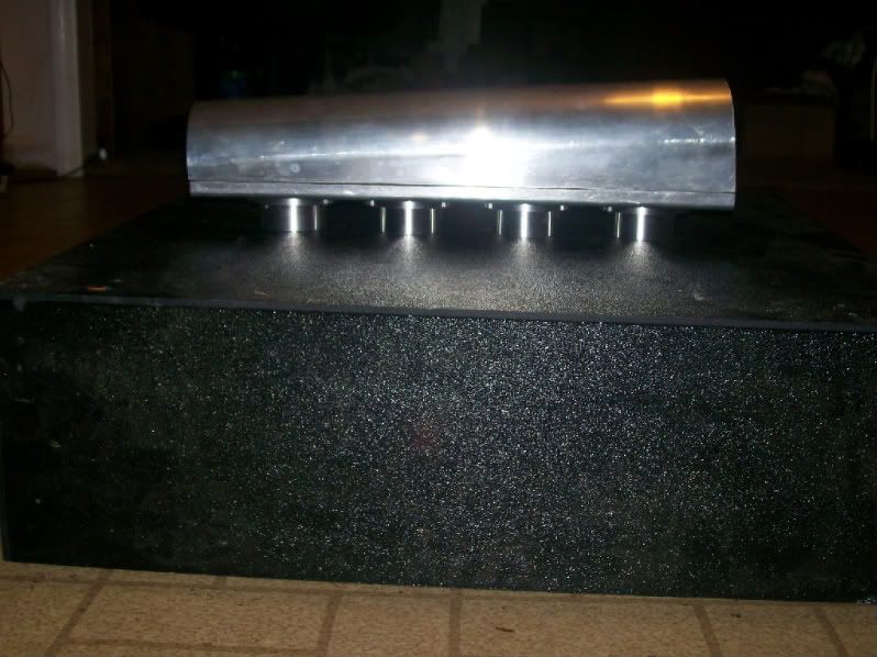

    1,110

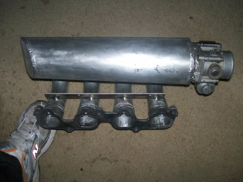

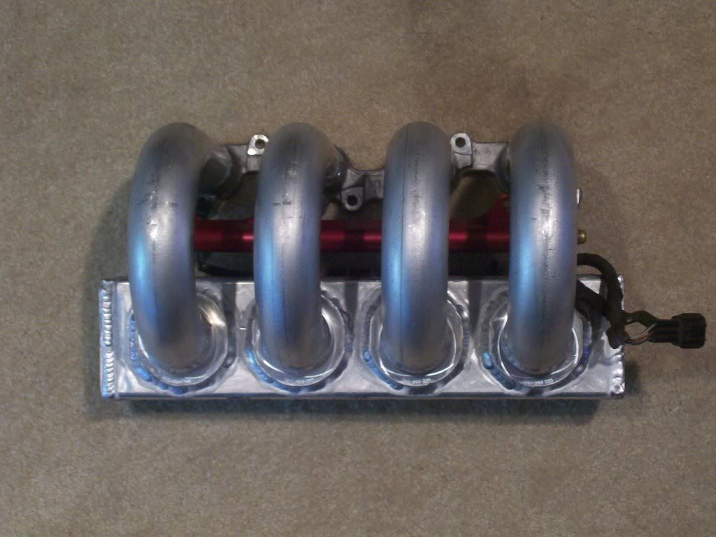

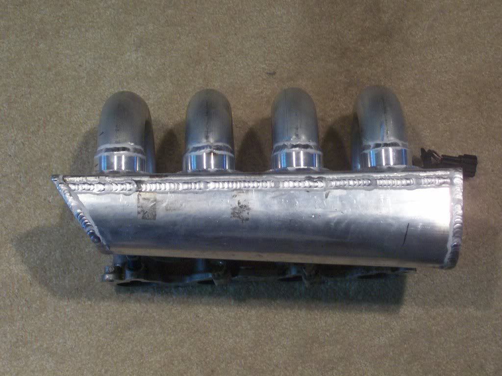

    Intake manifold should be getting stitched up today.
    1,110
    enjoy, big props to Lasertech Metal Works in Fayetteville for putting up with me on an increasingly regular basis, lol.

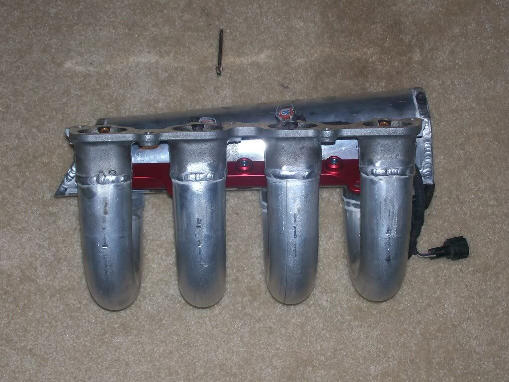

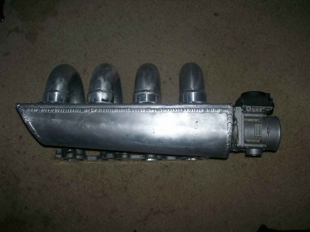

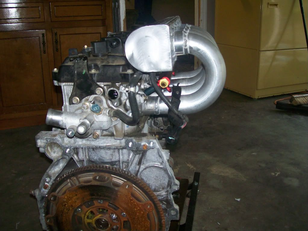

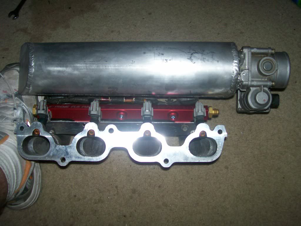

    we'll just call it done, with the exception of drilling and tapping for vac fittings, and smoothing the TB inlet taper some more
    1,110
    No one makes jack for this car, except headers, CAI's, exhausts and there are a few cam choices, and 2 turbo systems (one of which was outsourced to me to do), so basically if you want parts, you have to make them or custom order them, because not many companies want to.
    this intake should move a lot of air and work well with the cams, turbo, and new redline.

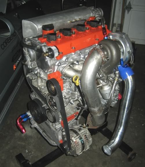

    1,110

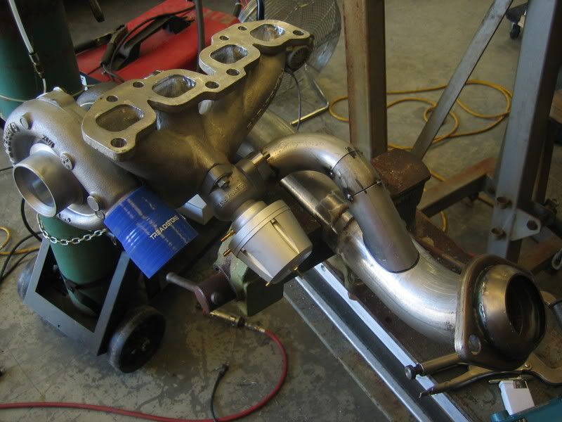

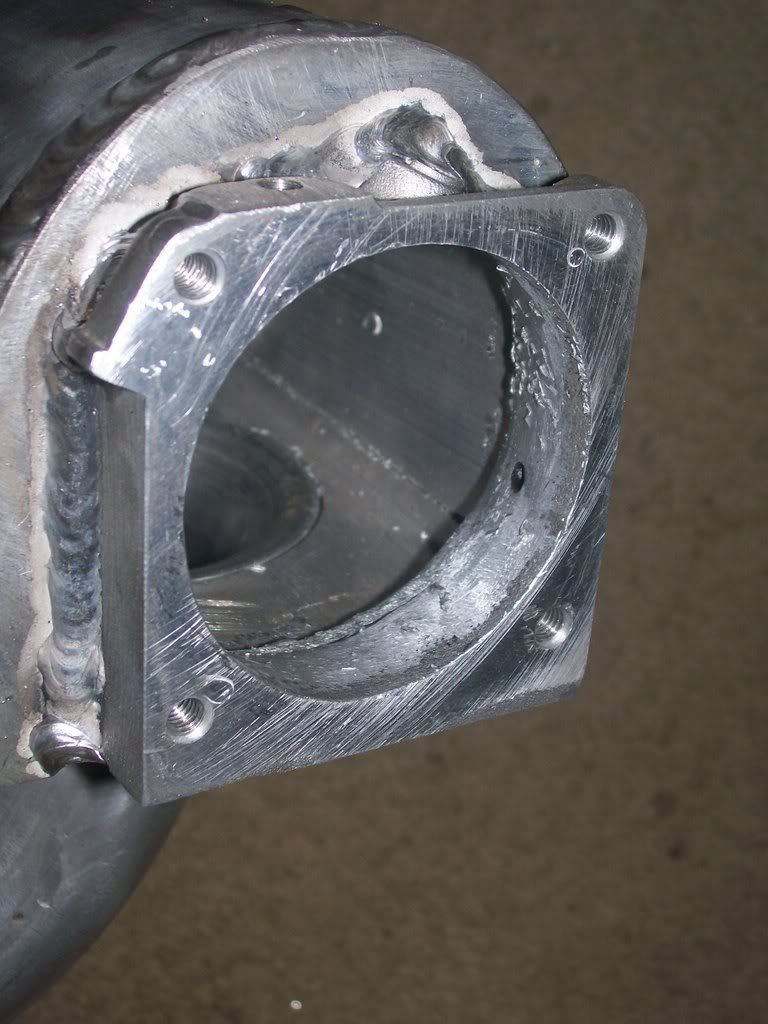

    A little Big J 3" downpipe action and alternator relocation

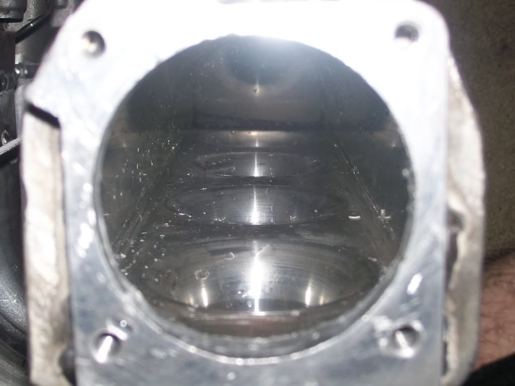

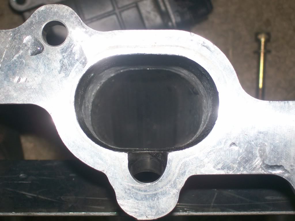

    well the flow bench numbers look really good............ stock is around 213 cfm on the intake side @ 28", after extrude hone 241 cfm @ 28" on the intake and 196cfm on the exhaust side.
    I ported the **** out of the cast turbo manifold and we've got a full 3" exhaust now, that w/ the custom intake manifold, big cams, and .82 a/r exhaust housing........... this thing should ****ing rip.......

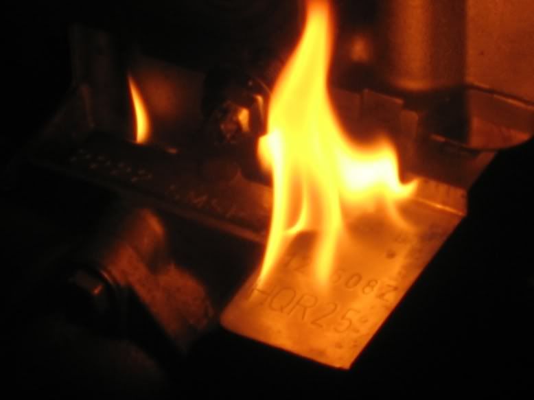

    1,110
    engine porn :boobies:
    (yes, I carved it into the block, then set it on fire)
    (Mike says bring it)
