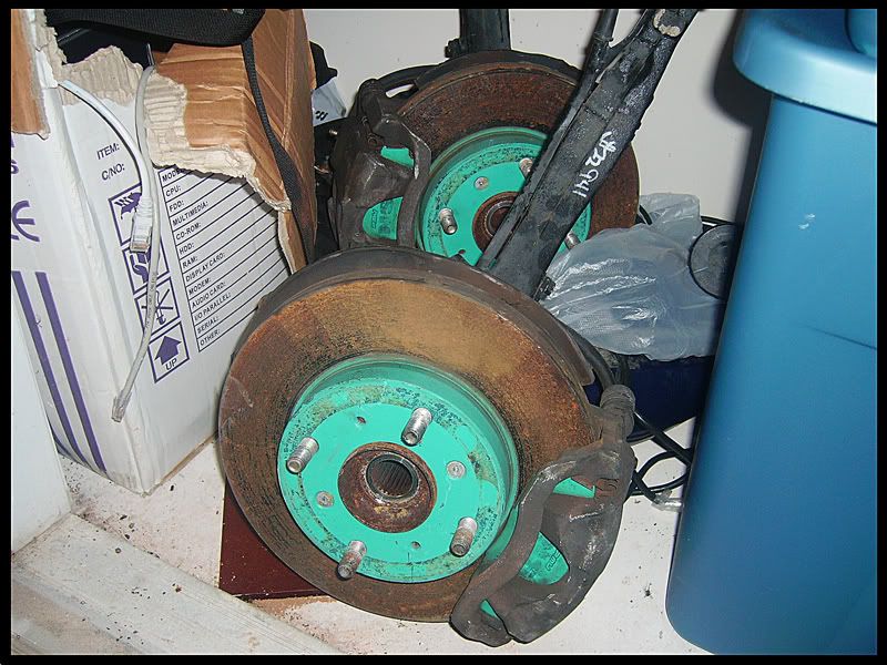

    Okay. i made my trip to JHOT on Friday, got my conversion, and now im ready to ball!!!
    Now here's my question for the mere handful of IAers that may have an answer.
    What parts (USDM or JDM) are compatible with my setup. i will have pictures posted later.
    i need to know...
    in the event i get a stuck/damaged caliper, what can i use?
    in the event my Project Mu rotors and pads wear, what can i get to hold me over till i get up the money for a real replacement?
    I am well aware of almost every vehicle that has the same bolt pattern but NOT everything fits
    thats all i can think of but if there is anything else you guys can think of that i may need to know, please chime in and help a brutha out
