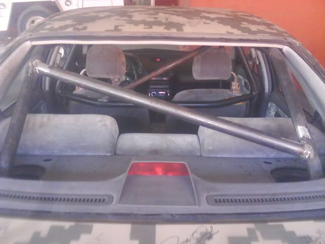

    That car might as well not even have a cage in it. There is absolutely no triangulation. Its just a square cage, aka, junk.

    All those damn bars and he couldn't even fab up a harness bar...what the fuck, over?

    This is a proper cage, now just use common sense and see the difference. The cage in that Honda would probably KILL you if you were in a wreck. Not to mention if he ever took that to a track the tech guy would

    The overall construction and design of the cage wouldn't support the chassis properly if an accident were to occur.
    Roll cages aren't made of sharp bends. This car's "cage" is nothing but 90* bends and welds. That =/= safe.

    NOTHING on that thing is made right, even the main hoop is fucked, look at the cage I posted, and compare it to the ricer one. I'm sure it's not even the right material.

    Here is a rear view of a proper cage.

    ah, i see. Makes since now. well in that case, another reason this is a failure... He put the car on a diet, then filled it with useless bars.
