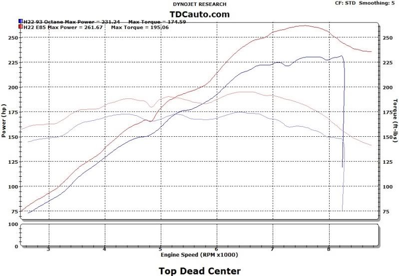

This setup belongs to Adam from NC.
2.4 Stroker
Sleeved Block
Jun Stage III cams
RMF Header (open headers)
Edelbrock 70mm Throttle Body
Custom Intake Manifold
Undisclosed compression at customers request
Tuned on Crome Gold
The blue line is the unaltered Hondata S200 tune it came in on, which was for 93 octane. We then swapped fuels for E85 and tuned it on Crome Gold as seen on the red line.
