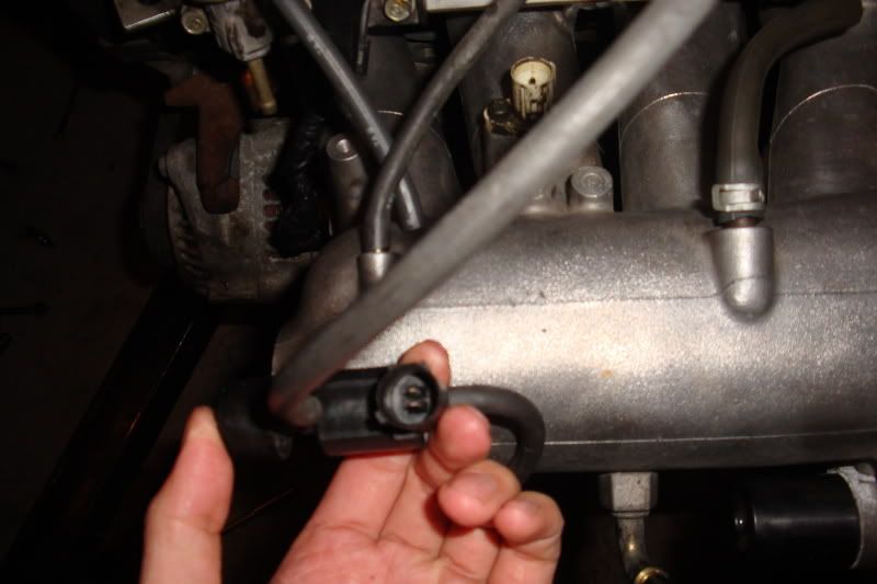

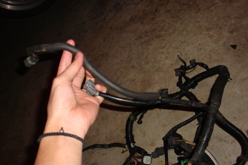

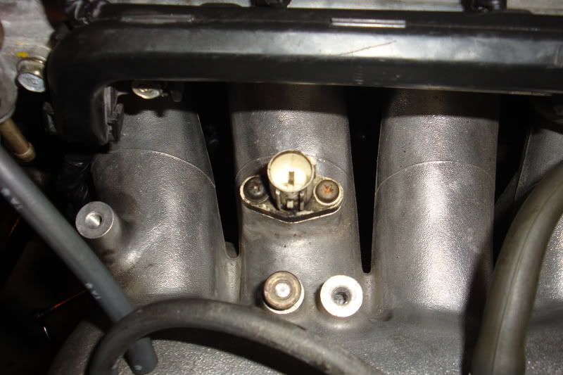

    btw, what two sensors are these? i dont have the two plugs or wires that come off my harness for the sensors. His harness does.
    ^his harness has the two wires with plugs, they look like they were wired into his harness

    2,451
    the one on the mani (white) is IAT
    the black one i think is EVAP/Purge solenoid

    o damn.. how would i wire it up cause my harness doesnt have the two wires that come off it for the two plugs

    7,939
    Quote Originally Posted by NoWAyItZTOMmY View Post
    correct

    how would i wire it up to my harness?
