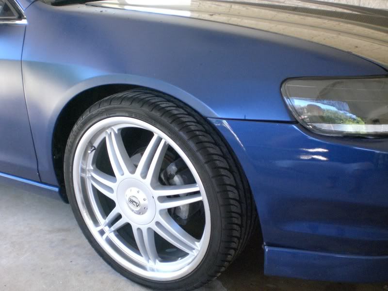

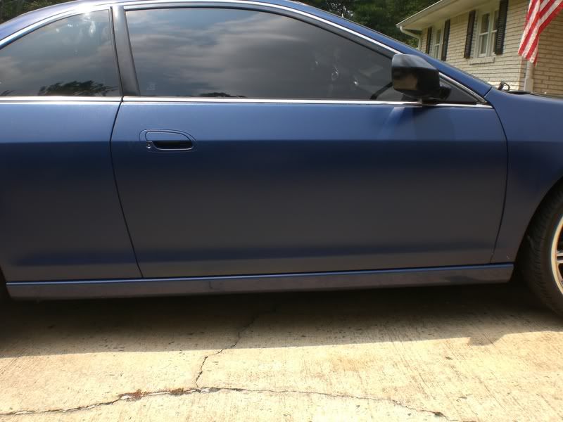

    I got new doors last week,so it was blue car with gray doors..so i decided to try to paint them at the house.
    had a buddy from work get the paint mixed up for me,
    Shop-Line; probably not the best in the world but atleast its blue.
    1st) i sprayed the sides last week *Thinking it was already Reduced like i ASKD* but it sprayed out like sandpaper-looks flat blue,feels like sandpaper.
    2)Went yesterday and got some specialty reducer for all temps, its a 1:1 Ratio, Sprayed it and still goes flat blue,and textured.?
    Any Ideas getting actual SMOOTH base coat?
    spraying with a (1.4mm)Sharp SGF-HLVP,gravity feed
    kinda to show what it looks like and talking bout..and yes 2 clear coats too.. VVVVV
    comparison to what it use to look like before i messed it up..ha bumper>Fender

    How did you prep?
    Last week; 400g on doors, then 800g on quarter and fenders so i could blend.
    Dupont-wax grease remover, Tack-cloth after every coat layed down.
    Then yesterday completely sanded the side down with 320G,Wax grease remover,tack..sprayed

    base/clear. im just having trouble laying the base down smooth.the clear like soaks into the dimples and still feels textured and dull.
    i tryed to wetsand and buff the drivers side last week.
    had to do 1000g to cut the texture down faster,1500 then 2000 and 3000..went through few places...and looks hazy cuz where the texture was are like small bubbles that show through the old color..of that makes since..

    just looks like base doenst looke like it was cleared. even if the base is not smooth the clear should come out shiny
    it has 2 coats of clear,thats what i was saying,the textured base soaks the clear into the crevicest..the end of the fender and quarter turned out best because it was just recleared,no color was shot..but it still has like big dropplets of paint splatterd in it.what it looks like when spraying..
    can i wet sand the base to make smooth..then put clear over top of it?

    not bad for outside work. Wheres the clear at though?
    -Ant.
    edit: so you have clear on there? Just wet sand the clear and buff out to a beautiful shine.

    You said you cleared those panels??? Looks like a flattening agent was added to the clear. How many PSI are you shooting the clear, and how many coats, and how thick are you spraying the clear? And did you mix the clear correctly? Most clears that I have worked with are either 4:1:1. But southern polyurethane universal clear coat mixes 1:1.
    The base coat doesn't have to be that smooth, because base coat is just for color, the clear coat is your glamour coat. BUt if you want the base to be slick then yes you can wet sand the base pref. with 1000-1500 grit wet/dry.
    To be honest doesn't look like you sprayed clear at all.
    (i usually spray clear with a 1.4 and base with a 1.3)
    And you don't necessarily need to wet sand with 1k and work your self up to 3k to buff. At work we just wet sand with 1500 and buff that out with a heavy cutting compoud with foam yellow cutting pad, then polish with 3m finesse it and black foam polishing pad. and comes out perfect. No need to break your back.

    I just sprayed a test panel off my pocket bike..it still has texture but not as bad..and shine..with 3 coats of clear..and 3 coats of base.. ill post pics in a sec..
    2,661
    explain this texture. does it look like dry spray or like an orange peel effect? Maybe your spraying at too low a pressure.

    thats what it soudns like. or not enough material on the panles
    im spraying about 25psi for base..then 40ish for clear...
    but im using the pre-mixed duplicolor clear..
    texture as in,looks like a piece of sandpaper..ha like literally flat blue sandpaper.
    like yesterday when i was spraying,looked like it was just spitting out paint dropplets?
    this turned out alot better than the car..but still has texture and not laying smooth..
