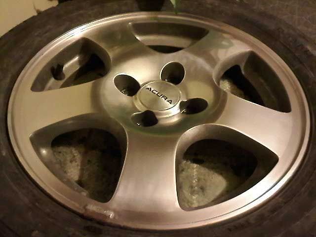

    i have some fat5s on my teg and was trying to sell them but no luck.
    Had the day off from work and was bored, so i started to polish them. I only got one done with the sanding portion. and have a huge blister on my thumb.
    comments welcome.

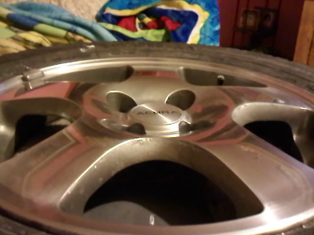

    got done polishing them after i got home from work. found some polish laying around the house
    new pics

    go 1500 then 2000 and buff with rubbing compound, then noxon metal polish.
    learn to english
    2000 was the last one i used
    do need to get the compound to polish them up

    looks like brushed metal. not really polished...yet. put more effort into it.
    like i said i have ony wet sanded them. not completely finished polishing them.

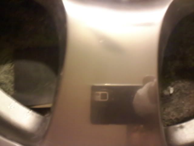

    updated pic

    You didn't take your time, you need to start with at the very least 800 and work your way up
    so the updated pics arnt any better?
    BK ALL DAY
    5,168
    NO... i think u started w a to high of a grit paper... and in ur updated pic its still hazy.. there is no shine to it.. u want it to look like a mirror when ur done..

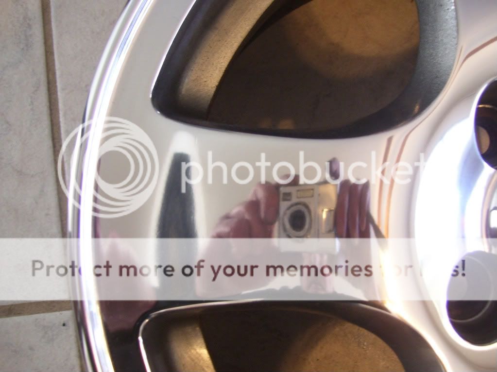

    Here is some motivation.. NOT MY WORK, SOME DUDE ON HONDA-TECH
    Quote Originally Posted by BFJ View Post
    Polished up my fat fives...
    GECKOSquad
    NIKOND7000 Shooter | flickr
    those fat5s are shiney!!

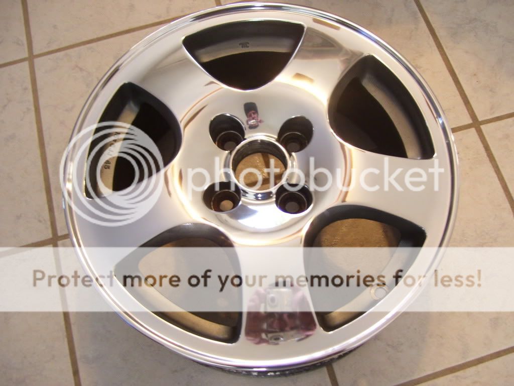

    new pic let me know what you think.
    ホンダ・インテグラ allout13's Avatar
    Dec 2008
    Cartersville
    1,405
    Quote Originally Posted by CautionMeDC2 View Post
    looks great from what I can tell
