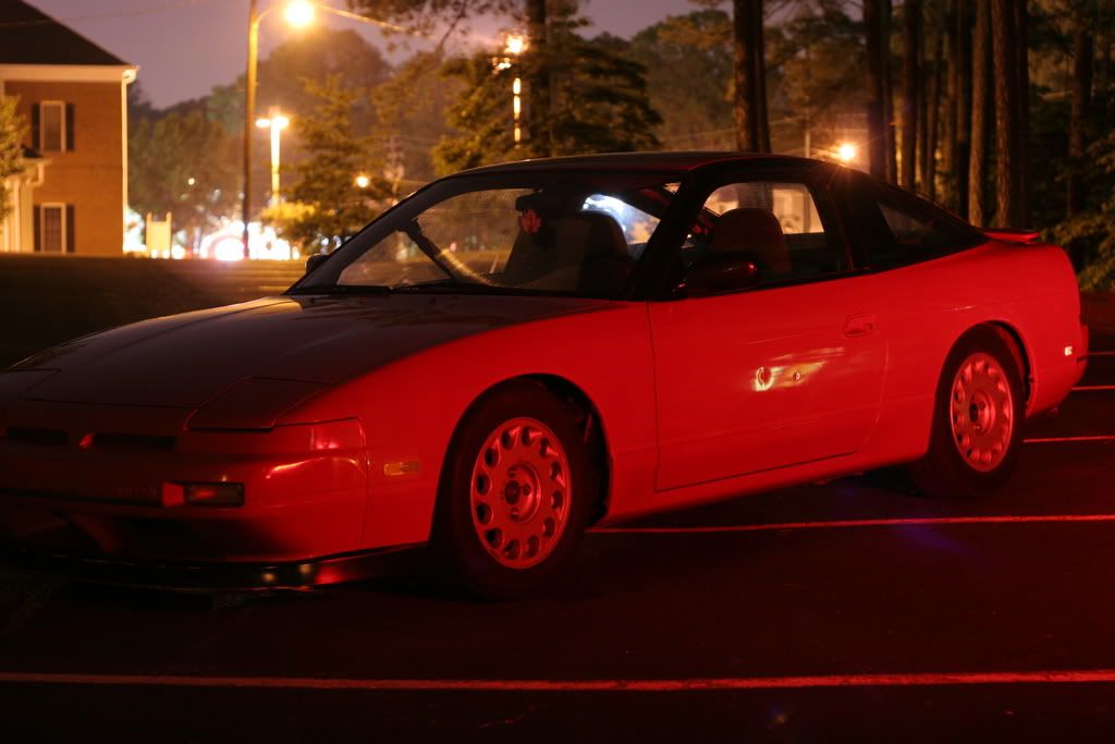

    Now I just need lighting haha. This was my attempt with tail lights back when I sucked more (still suck, but not as much) haha.
    I also attempted some headlight lighting, only problem was it was overexposing and it was aimed too low.
