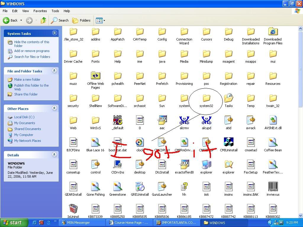

    Where has mine gone? it's missing I know its impossible not to have one but mine is gone I HAD one at one point. But now its missing. I need that folder so that I can put a host file in there. I did a search inside of thw WINDOWS folder for C: \WINDOWS\system32\drivers\etc. <--- Thats the specific folder I need to go to. But all it does is oull up saying that its not a vaild folder. Anyone know a solution to this probelm?

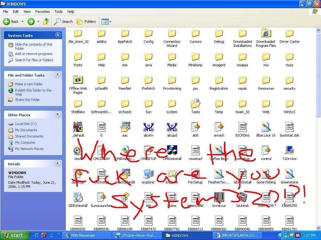

    San jose, CA
    2,104
    its not there either see
    Sorry the pics are really big >.>

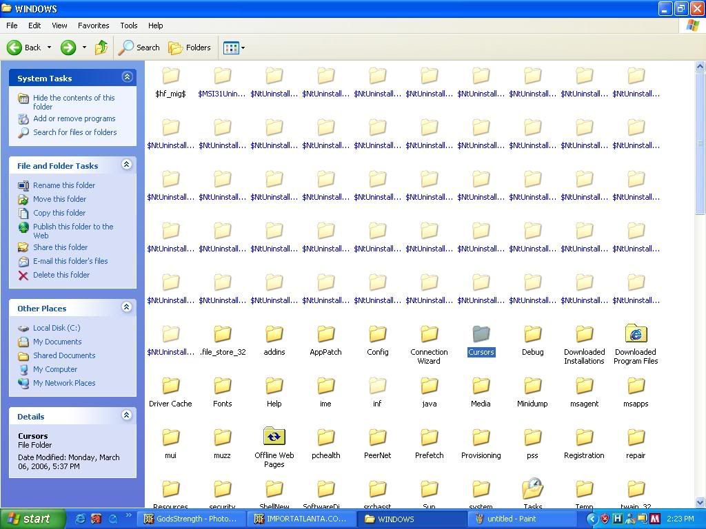

    I fucking fixed this shit. i had a virus that was hiding itself inside the folder and it hid the folder so i couldnt delete it. but i got that mother fucker. well thanks for everyones advice too i guess =D

    I ran a antivirus program called e Trust EZ antivirus and it found the virus and deleted it. or you can try this
    Click Start
    Click Run
    Type in the run box CMD
    click ok
    At the prompt type attrib -a -h -r -s c:\windows\system32
    Press the Enter key
