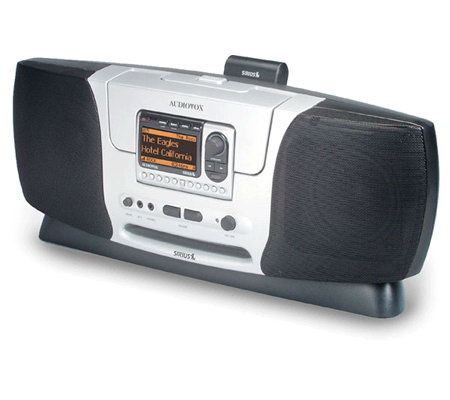

    well I was sitting here thinking what might be a fun car project for me to do since im selling my neon next yr and whatever I do I want to be able to transfer everything over to the new car. Then it hit me. Carputer! SO I was doing some research and I know I could build my own computer and use that or just find an old used one... But ill problly end up building my own because I enjoy doing that... anyway would something like this work on a regular cpu video card: (see pic below) and could I just hook it up to a power strip connected to a ac/dc power adapter connected to cigarette lighter (cause I want to be able to have connectors for other things too) or would having a bunch of things connected to it cause car damage? also how would I install pc speakers inside a car? and how would I get internet access on it if I wanted too? basically I want to use this to run a map program on cd rom, store all of my car repairs, etc on ms word, maybe 1 or 2 other things.
    Attached Thumbnails Attached Thumbnails -700ts_web_-_front_-_large-jpg

    my ? is , why put pc speakers in your CAR anyway?? unless you have a
    in your car and pc speakeers would be an upgrade ....

    One of the problems you'll run into is using a desktop computer harddrive, they don't really think too kindly of being abused...bumps, temperature changes, etc...Probably be best to find a parts laptop with a trashed LCD and work from there.
    You would need a video-out on the graphics card (composite, s, or whatever the screen has inputs for). As for power you might as well hardwire it into an inverter...using relays, fuses, etc. You don't want to have wires/cables running all around inside your car...having to worry about accidently bumping and unplugging something, etc.
    For sound you could easily wire it up to a pair of tweeters on the pillars or doors but wouldn't you just want to run it through the stereo so you can play MP3's and movies on the "carputer"...just a simple FM modulator would do the trick.
