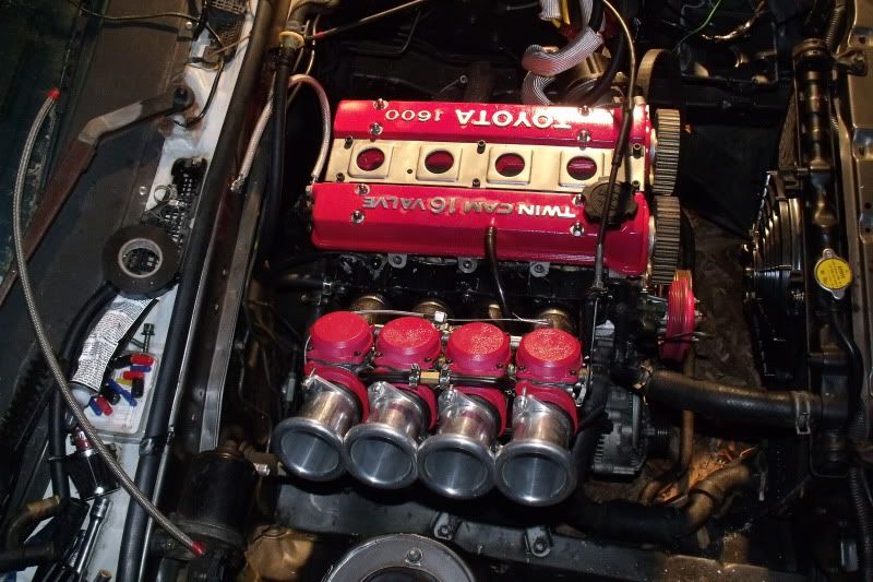

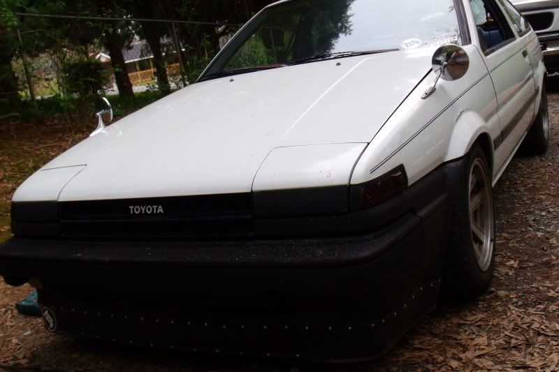

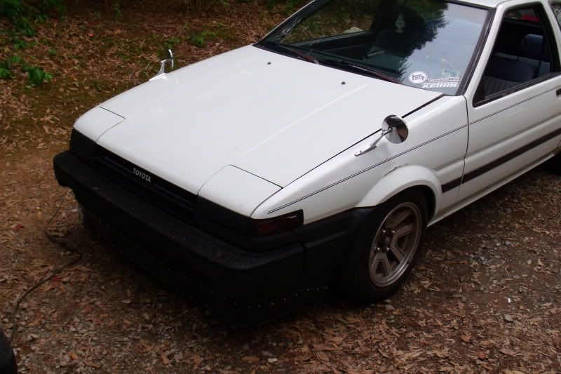

    some of you were probably at southrnfresh at garage zero and seen it , but those that didnt.....
    currently getting ae101 4agze swapped, laymens terms: 1.6l 4ag supercharged w/ 10 lbs. of boost, DLI, and factory forged internals.
    some of you may know this car from the 3 previous owners.....now its mine , and time for a revamp. this an 84' hatch srgt-s meaning was an sr-5, converted to gt-s lsd rearend, and disc. also has gt-s sway bars. big plans to come, im currently working on it , wire tuck, wheels , and moar low. different carbs , worked head, etc.
    old pics

    ive always wanted one of these.. those ITB's probably sound sick. Lookin good man.
    Certified Gearhead shubert's Avatar
    jasper/canton
    366
    Quote Originally Posted by JBrakeS2K View Post
    they're ZX9R CARBS

    they're ZX9R CARBS
    NASTY. You should make a video. Id love to hear the sound clip.

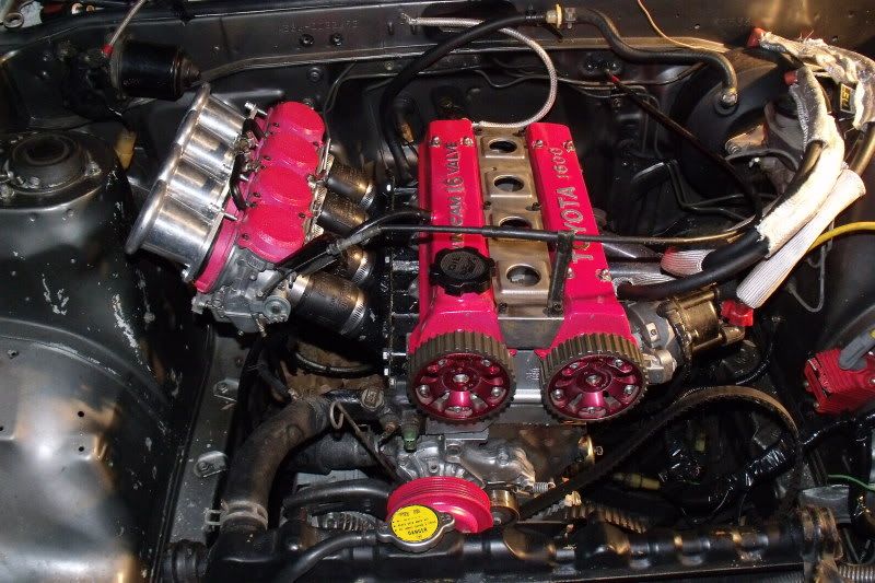

    heres my current coupe engine (4AGE) [EFI].... .054" milled head, ported intake decreased short radius, 5 angle valve job , 20 degree back cut, polished exhaust ports, valve shrouds in combustion chamber removed , combustion chambers polished, 264 intake cam, and 256 exhaust cam......this head will go on the carbbed engine when i swap the s/c into the coupe in the next few weeks.

    coupe is now gze swapped.....
    pics before start up in case it became a crispy fried coupe.....

    any internal work on the ze or just stock?
    what kinda power are you looking to make?

    Quote Originally Posted by allout13 View Post
    stock internals, 15 psi BLITZ pulley(stock is 10psi), ADJ. FPR, FMIC w/ 2" piping, modified ABV, 240* 7.6mm intake cam(OEM largeport), 232* 7.1mm exhaust cam(OEM smallport), adj. cam gears, 4-1 header , test pipe , 2" exhaust, and subaru wrx non-sti plugs. ill drive for a few weeks then ill be adding a small port N/A intake , remote 7MGTE 62mm throttle body(OEM is 50mm), 7MGTE 440cc injectors(OEM is 365cc), NST 16.5 psi pulley kit, remove ABV, greddy 2-bar MAP sensor and a greddy e-manage ultimate.
    looking to make about 230 whp/wtq by then.
