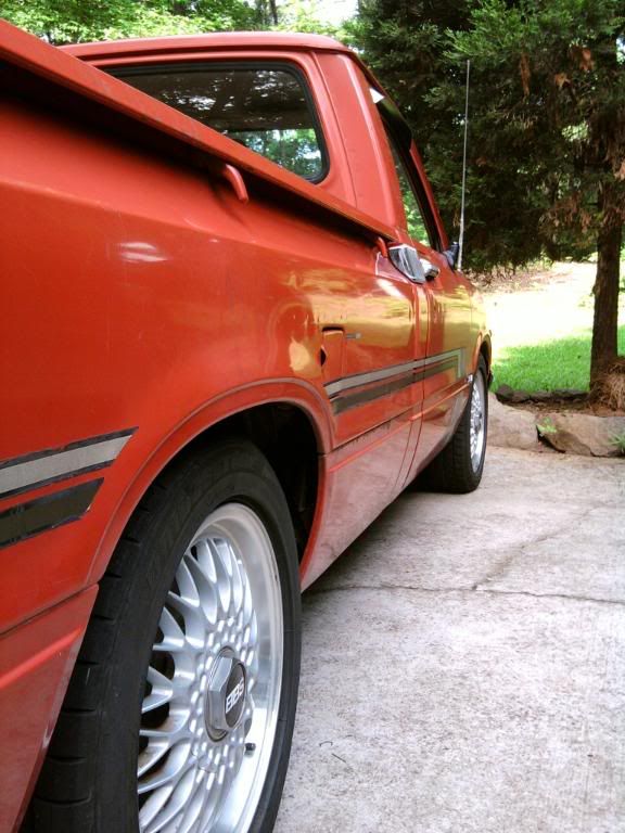

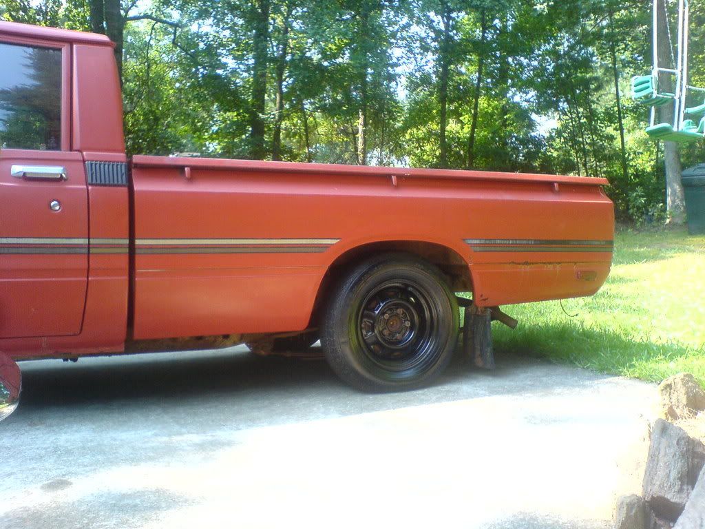

    First night it was home the rear got lowered 3 inches. Ignore the tires, they got painted with the wheel since they were getting replaced the next day.
    I cleaned it up and rode around like that for a while. I was just happy to have a clean-ish gas sipper for the time.
    Then i got the front down level with the rear
    Then i went a little lower
    New headlight buckets and corners
    Then the BBS's
    Trying to get a little closer to being flush
    New grill
    Buff and wax
    Then lowered the rear some more. Yes I know the fender is a shade off and it sits uneven now. I can't go any lower in the front without drop spindles which are coming this month.

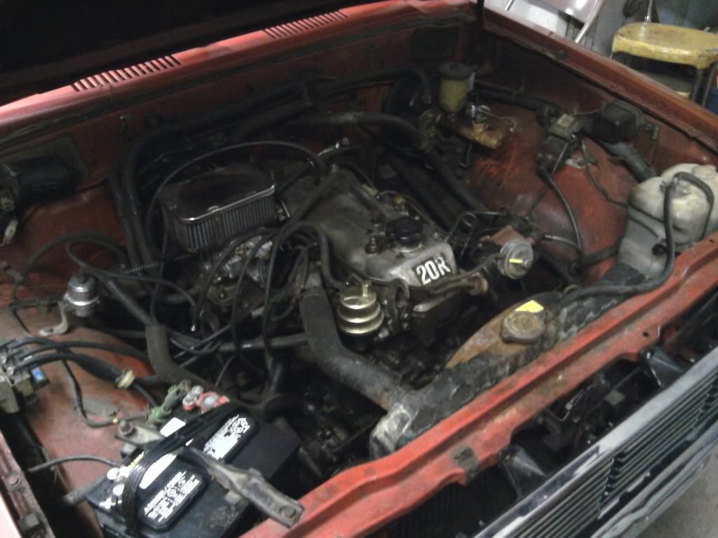

    So this is where i am as of yesterday. The motor crapped out on me on my way to the East side starbucks meet. (I blame it on the kaleidoscope doa sticker. Bad mojo lol) So I figured it was time start on my swap i've been talking about forever now. Throwing out the 20r in favor of a fresh 99 original mile 2rz. It was flipped two days after it was bought in 96. A family member gave it to me. I've never seen this swap done in a 80 so i'm going to give it a shot. I've got pretty much all my turbo stuff aside form the turbo. Mani is in the works and i'm using alot off of my 240. So here's the pics of the motor swap progress. Stay tuned for more updates later this week i'm sure.

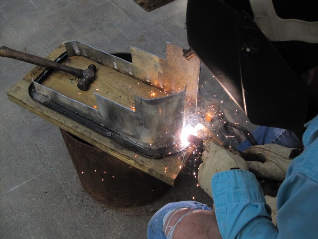

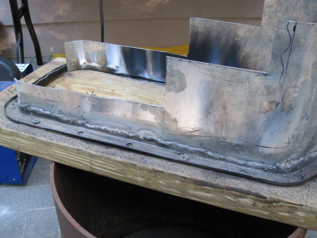

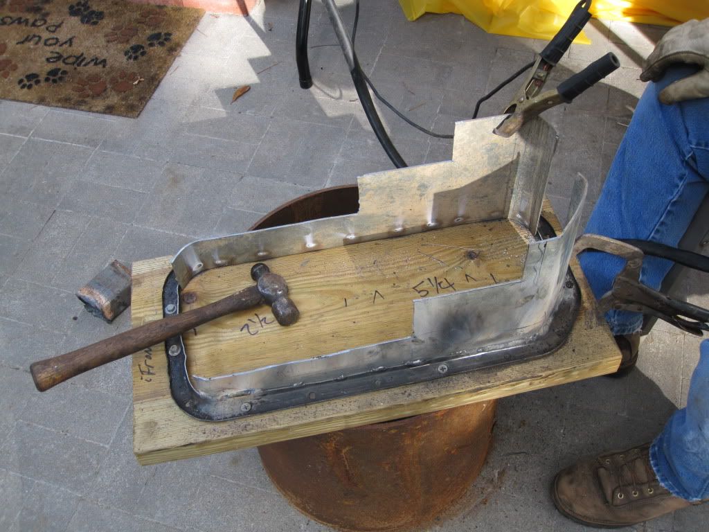

    Also started on the oil pan. I'm just sectioning the stock 20r pan and using the 2rz flange. Once I finish that up and mod the oil pickup I'll start on the wiring. Shouldn't be much longer now. I'm getting excited lol

    Started the oil pan

    Did some welding on the pan

    I haven't updated this in a while. This is all copy pasted from another forum...
    I know it's ugly right now but if it holds oil I dont give a damn
