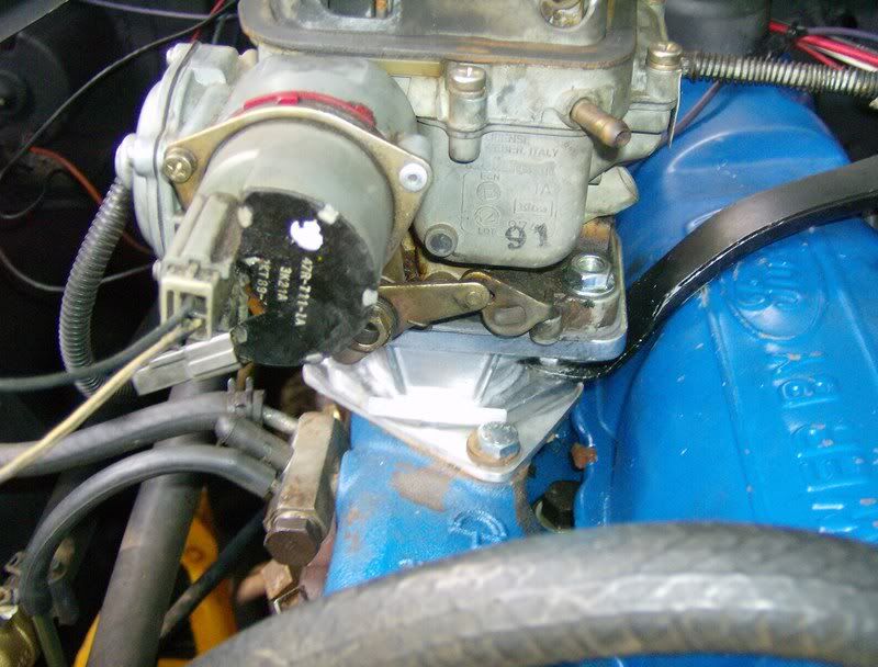

    As far as Webers go... you can get rebuildable clones from pull-a-part for like $12. By clones I mean the Holley 5200 and Carter-Motorcraft versions built under license for domestics.
    I snagged a Carter-Motorcraft carb from an Escort for the 2v conversion on my Falcon. Pretty much the same thing as a DGV, and you can see where it says "license from Weber, Italy" on the front of the fuel bowl.
    It ran well on it, the electric choke was great and I liked the shut-off solenoid. But the threads on the jets were screwed up (they had been staked for some reason ) so I ended up scrapping it and going back to 1v.
    I think this one was 32/34, but there were some other cars (Pinto; Vega?) that came with the 32/36.
