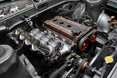

    There is alot of talk about useing bike carbs on cars instead of webbers solex and other type carbs.What will have a better respound

    You can use bike carbs just like ppl use bike ITB's for custom setups. I am running bike carbs on my 4age in my 86 Corolla. You can find different size jets and rebuild parts online for most bike carbs. Doing the calculations and finding out exactly what size you need for your application is probably the hardest part, and tuning them. I'm sure that an actual kit made for a certain application would flow slightly better than a custom kit made from bike carbs, so response would most likely be better. It is not as easy as it looks though. You can't just slap any set of bike carbs on any engine you want. You have to determine what size throats you need first, then determine the jetting, pick what length you want your runners to be, what grit you want to finish the inside of the runners with, what fuel pressure you will need to run etc. Most bike carbs are also gravity fed gas, which isn't really feasible on most cars. A small electric inline pump with a regulator and gauge set at about 2-5 psi is usually fine though. But, you can save alot of money if you do alot of research.

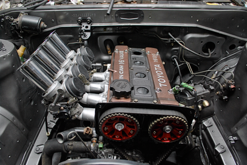

    Yep well i just got two 4age for free one looks in very good conditions.
    What carbs will be good for a 4age

    ae92 itbs

    itbs came on the ae101 and ae111 20v 4ag and are not carbs, webers would be a good choice though

    Ok, this might be a retarded question, but looking at the pics the OP posted, I don't think any of those are bike carbs. It looks to me like they are all throttle bodies since it appears as though the fuel delivery is divorced from the air metering. I haven't ever seen a carb that didn't have jet that weren't in the throats.
    I'd also agree with a lot of what SiRed94 said above, and add that using a bike carb is also liekly to be much less expensive than a comparable side draft or multiple throat down draft carb setup. For example, the last time I checked a triple Weber 40DCOE setup for something like an early Z was a $1200+ expense. A bike carb setup capable of flowing the same air and fuel should cost much, much less.
