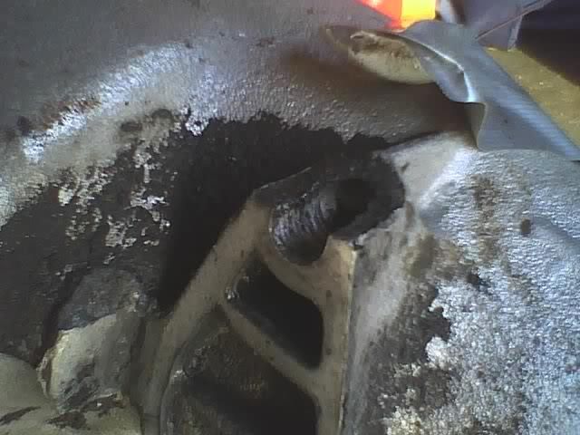

    Before:
    Both transmission mount bolt holes were like this.

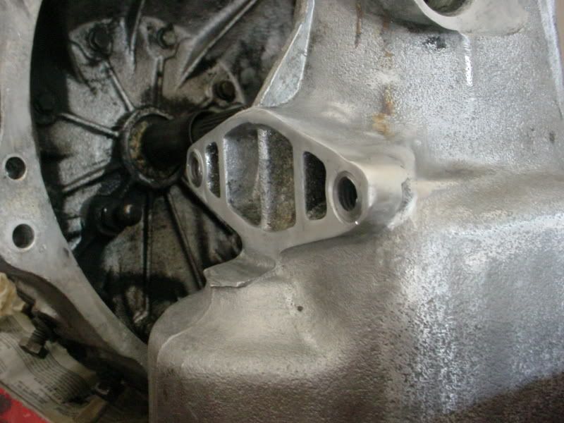

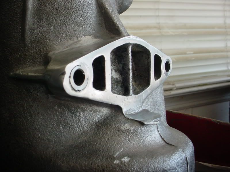

    After:
    Had the welding instructor at my school do the welding, but I did all the machine work myself. Now has keenserts, should be a bit stronger.
    Keensert (for those not familiar):
