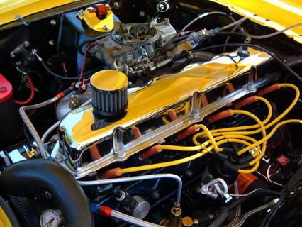

    Default From the Ford forums... '68 Ford Mustang with 300 inline 6
    300 inline 6
    11:1 compression
    big solid lifter cam, roller rockers
    750 Holley
    nitrous
    Top Loader 4 speed
    For those of you who don't know, the 300 inline 6 was a truck-only engine. It is the "big block" of inline sixes. Passenger cars got the "small block" 144/170/200/250 engines that were completely un-related. A stock 300 inline 6 makes a hair more torque than a stock 302 V8 but it's horsepower is severely limited by the 1 barrel carb and economy-minded cam pattern. This one doesn't have a 1 barrel carb, or a crappy cam obviously. Note how close the back of the engine is to the firewall. Its also so close in the front that a mechanical fan could not be used

    Nice to see something different.

    sick!

    Very nice. Good find.
    And a 68...the best looking year of all the classics. Thats why I have one
