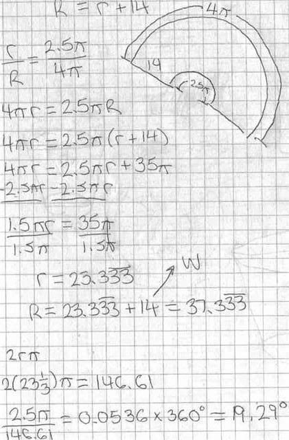

    Im getting r=23.333333 R=37.333333
    inner circle is 19.29 degrees
    according to the page: the outside radius R is simply w more than the inside radius r so the answer you got appears to be way off.

    Im getting r=23.333333 R=37.333333 Im not sure how accurate this is, but I'll rework it
    *EDIT** I guess I quoted you as you edited your post, LOL
    Those numbers look right, actually!
    __________________________________________________ __________________________________________________
    Roll a piece of paper into a cone, cut the ends off so they sit flat when it's set down on a table or something. Cut the cone down the length of the "height", so that it unfolds like the diagrams on the length. I think you'll understand it a little better.
    The radii of the two diameters created, won't be the radii used if you were making two seperate cylinders that didn't taper.
    The two radii will be a number bigger than any measurement given, as the length isn't short compared to the taper. If that makes sense.

    here's my work
    19,743
    That all looks great. I'll check it out when I get a chance to lay it out on a poster board. Better than the numbers I kept getting
    Thanks man!

    19,743
    The answer you gave worked perfectly! Thanks again, bro.
