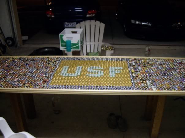

    It all started Freshman year of college, maybe two weeks into the first semester. Most of my 7 roommates (yea, it was crowded.) had gone home for the weekend or were asleep already. My buddies Dan, Anthony, and I had bought some beer and were shootin the **** in our dorm room when the idea was born. We decided we should build something out of beer caps. Sure, college people (including us) are usually unrefined in our decorative tastes and often decorate with alcohol bottles, but we wanted something a bit more complex. We settled on building a beer pong table, the top would be covered in caps and have USF (our school) in the school colors in the center. We did some math and found out that we needed, a TON of caps to cover our planned 8' by 2.5' table. About 2500 to be exact. Also, just setting caps on a table and gluing them down didn't seem very exciting, so we decided it would have raised edges and bar epoxy would cover the caps, leaving a smooth surface to play on and keeping moisture from rotting anything.
    Fast forward two years of drinking and collecting caps. Big shout out to all of those that joined in and saved caps for us! On Friday, I had yet again, another ****ty day. My much anticipated and looked forward too, trip to Atlanta fell apart and I pretty much felt like ****. I had to do something to get me out of the house and keep me busy so my roommate and I headed to home depot to start the build. Here's our progress so far.
    Materials needed:
    **** ton of beer bottle caps
    Bar Epoxy (2 liters cost about $40 and didn't even cover 1/3 of the table)
    8' x 2.5' 3/4 Particle Board (nice and sturdy works great with the epoxy)
    21' of moulding, we chose some that had a small notch on the back to hold onto the table better
    Liquid Nails
    Clamps/Straps to hold wood while drying
    The cool guy at Home Depot that will cut all the wood for you
    Pictures!

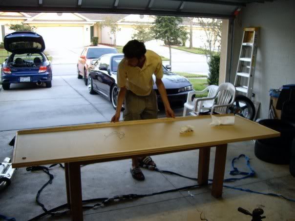

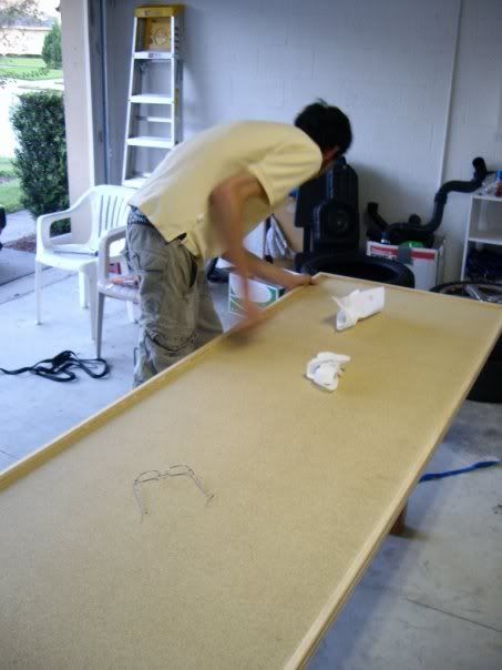

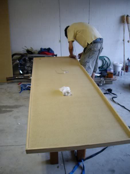

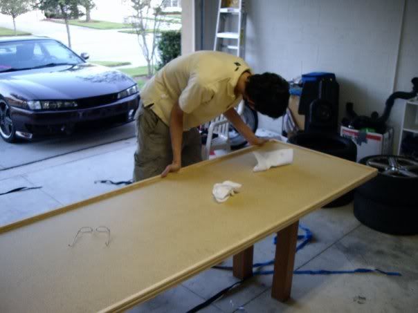

    Putting one of the sides on

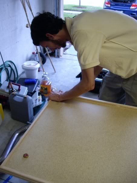

    Checking the corners and making them line up. We had to get notches cut in the molding since the saw at Homie Depot doesn't cut at angles.

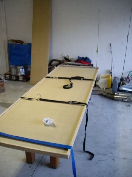

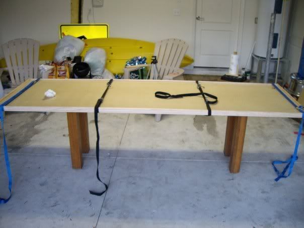

    All strapped up letting the glue dry. Its still hot as hell down here so it didn't take long.

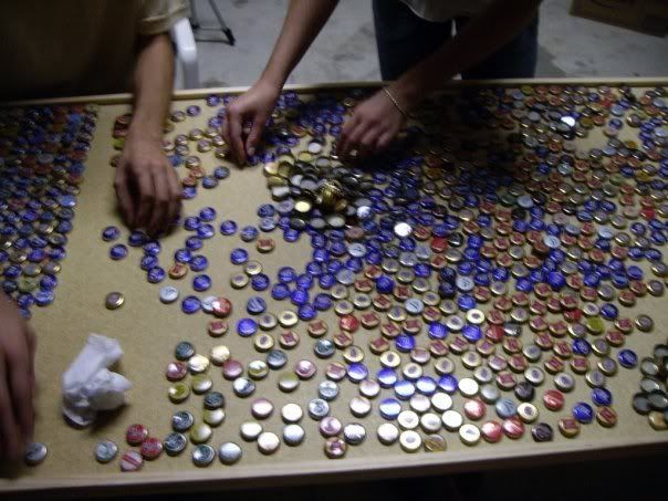

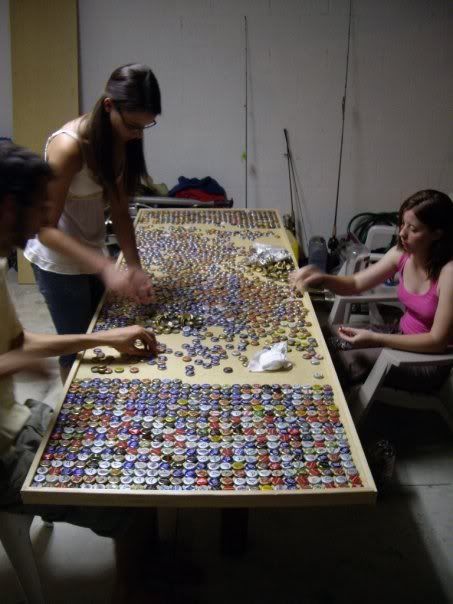

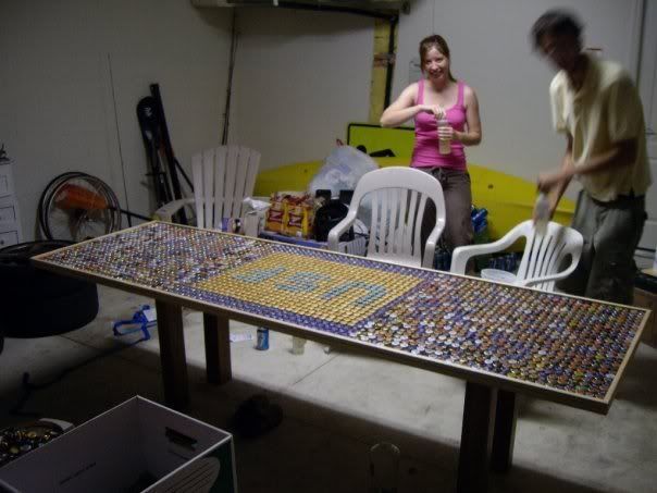

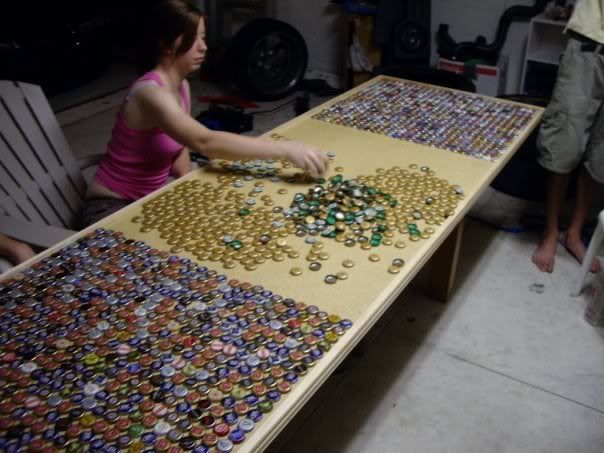

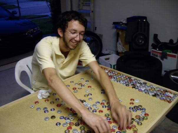

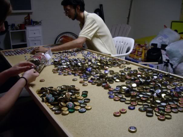

    Our friend's came over to help lay out all the caps. Real tedious work, this part took a while. Here's some of that:
    Big Pile O' Caps

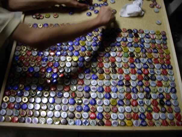

    Getting some sorted and lined out

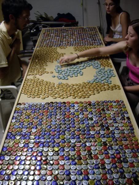

    Making Progress !!!!
    Everybody working hard
    Close up of one side

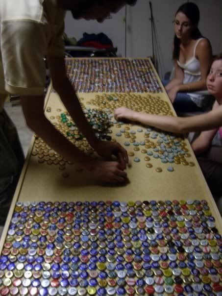

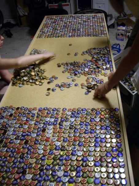

    Making room to form the center piece

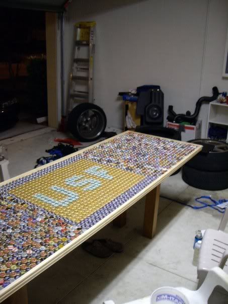

    Center piece sorting, etc. All the green caps for the center are Heiniken, the gold ones are Yuengling.
    Where it's at now. We still need A LOT more resin so we need to find someplace to get it in bulk because its not cheap. The caps that are covered by resin already look insanely good though. The epoxy really accentuates their colors and ****.
    Anyway so thats where we're at now. We're trying to get it done for my roommate and I's 21st birthday party this Saturday so hopefully I'll get some finished and action shots soon.

    It's actually really wide in person. You have plenty of room for empty cups and stuff, doesn't feel cramped at all. We chose this width so that it will be easier to bring with us to Football games to tail gate.
    Also I didn't read your dissertation on the table but what are you covering it with? I hear plexi makes it hard to bounce(of course everyone says bitches bounce) but either way I'm curious.
    We're coving it with bar epoxy. Plexiglass will eventually leak around the edges and the wood could rot or the caps could rust. This way the caps look better, wont move, and it won't leak.

    Yea we spent a lot of money on beer, and only bought bottles, for a long time. I can't tell you how many of these were smuggled into our dorms in backpacks after being bought from places that didn't card. We all wanted the table and always kept track of the caps and now we have this. Feels nice for something to work out the way it was planned. There's a lot of history in this thing and its not even done yet. lol.

    We built ours about 2 1/2 years ago using caps.
    We used plexi to cover it and kind of regret it now, the caulking around the side did leak and the caps started moving around when we moved a few times, but we popped top off and fixed it then resealed it. Still leaks a bit but just leaks out onto the floor.
