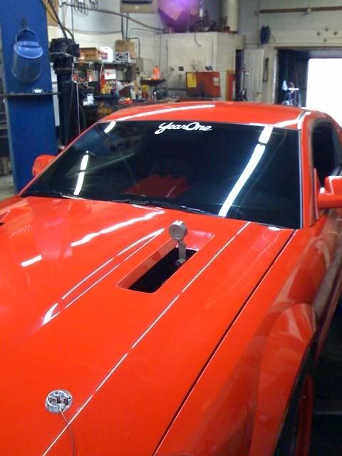

    well...i got it running yesterday YAY. I had to go home early to let the dogs out. So I was all the way up near jimmy carter and everything was doing fine. BOOM. Oil pressure went to Zero. FAWK. Got a tow truck and towed it back to the shop....I fired the car and the oil pressure went back to normal...so wtf. Hopefully its just a sensor...we will find out today.
    The Carbon Fibered R6
    i'm a got dang wallaby!!
    21,322
    GOT DANG IT ANT! man i hope its just a sensor! good luck man keep us posted!
    shoulda bought a chevy lol
    JDM TYTE AnthonyF's Avatar
    Cumming
    24,318
    62
    the pick up screen was clogged...fawk. So i installed a new one. Will be on the ground tomorrow...heres a funny pic so I can get real live oil pressure while driving up the street...

    cant wait to hear teh results....lol @ the new 'antenna' coming out of the engine compartment
    Cumming
    24,318
    62
    ^oil pressure gauge biatch. looks pretty cool. lol. i just took it out
