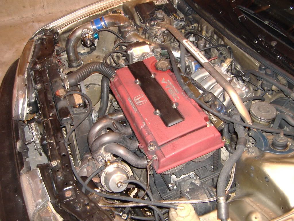

    since i have a new manifold coming in (http://jhpusa.com/store/pc/viewPrd.a...&idproduct=612) couldnt i pull my old one and possibly get it welded back up and sold? heres a pic. it has a crack where runners #2 and #3 meets the block flange and a crack where all 4 runners meet at the turbo flange.

    Since you are going from that to a log you will probably have to rework, downpipe, oil lines etc... and noone is going to buy that manifold, they are drunk.

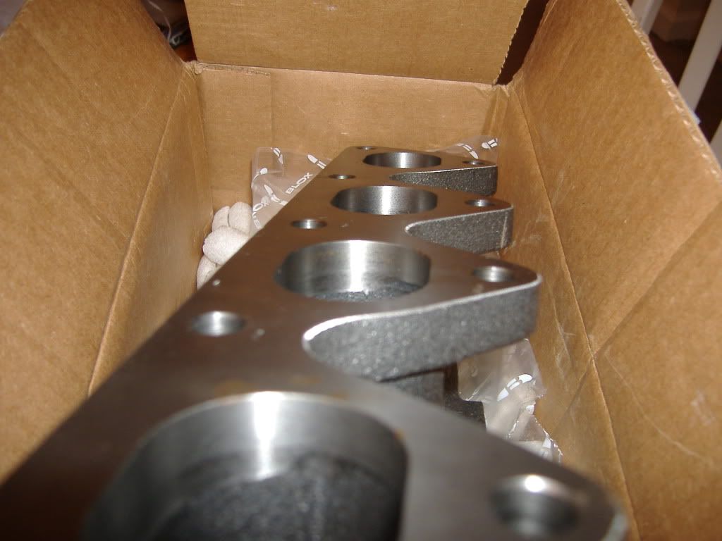

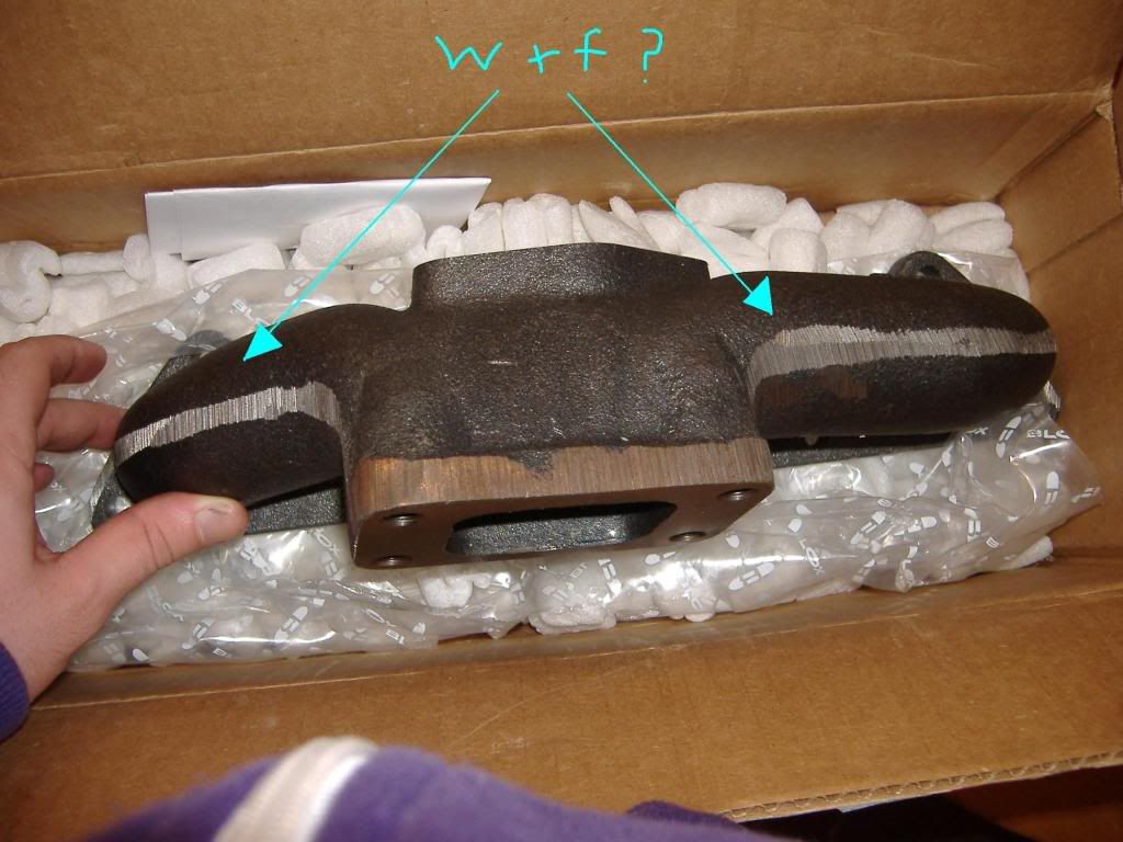

    sooo.. christmas came and went. heres my result ill be trying to get my car up there as soon as i get the rest of my $....oh and will this use just an oem honda gasket or something, cause it didnt come with one??
    DA SQUAD MEMBER #70
    91 da/95 gsr/boosted/awaits tune....
    Mar 2004
    1,939
    stock exhaust gasket will be fine. grounding marks is where they took off the sharp edges of the casting.
    don't need a gasket on the wastegate if you don't have one...you do need to make sure you have the fire ring installed.
