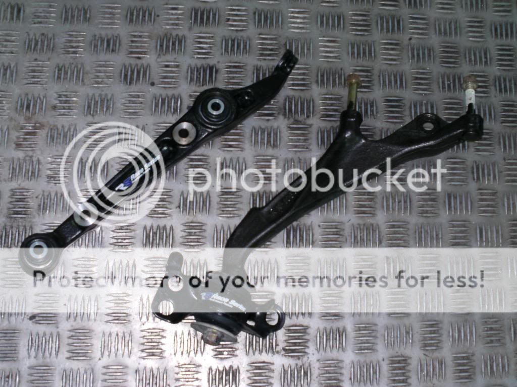

    I've fixed this issue before.
    It ended up being that the "Compliance Arm" was bent. Its usually sold as 1 pc with the lower control arm.
    Your best bet is to just get an entire LCA from a junk yard. Fortunately its probably the same on all DC Integra. After you replace it, make sure to get the car aligned!
    Its the piece on the right in this pic:

    generally yes. may as well grab the compliance bushing too as they are prone to wearing out.
    Usually comes like this:

    they are attached. Just pull the LCA and the "compliance arm" bolts are back where the sway bar bolts in.

    Pic isn't working through the Tapatalk App but however works on the Standard Website! Thanks for the upload & that's all I need correct?
